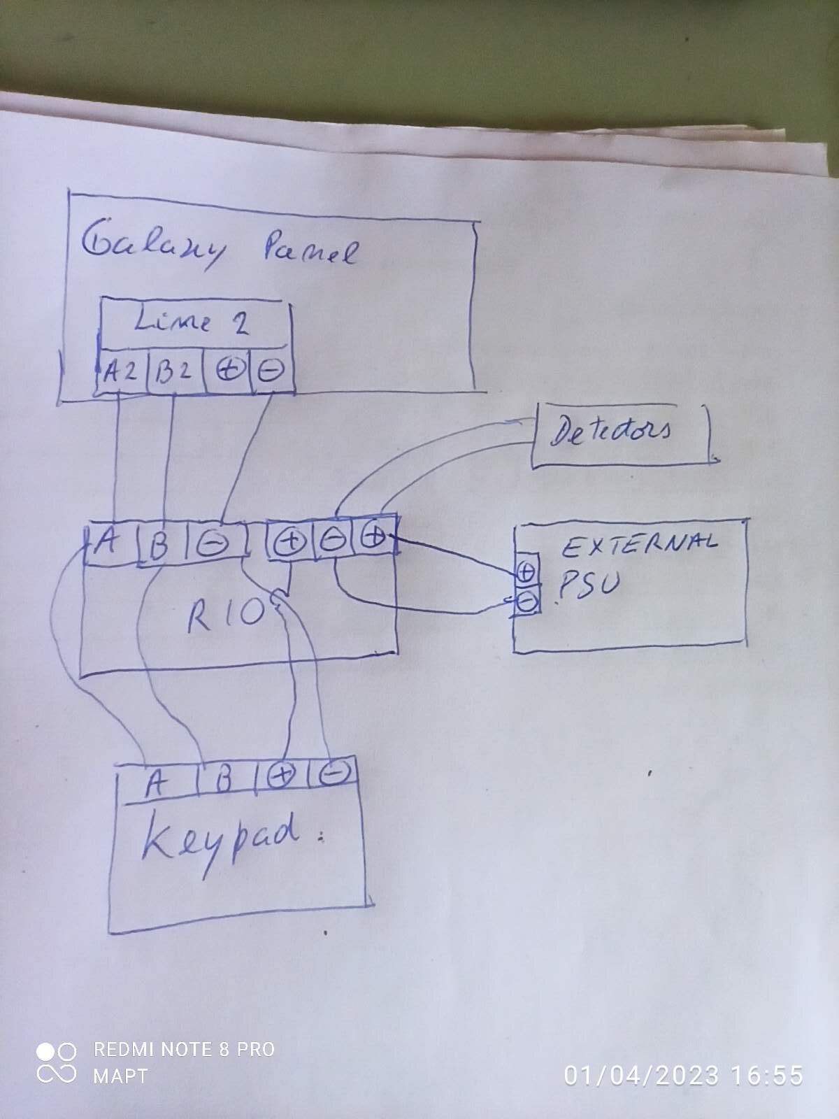

Can you double-check that you only have A+B and 0V connected to your power RIO? You should not connect panel +12V to power RIO +12V as that will cause all sorts of power problems.

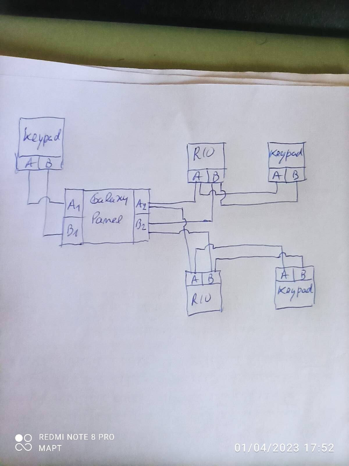

I believe I have it right (first attached diagram).
I do not have the 0V of the External PSU directly connected to the 0V of the panel, only via the RIOs.
1) But that is the same, right?
The layout of my system is in the second attached diagram.
I do not have 680 Ohm EOL resistors in the end of the lines (keypads) because the lines are maximum around 30 m long, but I have removed Link LK5 (page 2-8 of the Manual).
2) Does this look OK?

Yes, but this seems to be a power issue. On your diagram you show a separate power supply. Is that a power RIO ? To debug this, you can try disconnecting the power RIO and leave the panel separate.
It is a Elmdene Power Supply, for the two offboard RIOs that I have, an external sounder and a landline voice communicator.
The voltages on those RIOs (Option 61 - Diagnostics) were a bit higher (RIO 2 = 13,96V; RIO 3 = 13,80V) than the voltages on the onboard RIOs 0 and 1, which had voltages of 13,76V, but it seems to me that is not a problematic difference.
I didn't shut down the Elmdene Power Supply because it also supplies an external sounder. But I disconnected RIO 3 from the pannel and changed the power supply for RIO 2 to Line 2 of the pannel. So now I have RIO 2 directly connected to the pannel, independent of the external PSU (Voltages now are RIO 0 = RIO 1 = 13,71V; RIO 2 = 13,72V).
I did this because there are more zones with higher resistances in RIO 2 and 3. The problem persists. One of the zones in RIO 2 already had a 1157 Ohm resistance after I changed things.
I can exclude the Elmdene PSU as the source of the problem this way, right?
