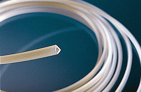

We need to intall something at work, and rather than using 100x100 PVC Trunking, I'd rather use 100x100 Galv trunking so that it matches the existing stuff, However I need to cut an opening in it for cables (Telephony / Data) around 550mm long however I dont want the edges getting damaged.
What are the options? Sticky tape around the cut, isnt too high on my list!
Are there any types of pvc / rubber edging stip I can buy, as opposed to some black tubing and a stanley knife blade.

you can get a plastic clip-on edging, it comes in rolls. The supplier of the trunking ought to have it.
rather than hack a jagged hole in it, couldn't you use a T-piece?
It's called grommet strip and it's available in a couple of sizes, make sure the size you get is for the gauge of metal work that you need it for
A blob of super glue helps to keep the strip in place if required :rolleyes:

What I'll probably do is holesaw each end and then jigsaw it out.. T&E would probably work well, but would look a little rough, even though it would be effective.. Ill get some of the grommet srip I think. - Either that or just stomach PVC..
