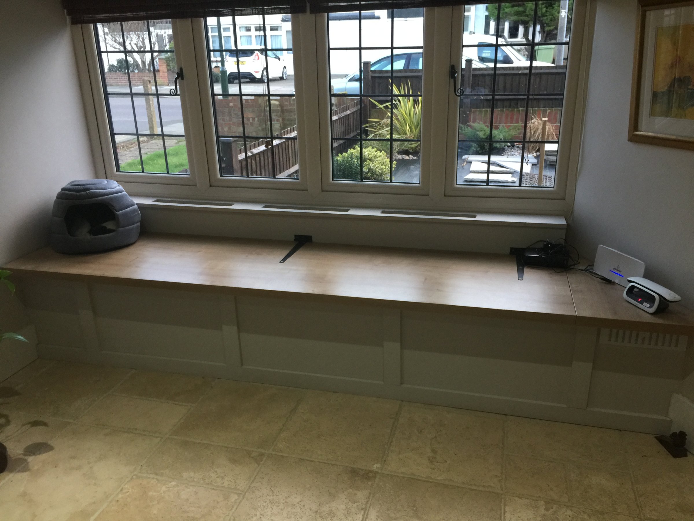

Do you have a pic of the install?

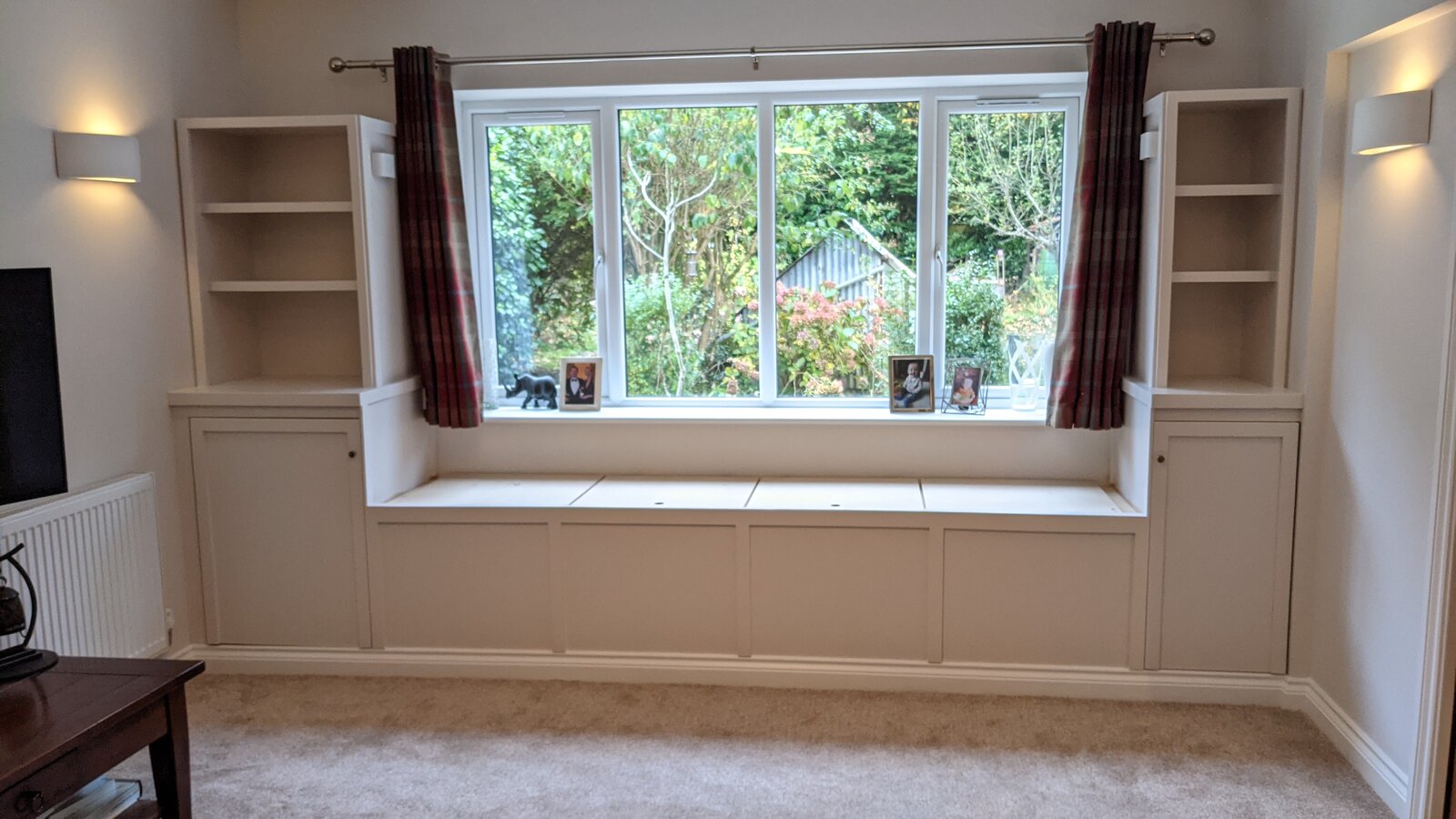

I made mine using studwork for the frame and boarded with 22mm MDF then panelled with softwood and all painted.
How are you supporting the lid? Mine rest on the studwork framing, hinged using basic butt hinges.

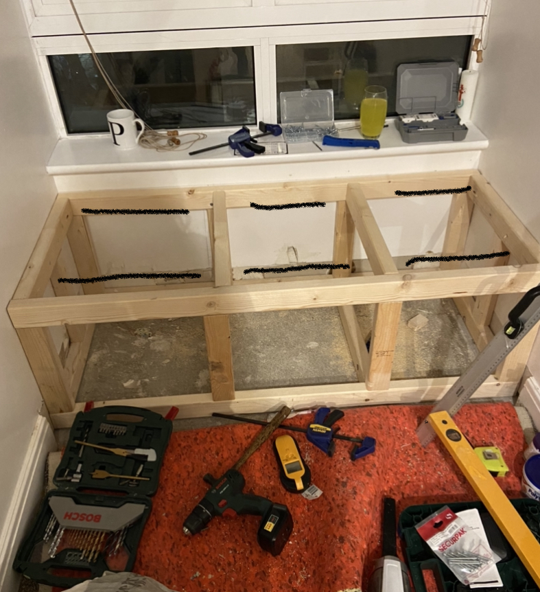

Thanks. Yes here’s a picture.
Have just been reading about pilot holes for plywood edging, so thanks for that.
I’m going to be putting some additional timber where the black lines are to support the door and pull the area where the lid will pull up away from under the window sill. So as you’ve done, the lid will be resting on the studs.
So did you screw into mdf edges for the hinges then?

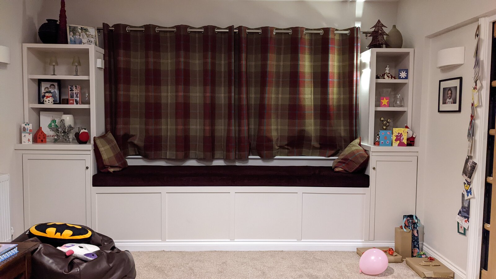

i used piano hinges on mine - we have 4 sections and i made 4 flaps with 4 piano hinge
I used a filler across the back , so that when the lid was lifted , it set back agains the windows
I looked into all sorts of stays , hydraulic etc ..... but ended up without those
It was a problem in the end grain , but i did manage to get longer screws and it seems to have worked ok , so far
half is a kids toybox , so when the grandchildren or freinds children are here , they do tend to use it a lot - and still OK, constructed , just as covid hit ..... so the MDF was a lot cheaper
Much the same framing as mine! Yes, just screwed into the MDF; the lid is fully supported so the hinge isn't taking any load. I also skipped the stays, sometimes it's annoying mostly it's fine. I also didn't have to be too 'pretty' about the top as I had a seat cushion made to cover it all.

So specifically with regards to BnQ cutting narrower pieces. Because I have the window sill above as said, I need to ensure that the hinge part is forward of that, so was going to have a measurement of 53mm x 1340mm stop and attaching to the frame. With some of the frame (black lines in photo) giving some support to the lid. Anyone know if that’s something BnQ could cut?
I may end up changing the configuration of the lid as I go though to whatever suits best. .
