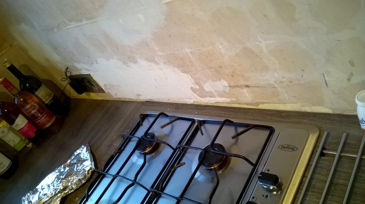

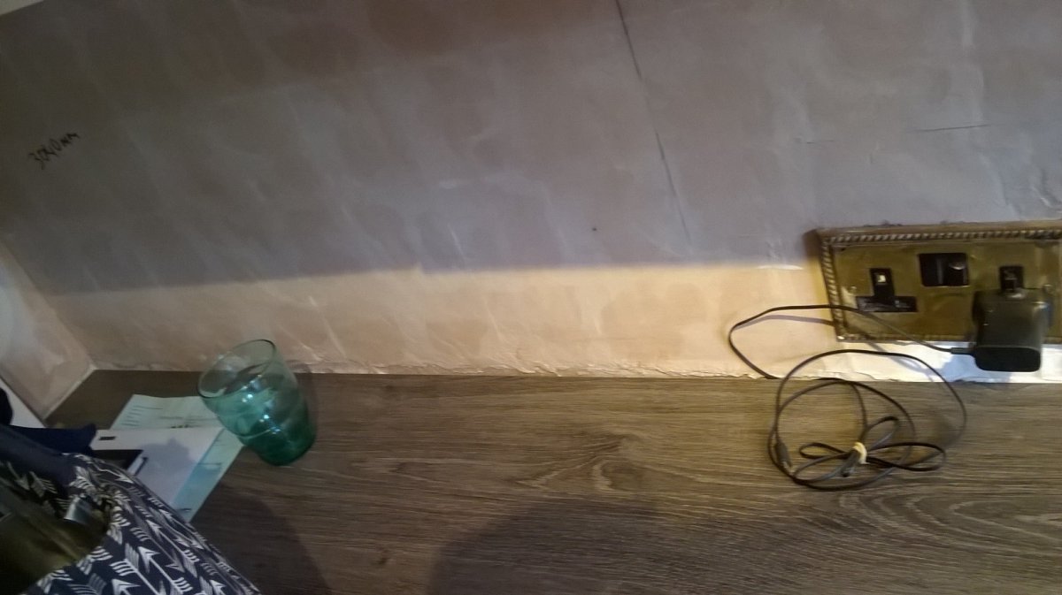

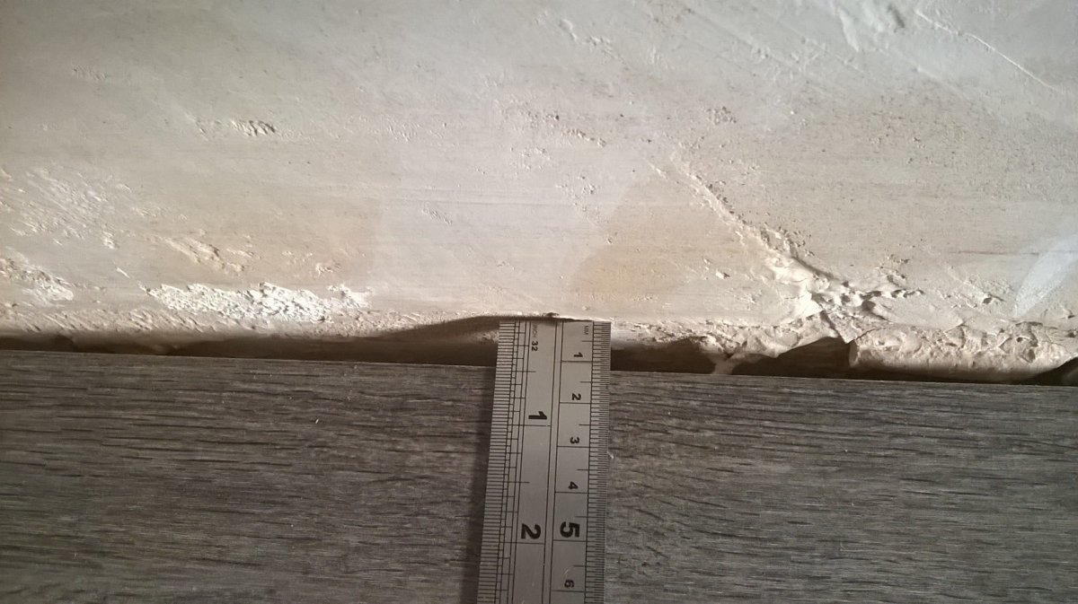

Hi All ,

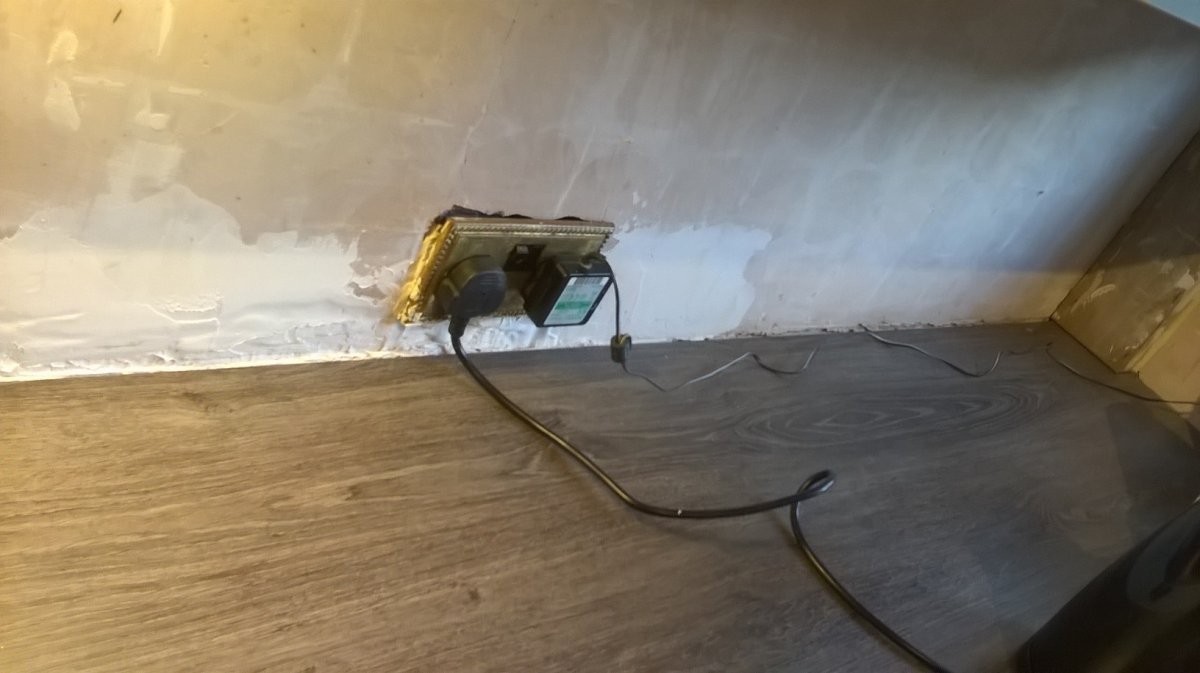

I am about to commence tiling my kitchen splashback , but have a query/concern regarding an aspect of the job.

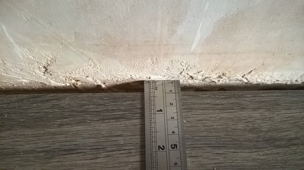

I recently fitted new worktops , but due to them being square edged I lost 16mm in depth across the top of the units .
This meant I wasn't able to scribe them to the wall the rear of the worktop doh!.
This has left me gaps in places which are over 10 mm and I am concerned about how to rectify this (see images).
Where do I start with the tiles ? , usually I would start in the centre of the wall but , this is where the worktop butts up against the wall and I am concerned that I will have to put the tile adhesive on so thickly at the gap points that it will slump.
I am also worried about getting my tile faces all level across the full run of the wall.
Am I better to try and fill in the recesses (with plaster / easifill )where the worktop has the widest gaps but still maintaining a flush level across the entire run of the wall ( I am crap at plastering !)
Lastly I was going to use 2 mm spacers between the worktop and the bottom course of tiles but the gap is going make this more complicated.
Any advice or guidance would be very gratefully recieved.
Many Thanks in advance for any help
Glenn

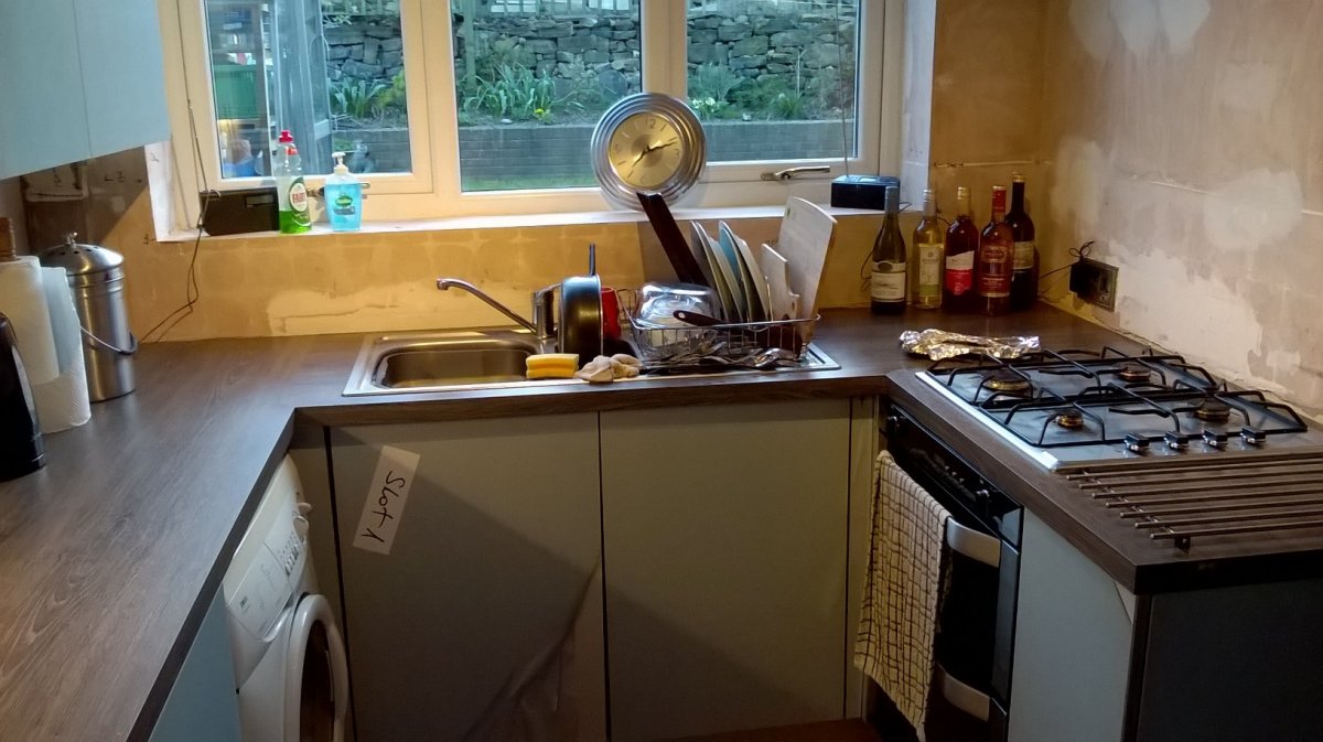

Vinn ; The kitchen is U shaped and the sink and hob are already installed. The worktop overhang at the front is very minimal <10 mm at the most. The back splash is from WT to the Wall units. The problem is only on the longest run on one side and isn't near the sink or hob.

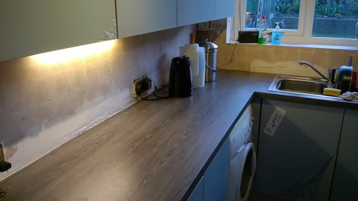

I had thought of using 9 mm hardwood ply and securely attaching it in multiple places with plugs and screws, I was going to pre treat it with a couple of coats of 5/1 pva. I didnt want to go to 12mm as I would lose worktop space in the flush areas. (is this a good idea ?)

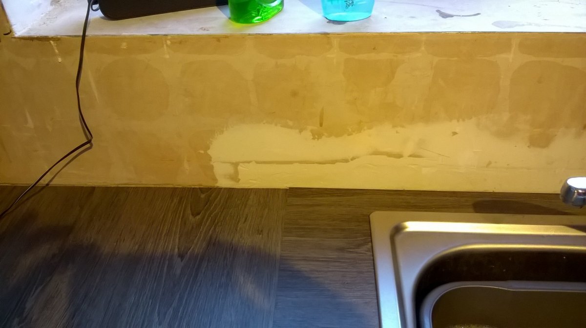

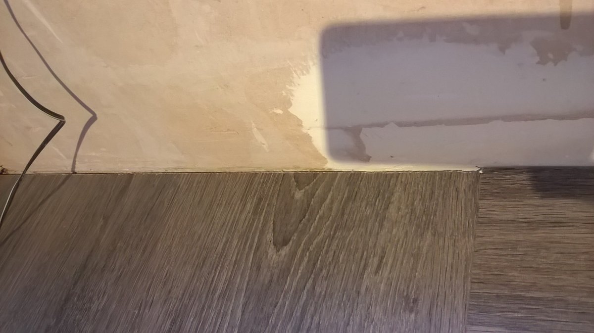

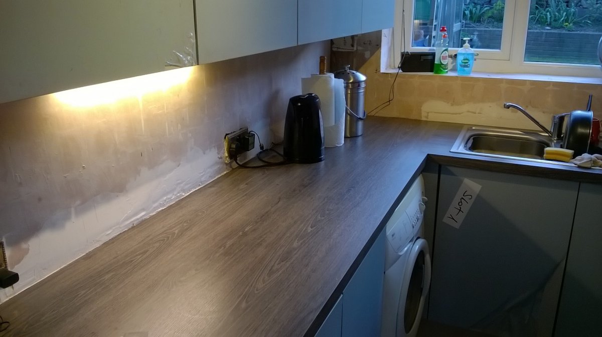

Post a picture please Glenn (of all walls) , and we can then comment further.
Hi Doggit , thanks for your fast response,
I was intending only to use the ply on the longest run without the hob or sink.
Sorry the pics aren't fantastic but my phone has no flash !
Many Thanks again
Glenn

You could fill the gaps at the back of the worktops which would then support your spacers, and then use a thicker bed of adhesive, but I suspect you may not get a good finish that way. You could well use the 9mm ply on the cupboard wall, but if there are gaps by the sink as well, then I'd be inclined to find a pasterer that will bring the wall out to the worktop.
Hi Doggit ,
Thanks for that , Think I will proceed with lining the cupboard wall section only,(the gaps are only a couple of mil on the other walls.

Sorry Glenn, which gaps are you refering to, but silicone would be fine, or even caulking; it'll shrink back over a couple of weeks, but it'll be fine to get you going. Use 3/1 pva, let it dry, and then tile, but having thought about it, (and as happy suggest) you could use 9.5mm plasterboard rather than ply, but gripfill might be better than plasterboard adhesive, as you don't want it coming out too far.
firstly don't tile onto ply and don't use PVA as a primer.
if the gap is 10mm how thick are your tiles. a bed of adhesive with a 6mm notched trowel and a tile will normally come out at about 9-10mm. cover any remaining gap with a bead of silicone
How about lengths of End Cap/ Corner joints ( these come in assorted colours Corner joints width size up to 10mm) inserted into the gap and resting on the work surface, then tile trim along the edge of the tiles
You could then seal the remaining gap with silicon prior to tiling.
