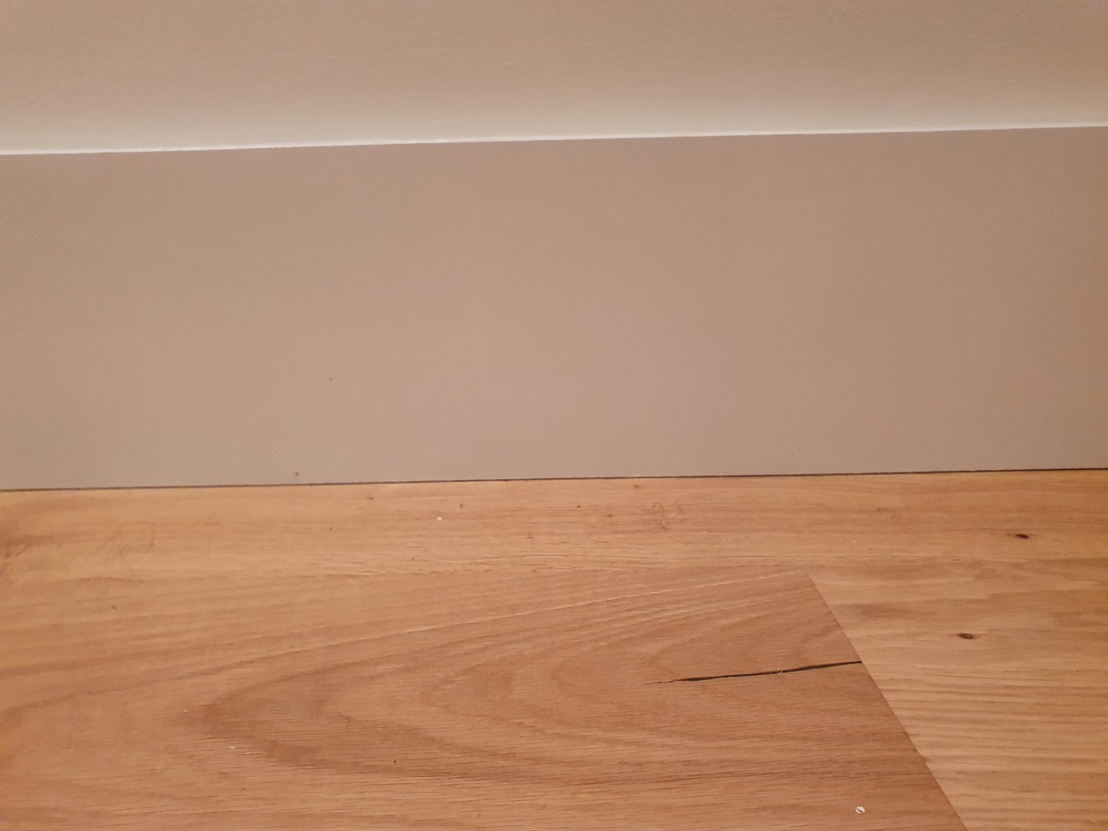

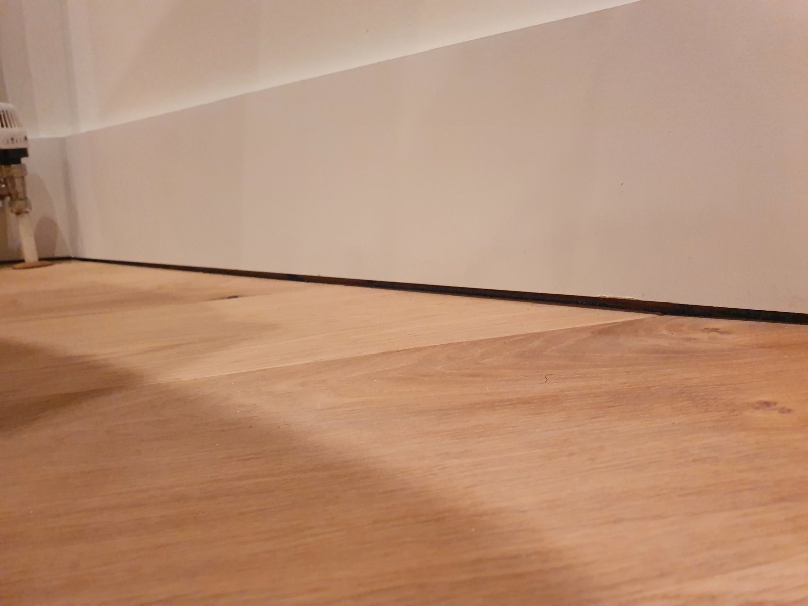

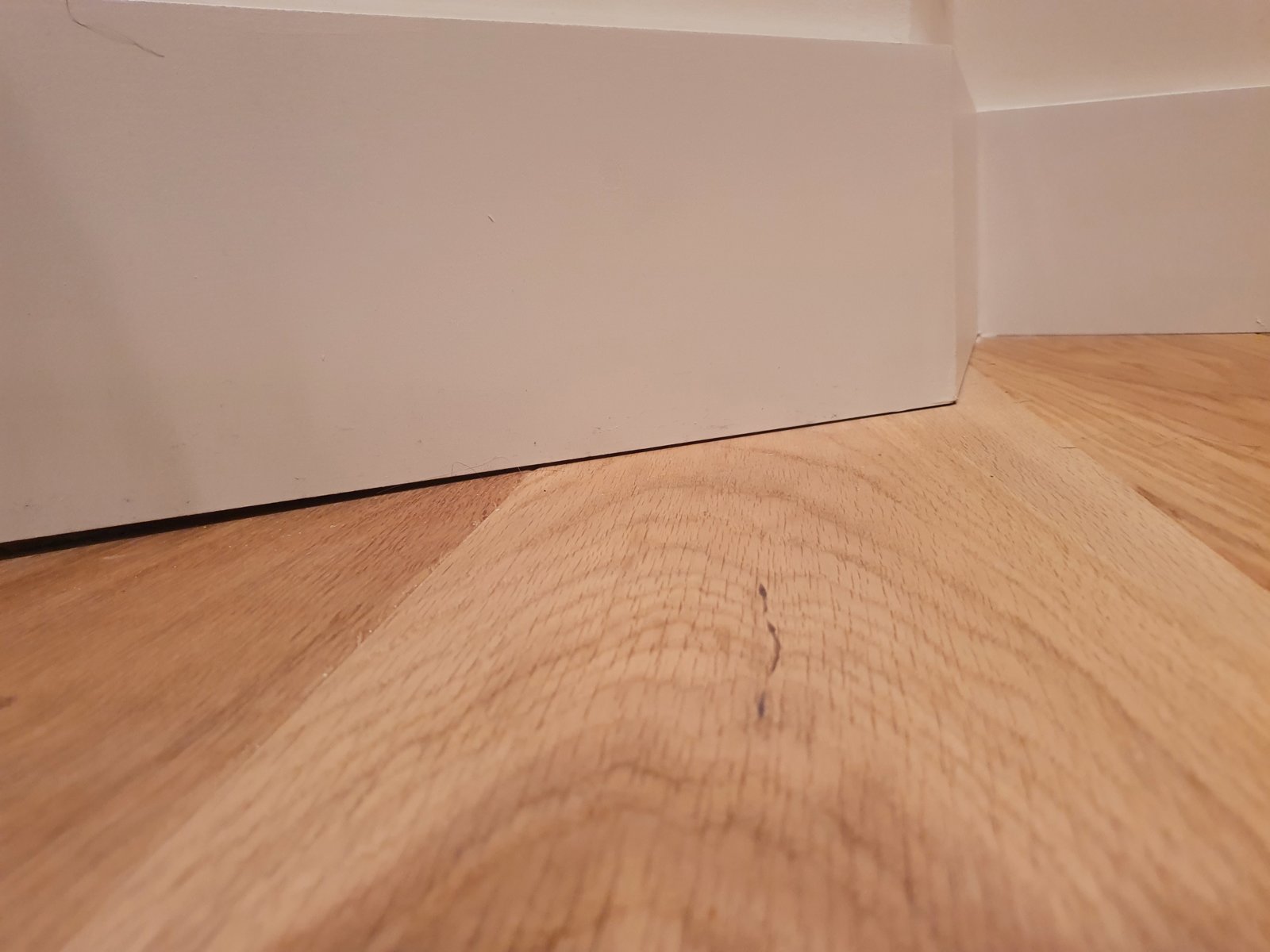

I've installed this new floor and used acoustic underlay (mutemat-3) and plywood below the wooden floor. The floorboards weren't changed and are quite old and crooked (in retrospect I should have changed them but wasn't guided to do so). Also, perimeter strip (a foamy strip) has been installed to hold the underlay and plywood together, so that raises the edges of the floor a little bit.
In certain parts of the flat there are gaps between the skirting and the floor, around 0.5cm maybe 1cm in other areas where heavy furniture are placed.
What do I do ? Put caulk in between?
I've put some pictures to show the normal floor as well.

Needs a flexible filler, such as silicon, not caulk, however the maximum I'd be happy with is 5mm. More gap than 2 or 3mm and I would probably have scribed to the floor (although TBH with a "wonky" floor I'd have smoothed things out first with either a layer of thin ply and/or some SLC before installing finished floor). I think the best and easiest thing you can do now is to install some quadrant moulding all round to cover the gaps
Thanks, I was reading about caulk and found out that it is indeed inflexible once it sets. I used mastic in some other areas to seal similar gaps, although not up and down, rather in between the skirting and floor (if you know what I mean).
I really wanted to stay away from beading, that's why I removed both skirtings and carpets when I did the floor, otherwise, I could have gotten away with just the carpet + beading.
The contractor I used said it would have been a very expensive job to raise the floorboards and level the floor, but I don't think he knew the implications of not doing so to let me know beforehand.
What if I stuffed it with mastic? I was thinking of giving it a try, but not sure about the end result.

TBH as a tradesman I would normally never exceed 5mm in a silicone bead simply becaude it always looks like a cover up for a cock-up. If you do need to exceed 5mm closed cell polythene "string" (for want of a better word) is available from decorator centres, etc to provide some backing support for the silicone bead. You'll probably also benefit from using silicone finger (Google "Kramer -Fugi") to get a good quality bead.
Did your contractor install the skirting? If not did he make you aware of how floor levelling could be achieved? Or failing that did anyone mention scribing the bottom edge of the skirting to the floor?

If you must, yes. As a chippie I'd be tempted to pull the skirtings off and scribe to the floor, but I recognise that if they or the wall are already painted that's probably a no-no. It can be handy to have a decent caulking gun (not just a cheap skeleton gun) to get a consistent size bead of silicone and you'll need some kitchen roll to wipe off your silicone fingers (to remove the excess silicone). If you do get it wrong, dig the stuff out before it sets and reseal. It can take s bit of practice to become proficient
