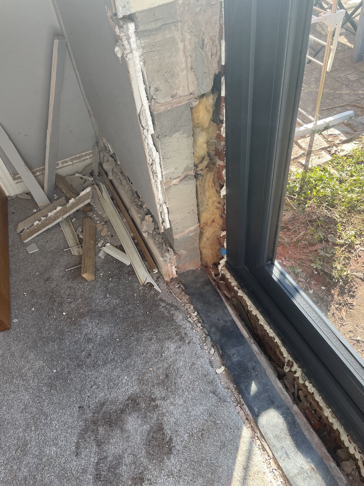

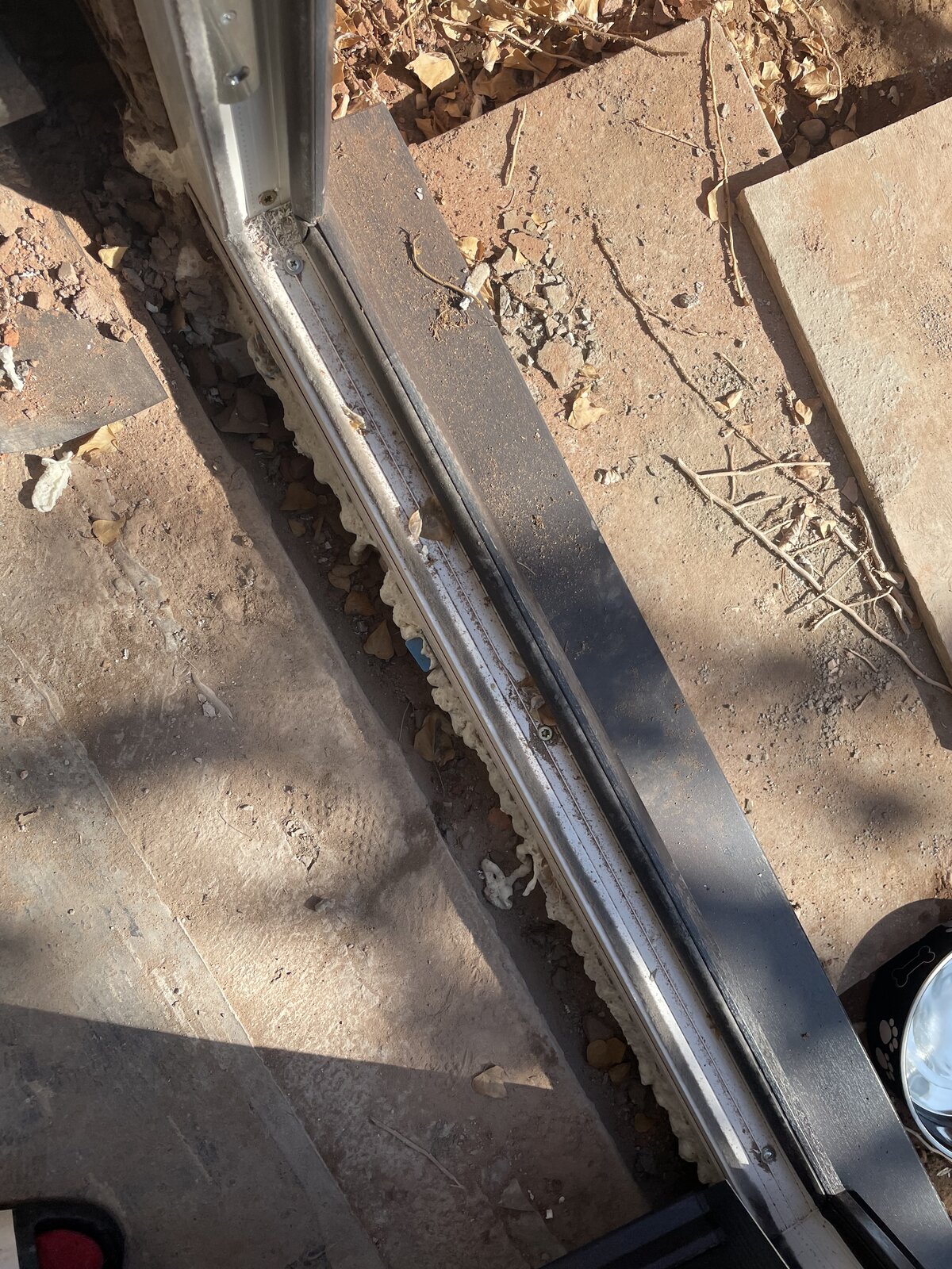

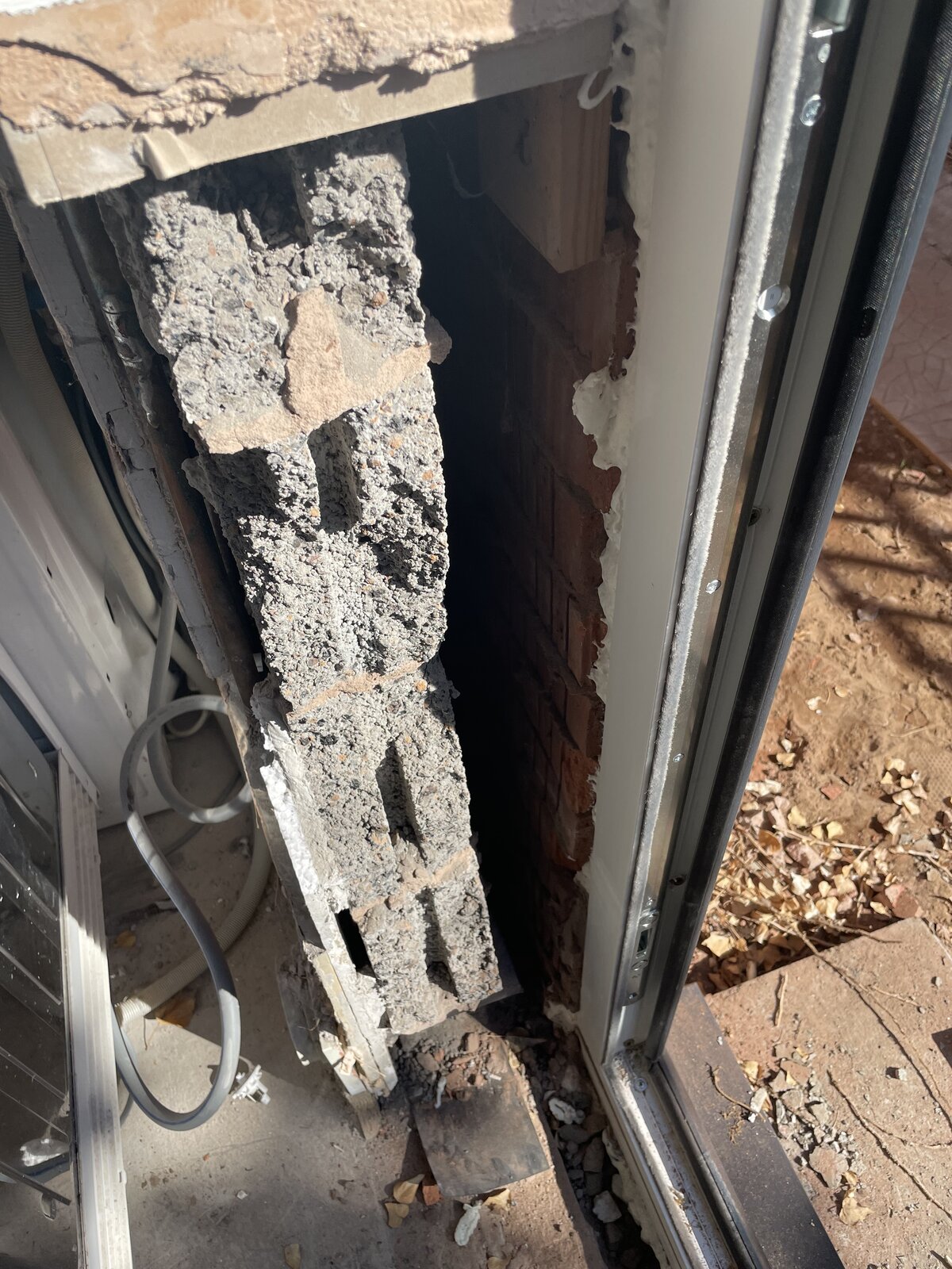

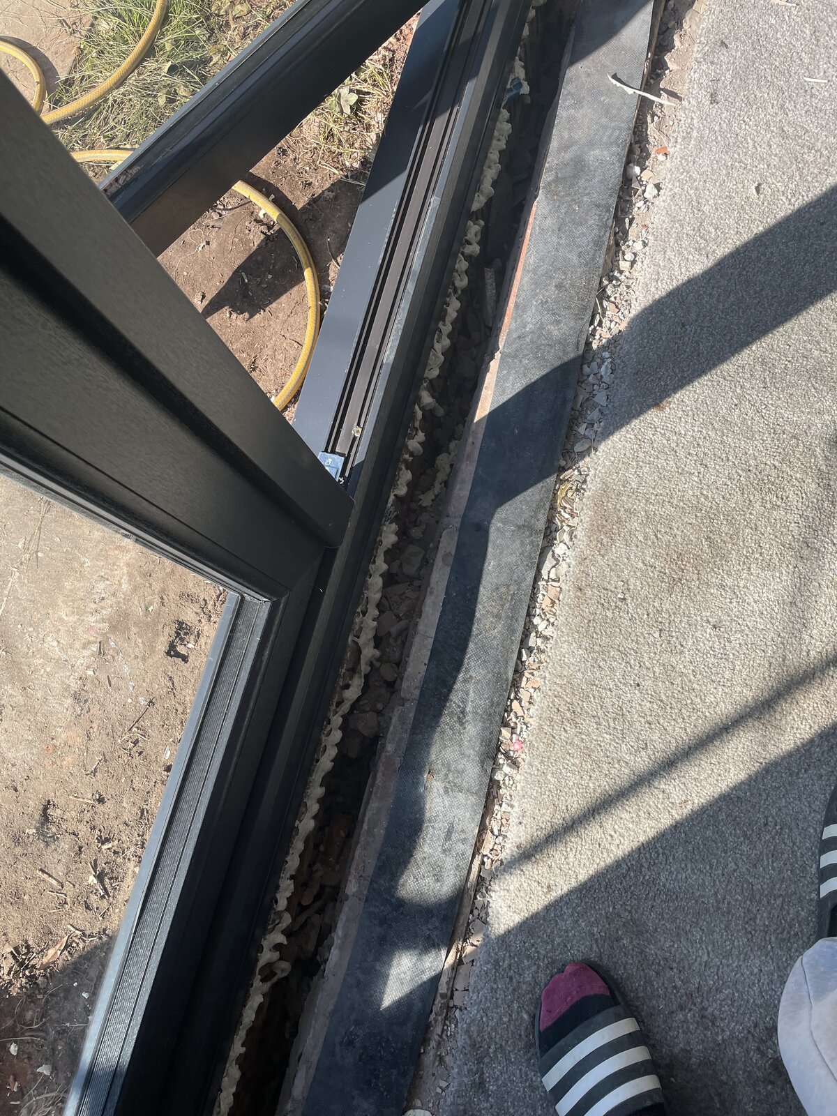

Hi,
nice got a couple of gaps to fill after window knock throughs for new doors.
I have DPM and Visqueen. Which one would be better to use please?
Also, cement mix should be 4-1 with some 10mm stones?
finally, do I need closers on both or just go ahead with the plasterboard? The one with insulation in is a different (newer) part of the house. The one without insulation is the old part.
thanks!

How thick is that frame?
Ideally it should be 30mm over the cavity to avoid cold bridge.
