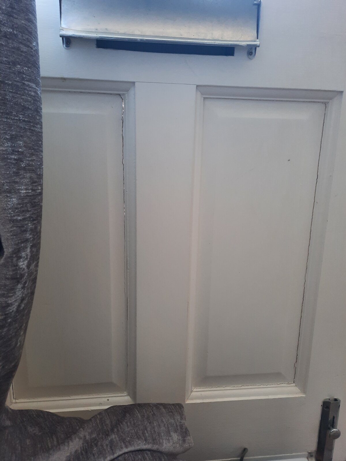

Hey guys,
Our front door has some small hairline cracks on the panels, in some cases you can just sbout see daylight, eek.
I'm thinking I can fill these? I'm just unsure what to use.
Based on where it is on the door running a bead down from a tube of something and going over it eith a wet finger seems more likely to be successful than a fill job with a filling knife.
I do have Tourpret wood filler but it's powered so would need to go on eith a filling knife.
Any thoughts much appreciated.

The powder based filler will crack pretty quickly.
You could use a tube OF MS polymer, eg CT1, but you may find that in time, the expansion results in ripples in the CT1, but if applied correctly, it should not split. They are similar to silicone, ie flexible but they can be painted over, with the caveat that the first coat of paint is waterbased.
Ah that's cool, I have some ct1, although I think it'd grey, I'll get some white. Blinding stuff.

I generally agree with your answers but if a door panel is going rogue, epoxy resin will be unlikely to help.
I too (often) recommend epoxy resins but I have never, ever, come across an epoxy filler that can be dragged to leave a finish that doesn't require extra filling or sanding.
A tube of Dry Flex 4. plus the liquid and gun is about £50 for the epoxy resin, another £20(?) for the liquid and then another £30 for the shockingly awful plastic cartridge gun- totalling about £100.
A tube of MS polymer will fit in to a standard gun and cost anywhere between £6 and £11, and it will be far more flexible than any epoxy resin.
Sorry mate, I normally agree with you, but on this one I do not

Thanks to a member here, I discovered that if you drip your finger in white spirit the CT1 will not stick to it.
how old, and how thick, is the door?
did the cracks appear during this record-breaking spell of hot dry weather, and do they close up when it turns cold and damp?

Hey Jon,
It was put in when the previous owner did the whole place up about 12-13 years ago.
My wife thinks she could see something very minor before, but I think it was perhaps a crack in the paint. It's only after this prolonged spell it's got worse. We've not been here long enough to know how it will go in the winter yet.
I'm not too sure what door parts those are I'm afraid, from what I can see it's just on those upright bits I posted. It's on both doors, however, it's only really on the door we don't really use, which most often has a curtain behind it. The main door it's just a very minor bit.
