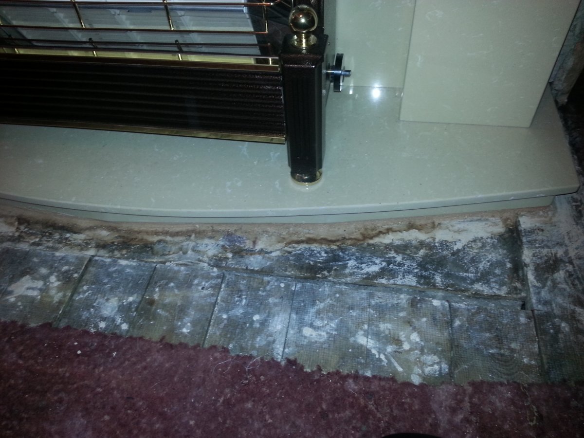

How to fill a large gap between floorboards and new fire place hearth. 20151220_203456.jpg20151220_203456.jpg
Getting new carpet, the gap is 2cm lower than boards will underlay and carpet leave a even finish.?
If its a fitted carpet I would have thought the Gripper rod would make up the difference
You just need the cement base covered, mention it to the Carpet Fitter, if he is reliable I would have thought he has come across this problem on many occasions.
