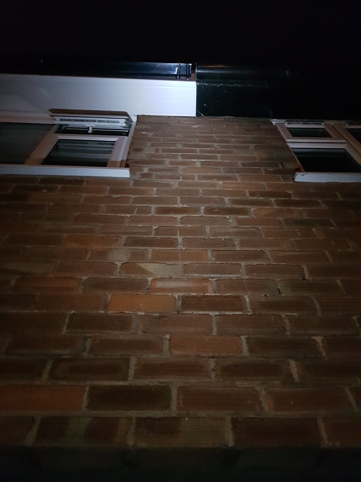

Hello all, I'm in the unfortunate position to have a council house on each side of my property.
I have recently had a lot of work done including new gutters front and back and gutter trays
I asked the fitter to stop end the gutters at both ends front and back and he has done. Theres appox 1 inch gap at the front and the Council have complained.

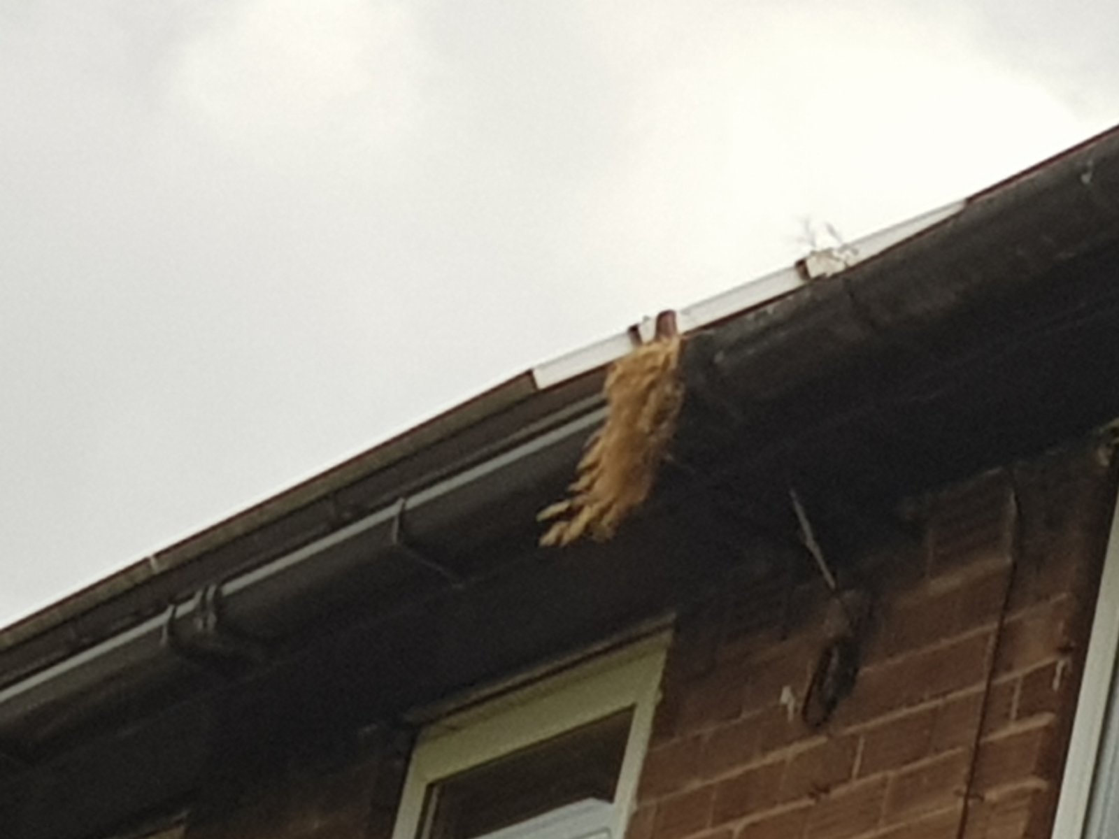

Bearing in mind the Council house gutters are completely full of soil and grass!, I have told them about this but they can't get in to clean them till 18th August!.

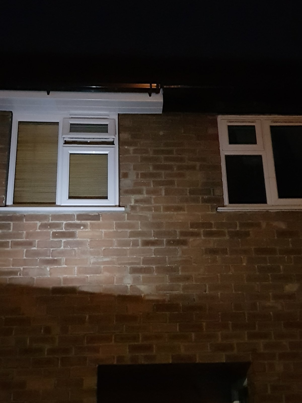

The fitter has said the gap is on the rise of the roof (rafter underneath) and water will run into both gutters.
It was p1ssing down at 11.30 last night so I went out to have a look and he was right, there are no drips as expected.
I feel like telling the Council to do one really (not the only issue we have with their properties!). But should I do something about it even though there is no issue?.
Basically when the council do clean the gutters out that will be the only time in probably 10 years so whatever happens I don't want any of their sh1te linked to mine!
Any comments appreciated.
Just stick to your guns. If you've gone to the expense of having new gutters fitted, why should you then connect it up to dirty guttering?
Tell them you will connect it up after the gutters have been cleaned.
There's an explicit right of passage of water via the gutters with any joined property like this. But you may get a response now.
The gutter should really be reconnected, and bear in mind that you can report the gutters as being in need of cleaning at any time, it's not just up to the tenants.
They have a downpipe on their side at the front, there was a downpipe at both ends of the block at the back (4 house run), I've added my own and capped theres off so they are no worse off than before..
The fitter has said he'll pop round and add a bit of flashing (as suggested above as well) but I'm deffinitely not having my runs connected again..

Yep next door has full aspestos back and aspestos front downpipe!.
We usually connect them up to stop the neighbours being a pain in the arse but secretly we cut and weld an internal stopend to the inside of the gutter right on the join. From downstairs it looks connected but in the gutter there is a little mini dam in the way!
To be fair they're right that they should be all connected up to avoid gaps, but also they should maintain their sections correctly.
I like the suggestion of connecting them to avoid a gap but putting a small mal in to stop the muck coming.

the fact is , there is a gap because your is too short.. why not add a union in your gutter length which would close up the gap.
I came home in the rain tonight after work and checked the gutters on the way in, still no leaks..
Theres a downpipe on each end of the block of 4 so 2 houses per downpipe, I've not put any more stress on the pipes that were already there.
I'm having the ridges redone but to be honest I'm in the mind of leaving the gutters as they are as they aren't leaking...
