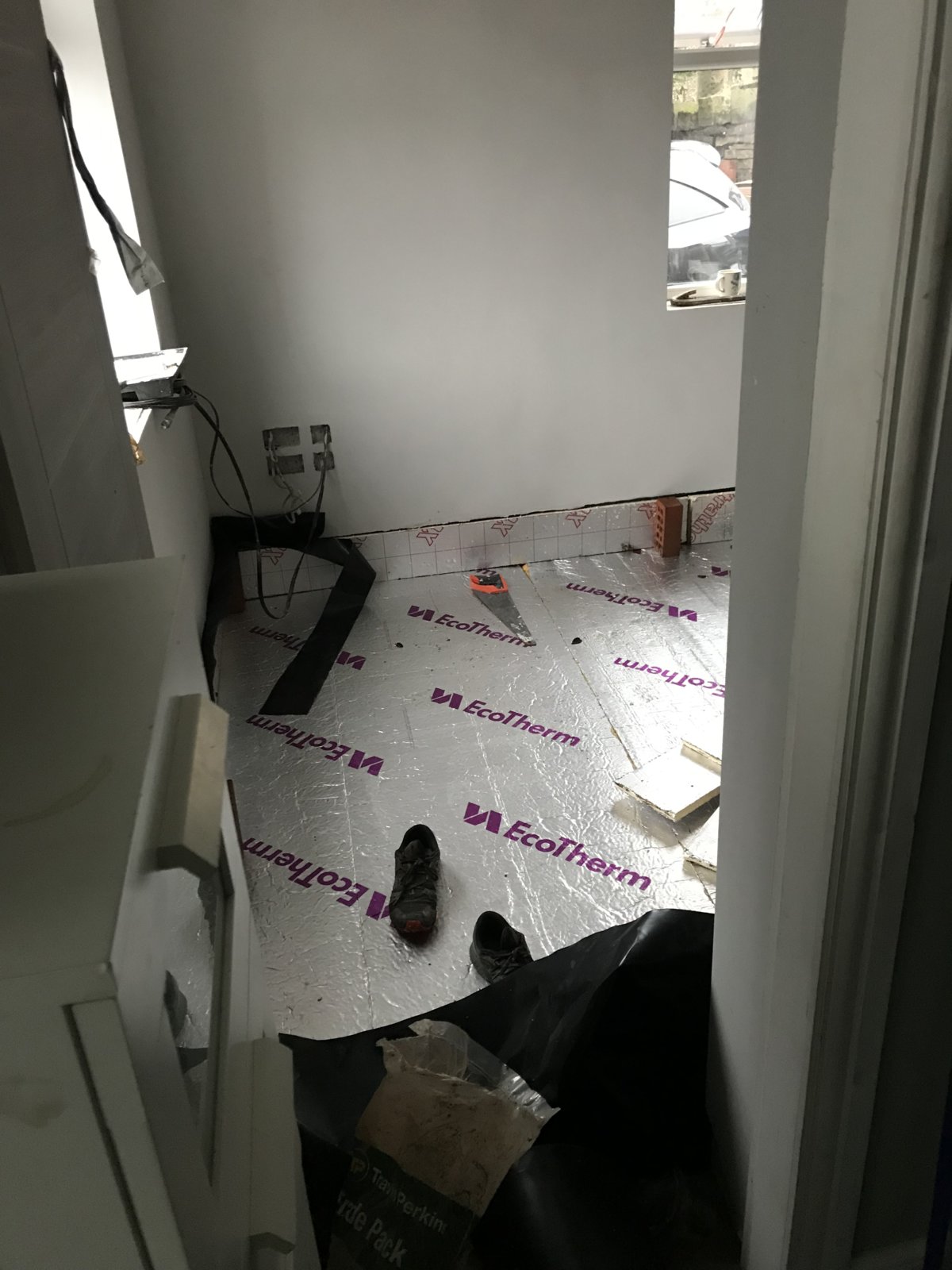

Garage conversion floor

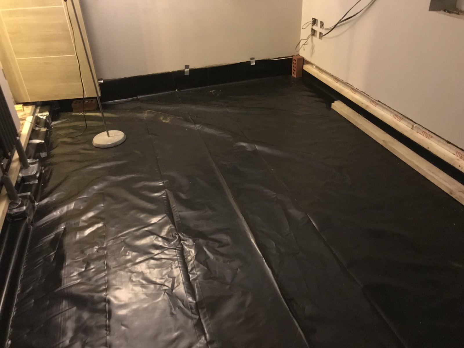

you would need a dpm or similar on top of the insulation to stop it floating away, once one lifts and the concrete goes under I'd have no ide how to solve that issue.
The upstand also helps to stop thermal bridging into the ground via the wall, in reality the thermal resistance of 3m of soil is not far off 50mm of celotex, just it has a huge thermal mass. So still worth having it.

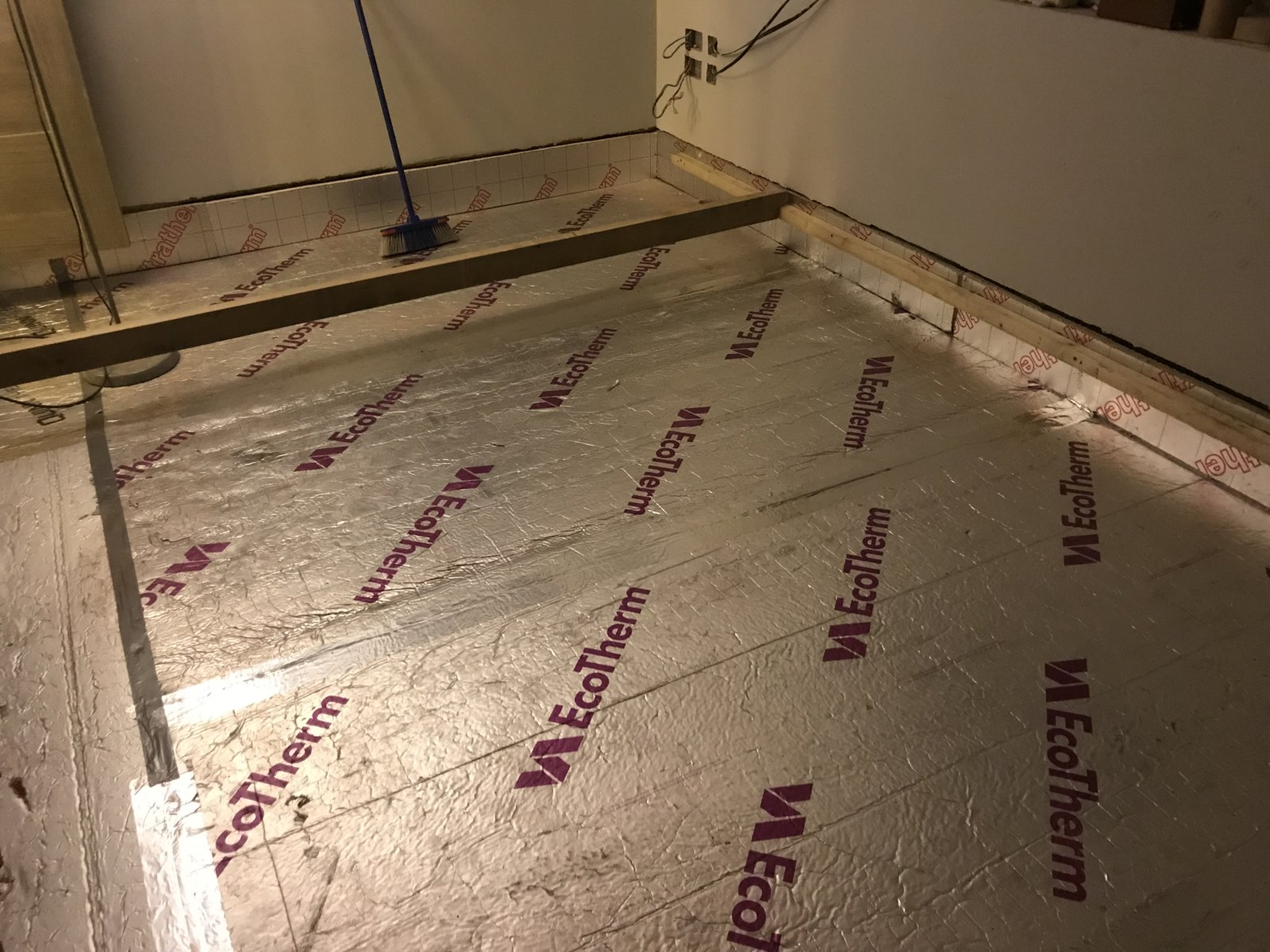

My upstand will be half in the floor and half behind the skirting boards:
So long as you can get a decent fixing in for the new skirting should be fine. Tape all joins to reduce risk of liquid in the concrete getting through/past or sheet over the insulation as a second membrane.

Quick question, if my concrete is going to be 125mm thick would you add another 25mm of insulation over the existing 100mm or have the concrete thicker?
I overtook their mixer on my way to Denton this morning and noticed the 01706 phone number :)
I didn’t manage to get more insulation so have thicker concrete.
