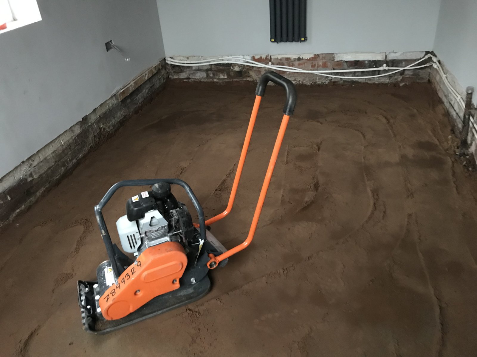

I’m making a garage into a room.
There’s a rough concrete floor in there at the minute and I need to come up 200mm.
Do I need to break out the old floor or could I level it with sand, DPM it, insulate it then concrete it?

I put a level on the floor and it was a bit all over so I broke it out and found parts were really thin.
There’s an 1800x800mm brick thing in the middle, hopefully an entrance to an underground lair.
Now it’s broken out i’m wondering if a suspended floor might be better/easier than the concrete. Only thing it is not ventilated at all.
I’ve still got loads of 100mm Celotex and rolls of DPM so not sure which way to go.

Just wackered it now, i’m going to give it a go over with a float and level before I put the plastic down.
I have a ton of decent fabric/membrane stuff, is there any point in a layer of that on the sand to protect my plastic even more?
Didn’t bother with the membrane.
Should I be doing the 25mm upstanding on all 4 walls or just the outside walls?
And the insulation is a bit bent, should I put weight on it for a week before I pour the concrete or will the weight of the concrete push them down?
I'd put upstand it all the way around it, minimise cold bridges and holds the membrane up too if its a tight fit. Weight of concrete should flatten the celotex but you can put concrete blocks on while you wait for the concrete to arrive if you wanted or just cut it across into more pieces. I silver taped joints on mine (or you can thin plastic sheet it instead) as what happens in the liquid of the pour can get through the gaps between the celotex (probably wont make it float though) I think some got past my tape as there were a couple little air holes which appeared as the concrete settled, I troweled them out.
