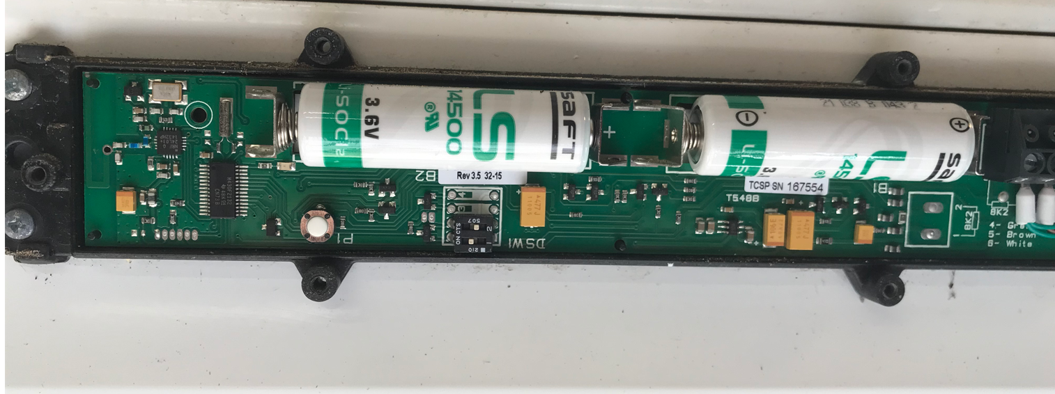

My garage door has been beeping and the battery indicator has been lighting up. I assumed it was the batteries that detect whether there are any obstructions. I replaced them but it hasn't made a difference.
When I move it in either direction, it moves an inch or two and the stops with beeps being generated by the panel.
I have killed the power and restarted it but it hasn't made a difference.
Any suggestions please?

The batteries measure 5vdc on my fluke tester. It’s the same for the old and new batteries.
I can’t see any sign of corrosion on the terminals.
Is the obstruction detection an optical system and if so can you clean it?
I thought that this battery compartment was the detection mechanism? It’s completely clean.
I was wondering if there was a way to bypass the obstruction mechanism to determine if this is where the fault is. If this is faulty, I could order a new mechanism and replace this. Looks pretty small and hopefully straightforward…

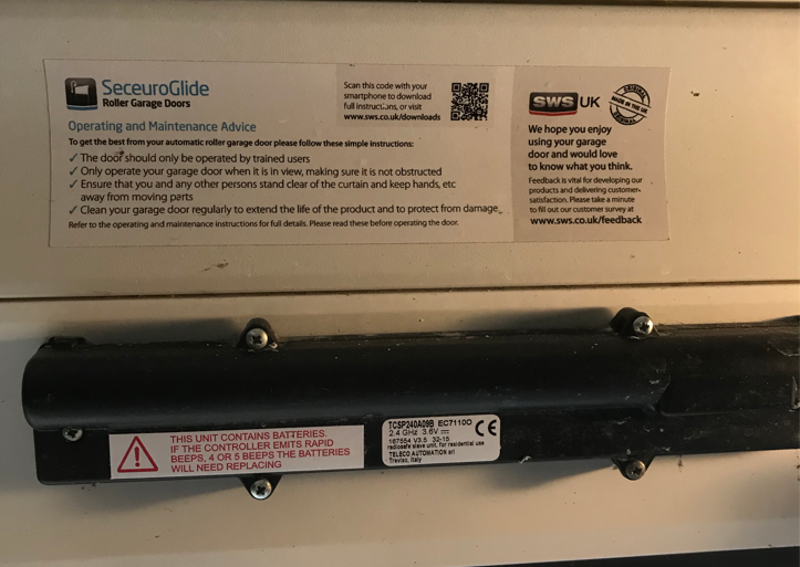

My mistake, yes that is the obstruction detector - I did say I didn't find the manual! :)
Have you seen this installation video?
It might help you check the condition of the wires inside.
It concerns me that you say the batteries read 5V. The lithium cells in the video are 3.6V each. Do you have a different battery pack to those?
Another possibility is how it connects to the controller. The label says 2.4GHz on it so I presume it connects wirelessly to the controller. Could there be a pairing issue?
We really need to find the manual! :)
The reading surprised me too. The batteries are definitely labelled up as 3.6v. I tested the existing and new batteries with the same results.

I literally have an instruction manual in-front of me as I have an issue with mine too at the moment, Stopped working after I changed the battery's as the safety edge and control unit seem to have lost the pairing and I cannot repair them (light on the safety edge will not come on when pushing the pair button).
I am hoping my issue is that I put in some cheaper battery's from ebay that are 2700mah instead of the 2600mah, Although its the same battery's I took out I know they are not the original ones which are these that come with the safety edge in the original box:

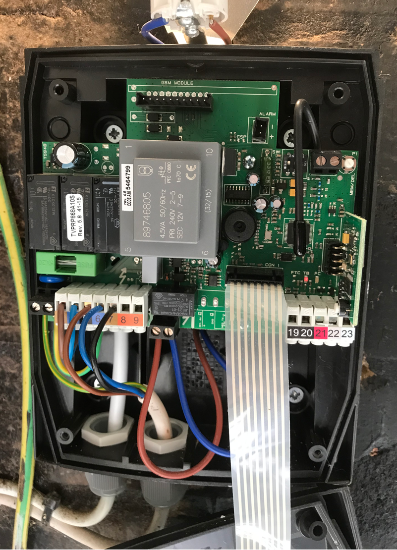

UPDATE: I opened up the control panel and set Dip Switch 1 to off, this didn't make a difference. the door goes up a few inches and then stops. There is no operation in a downward direction.
I notice that when the unit is powered up, I get one long beep.
I did also try my two pole tester in the terminals on the right (just off the picture. sorry), I don't detect any power in them. Don't know if I should be...
I' welcome any other suggestions that you may have. Thanks again.
Sounds like motor or safety brake issues then.
Assuming you can wind both up and down manually? If so its not the brake and must be the motor
