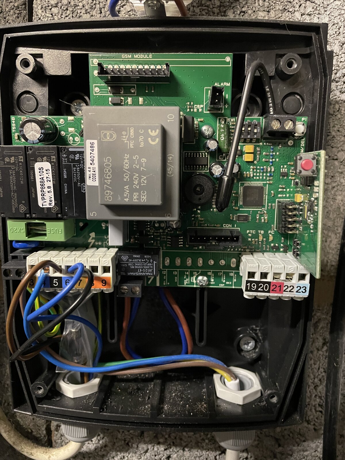

SWS garage roller door with TELECO TVPRP868A 10S controller and TELECO BST-S24 radio slave unit on the safety curtain - not a hard wired system.
Having trouble with the controller. Normally on turning on, the two red lights above the push buttons come on and then there left-hand one goes off and unit makes a long beep.
Recently on start up both red lights stay on and the unit makes repeated 5 beeps and the door will only go up. I have to hand crank it down.

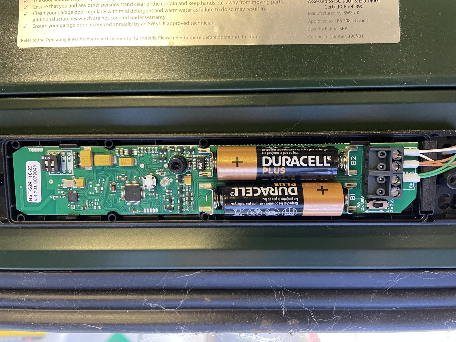

From the manual these 5 beeps indicate a problem with the safety skirt. I have firstly checked the batteries, OK. Checked the slave and master are bound, yes all OK.
I have now (temporarily) disabled the safety skirt so that I can use the door but am now looking at any way to establish what the fault with the safety curtain is.
My thoughts are that possibly the lamp providing the beam has gone, this would make the receiver think the curtain was compressed, but how do I check this please?

I have resolved this issue thanks to a phone conversation with Mark, a technical support engineer for Ellard. who are the UK agents for Teleco control systems.
By being given bum information by the supplier of a new fob, I had inadvertently un linked the door skirt monitor from the control unit.
Mark took me through the procedure following the installation of a new system and everything works just fine. Even "tested" that the rubber I/R system was working.

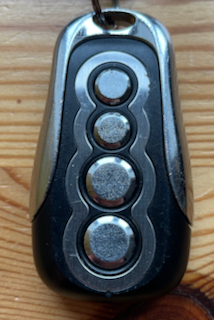

My problems started when I had to get a new FOB. It seems one can un-link the curtain receiver from the main unit by pushing FOB buttons in a certain sequence, which I guess I did.

Does your controller and safety curtain receiver look exactly like mine inside?
I can't remember the exact routine for re programming the system but contact this company who are the main distributer of the system we have.
Possibly safety curtain issue, the curtain becoming un linked from the controller.
The guy you want is Mark Grice, Senior Technical Engineer at Ellard. He's on 01619454561. He talked me through the process.

When you turn the main unit on, what do the two red lights above the push buttons do? They should both come on initially and then the left hand one should go off and the unit gives a long beep!
Fixed it!..... I think!
Only one fob was working, I've managed to program the second fob now, but the up and down buttons on the control unit still didn't work, so I read up about the holiday mode option, did the deactivation process and it's all working again so I've no idea why the original down problem occurred but I think the up and down problem was cause by me messing around and putting it in holiday mode without realising, just noticed the 20w bulb is not working now so swapped with my 15w fridge bulb and all is good again!... fingers crossed!
