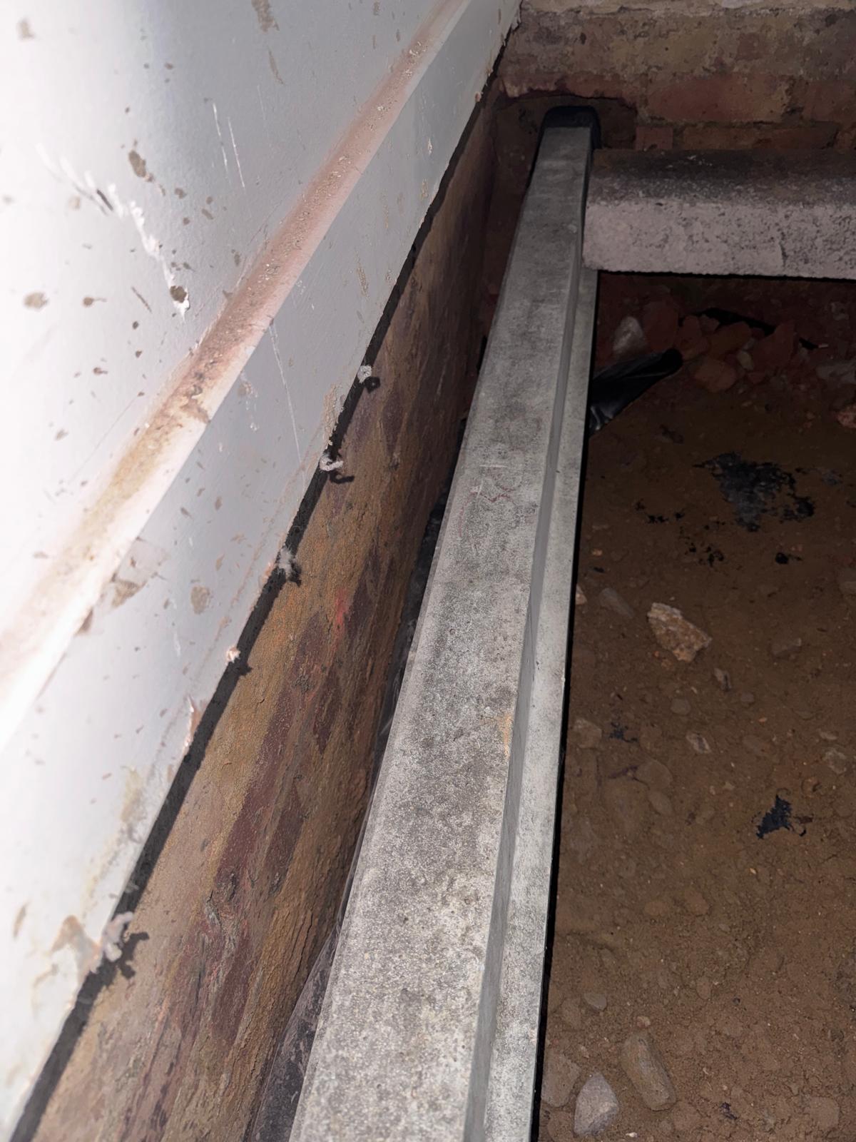

ANYWAY, we have now decided to go for a block and beam floor (yes I know, far more cost) as we're too far in to turn back now. A few days have passed and I noticed that in some areas the water was even puddling after prolonged periods of rain.
We have a block and beam floor in an other part of the house where the extension was build during the summer so I never saw the effects of prolonged rain.
The garage has a single skin wall so the builder have suggested creating an internal foundation + engineering brick wall for the block and beam to sit on.
I know there should be a bed of hardcore, sand blinding and then DPM with a 150mm void under the block and beam floor - however should I be concerned that the water rises so much during winter? Flooding under the B&B floor may be unlikely but the water sitting under it/ rising/ falling - is that a cause for concern or normal?

But my question was more about the water pooling under the floor - is this normal or should I be concerned?
So because of the dimensions of the room the final beam has about a 30mm gap against the wall. (The alternative would have been to install another beam and cut down blocks etc - which seemed like an overkill).
The floor build up will have a 150mm PIR insulation before another 60mm odd of screed, and the (internal wall) is to be plastered as well which closes some of the gap - is this gap between the beam and wall an issue?
