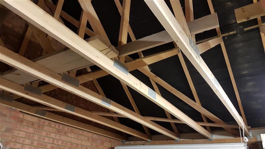

Please see below a picture of the roof structure.
I was wondering what the best course of action would be. Celotex or similar between the rafters or just board the joists and put some celotex/rockwool in between? Boarding the joists seems the best idea as the ceiling level would be much lower and I guess the heat would fill up the room quickly.

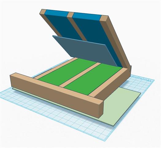

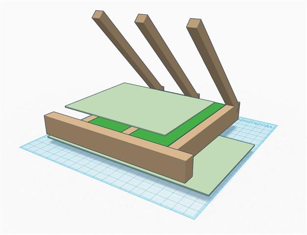

As I may not be using the correct technical words, I've made a quick 3D sketch.
Green: boarding the joists and add rockwool/celotex. Advantage: lower ceiling, easier to warm up - Disadvantage: no access to roof structure
Blue: insulate rafters and board. Advantage: access to roof structure (do I really need that) Disadvantage: Gables will also need to be insulated, more space to heat, trickier to realise.

Can you go for the green approach and leave yourself a large access hole with ladder? As you say it'll make it far easier to warm up, and what you want is rapid response from your fan heater for those times when you're just popping in for an hour or two. You wouldn't even need to fit a hatch - just get an old 1M x 1M piece of board or 50mm PIR insulation and pull it over the top of the hole when you're not going up there.
love the drawing, but you don't need to do both.. Assuming you want to use the roof space for storage/ mezzanine, I'd just infill the roof with GA4050 or rockwool, standard loftroll or similar and then either board over wiith plasterboard or insulated plaster board (e.g. PL4040 or 4025),
What's your budget?
I'd plaster board and insulate between and over the ceiling joists with dimple cheap rockwool/fiberglass.
If you use the space intermittently put any insulation inside the thermal mass.
If you do the walls with PL4025 that will make a big difference - also you could make up a screen for the garage door using hinges and batons to avoid replacing the door.
I'd do roof, door screen and walls in that order..

On the option of blue vs green comes down to a flexibility vs volume compromise.
flexibility - insulate the roof to retain the space for storage
volume - minimise the heated area.
On the insulation screen - Imagine a bifold "door" made out of 2" x 1", in filled with celotex and then covered in sheeting. e.g. (without the wheels.) Make it so it can fit snug inside the opening.

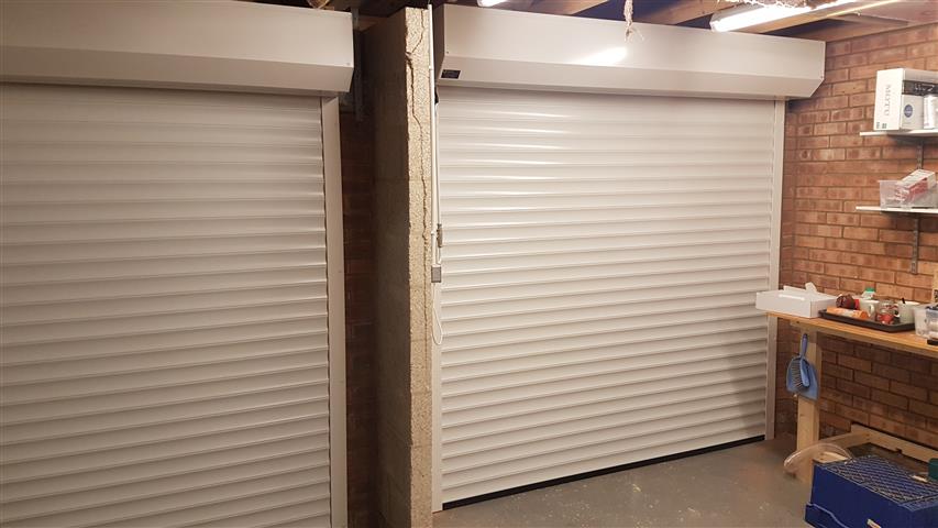

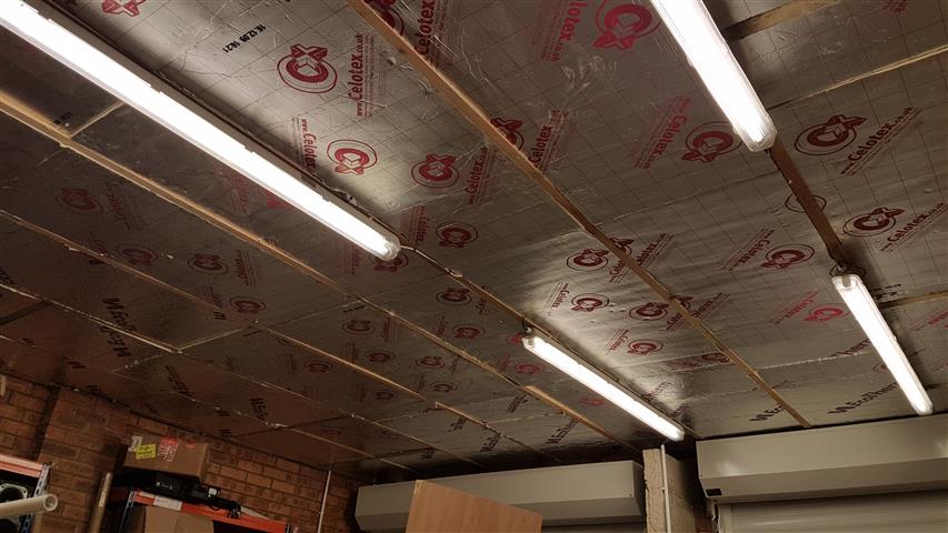

Just a follow up. I have now completed the ceiling with Celotex 75mm, it just needs some boarding. I am thinking of 9mm OSB as if not mistaken it won't need any coating. In the end I had the roller doors replaced with insulated ones. I thought I would never be able to do a decent job with the existing ones and my DIY room is a big part of my spare time so I open the wallet for that - but they were much more expensive than I thought.

I must say I am pleased with the outcome. Clearly the heath escapes from the wall and the floor but I can now reach a dry, comfortable temperature of about 15°C with -2°C outside which I can maintain with my electric heater set to half (1500W). When temperature is over 5°C things are much more easy. Only main downside is that temperature at floor level is much lower than head level!!
