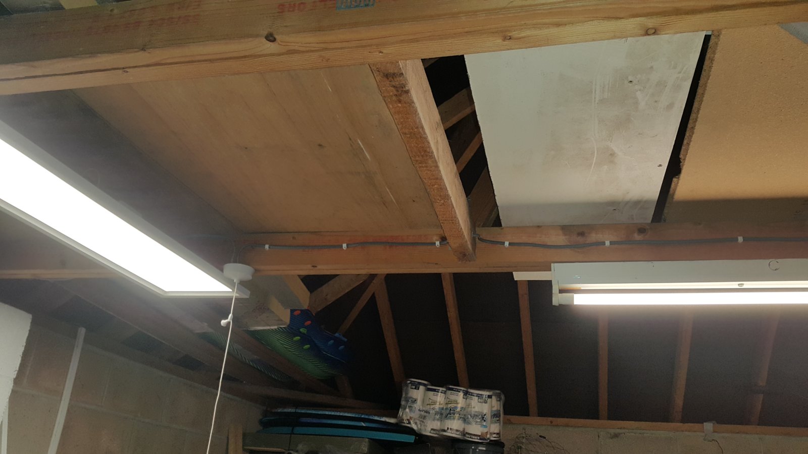

Hello
Would appreciate if someone can double checking my understanding here please before I make changes.
My garage has a consumer unit powered off the house CU via a RCD. Within the garage there is a single light fitting (fluorescent) which is on a loop from the garage CU via a wall switch.
I would like to add a second light which is itself switched via a pull chord. The second light should only work when the wall switch is on.

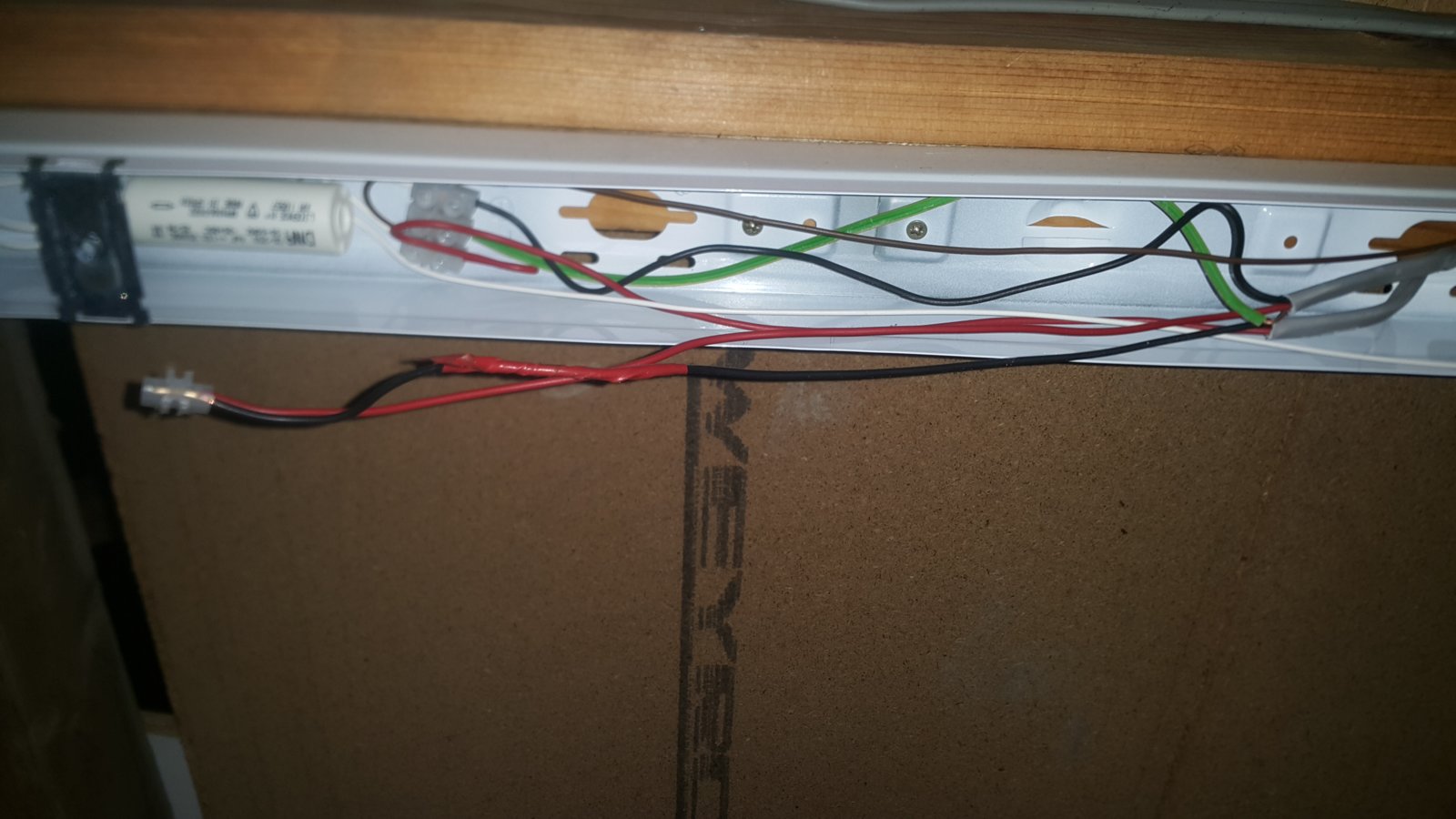

I opened the flourescent fitting and I noticed the switched live (neutral with red tape) is connected directly to the red live. That confused me a bit, because the actual light fitting doesn't seem to have its own switched live. Presumably this means the switched live is energising the live (black with red tape, to red) which then loops via the CU to the light fitting?
Is the correct way to add the second light fitting simply to add a new twin and earth to the light fitting choc block?

Yes. The block in the light.

Finally got around to looking at this as I want to wire up the second light.
I just can't get my head around what is going on.
The black wire with the red tape around it and the red wire both going into the single connector block (hanging down) are at 254v relative to the black wire in the 3way block inside the light fitting.
So that wire hanging down is live all the time basically.
Why would that be? A second switched set of lights perhaps, independant of the existing wall switch ?
Mike
Live ("All the time") , neutral & Earth comes in on one set of T&E - lets say T&E 1
then to use the switch the live Live ("All the time") is connected to the 2nd T&E - black with RED tape , goes back to the switch as live and then the RED from the 2nd T&E comes back form the switch to the light block
So when you use the switch it uses the RED/BLACK with red tape and switches over to the RED wire on the 2nd T&E making it live and back to the Light block
Normal way a Light is often setup , so you can pick up the Live Neutral & Earth and daisy chain to next light and then use another T&E to got a switch
if that is correct description, as the RED wires , and not 100% clear on the image
then if you want to use the same switch to switch another light - USE another T&E and connect to the light block itself and out to the next lighr
The only slight confusion here is that "usually", the live coming in (the red wire in the cable where the black connects to the fluorescent fitting's terminal block) is connected to the red of the cable that goes to the switch, then the switched live (black marked with red) connects to the fitting's terminal block.
In this case, the incoming live is connected to the black marked with red and the switch wire returns from the switch on the red wire.
Thanks all for your help. All done. I had isolated the lighting circuit at the garage consumer unit and left the sockets turned on. At some point the RCD in the house tripped. Guess I'm glad there was an RCD!!
New light fitted and working and there are no odd smells or smoke! Result.
