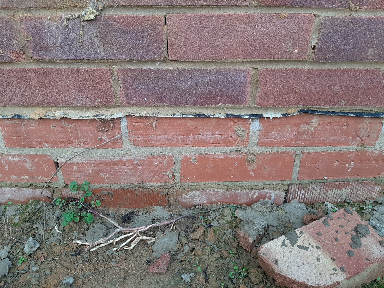

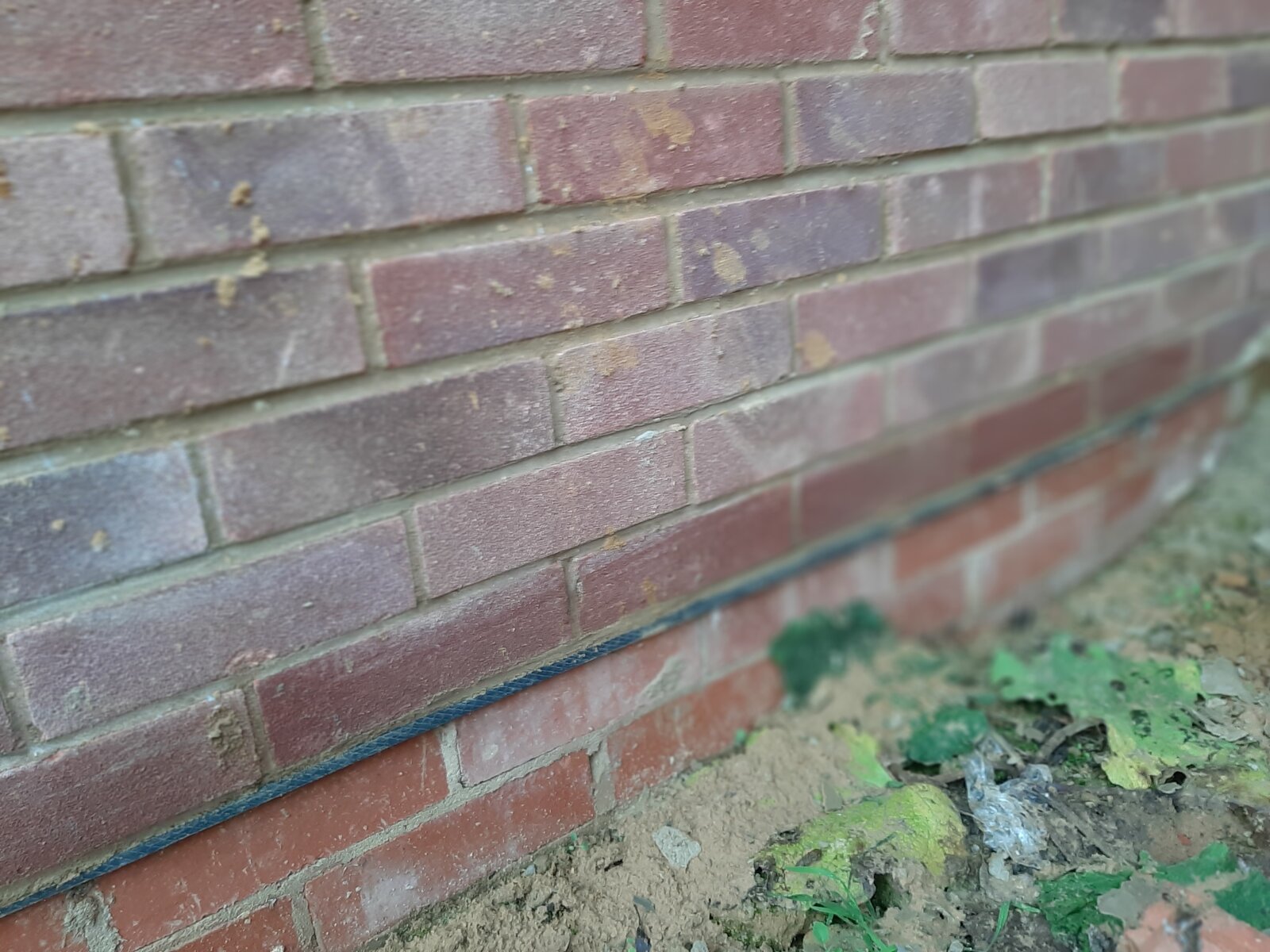

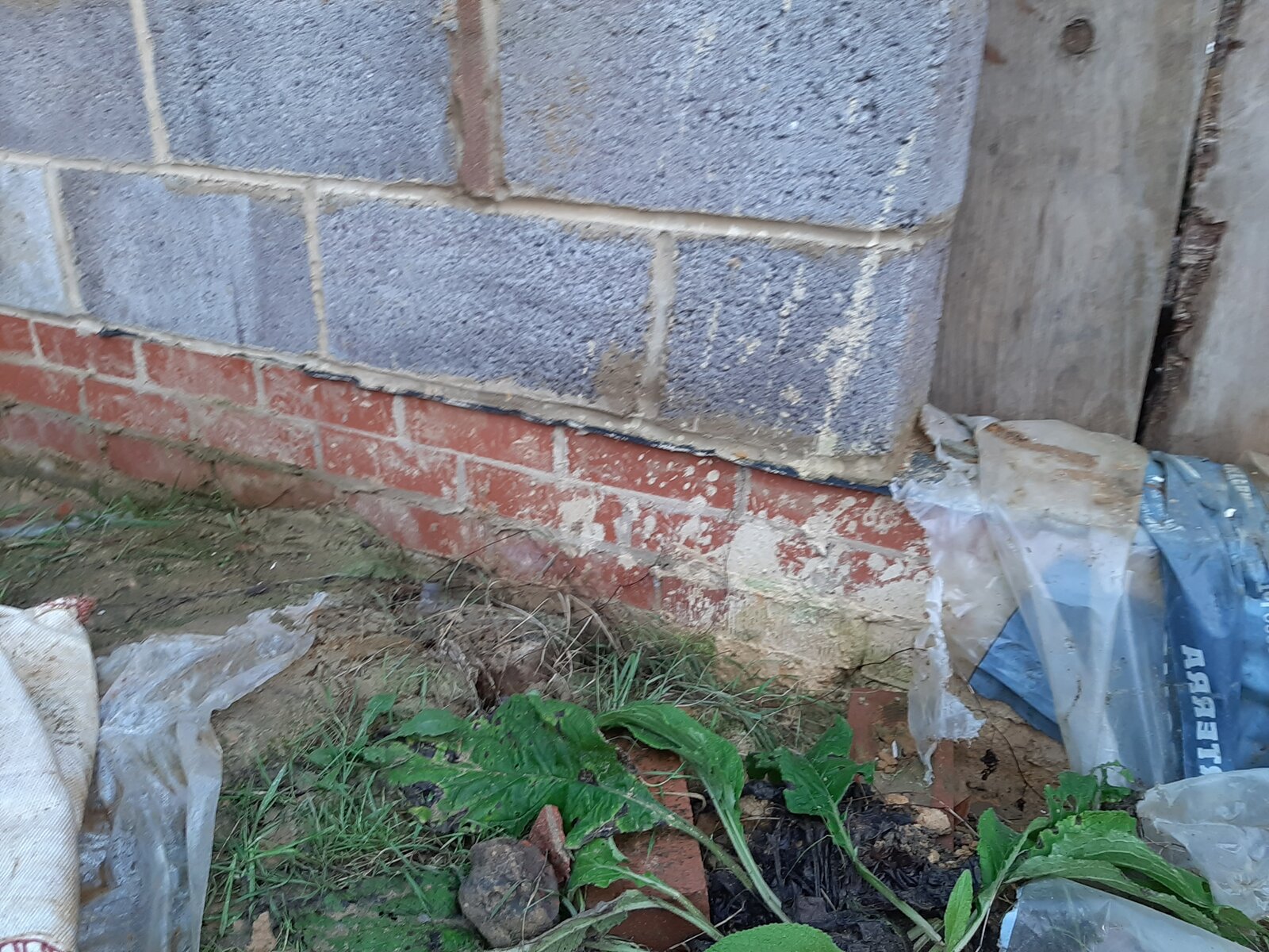

Hello guys.
I am having a garage built, but it is now well over budget.
The only place I see where I can cut costs is in doing the floor, or most of it, myself.
I have enough hardcore. Here I have attached photos of the damp course, and seek some guidance of how to set about doing the floor.
All advice is thankfully welcomed.

Well, you want at least 150mm of compacted hardcore and 100mm of concrete. The depth of hardcore will depend on how good the existing ground is once you scrape off top soil.
Work out your finished floor height and excavate to he required depth.
There is no need for a DPM, but that may be a subjective opinion as to whether you want to fit one. If so, allow for 15mm of blinding sand. No need for any reinforcement either.
