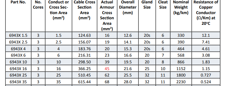

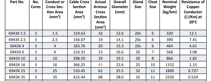

Good chance the Ze will be high enough to cover you but assuming fed direct from source 10m of 16mm SWA would have a 10kA short circuit fault current, and slightly more EFC with the 3rd core used as CPC and the armour earthed which is standard practice, going from this table
Good chance the Ze will be high enough to cover you but assuming fed direct from source 10m of 16mm SWA would have a 10kA short circuit fault current ...
Sure - but, as you imply, it's the Ze that is the saving grace.
Even if the SWA were of negligible length, 10 kA would imply a Ze of 0.023Ω - which is far far lower than I've personally ever seen in a domestic installation. I think that around 0.1Ω is the lowest I've ever seen (and that very rarely) and that (with negligible SWA length) would only result in a PEFC of 2.3 kA - and, in that situation, with a TN-C-S supply the PSCC would obviously be the same.
