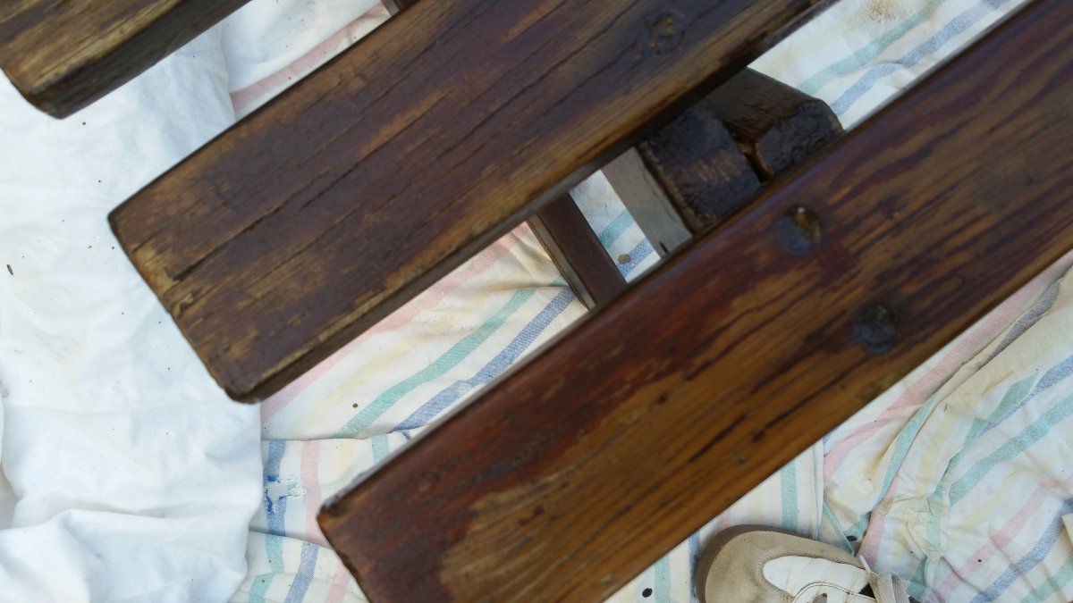

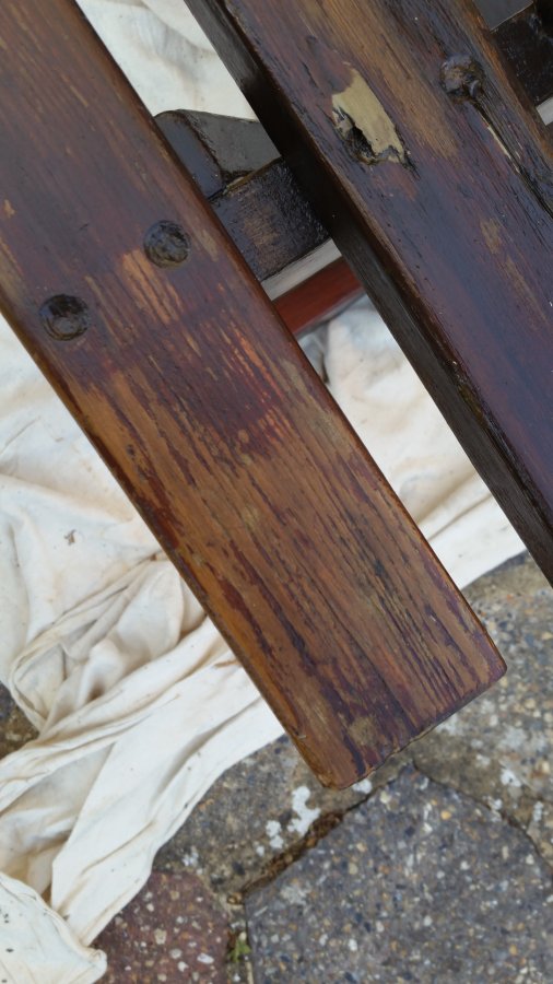

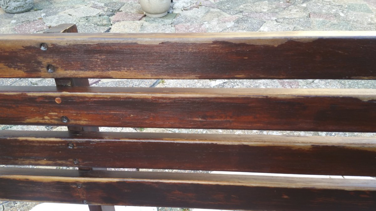

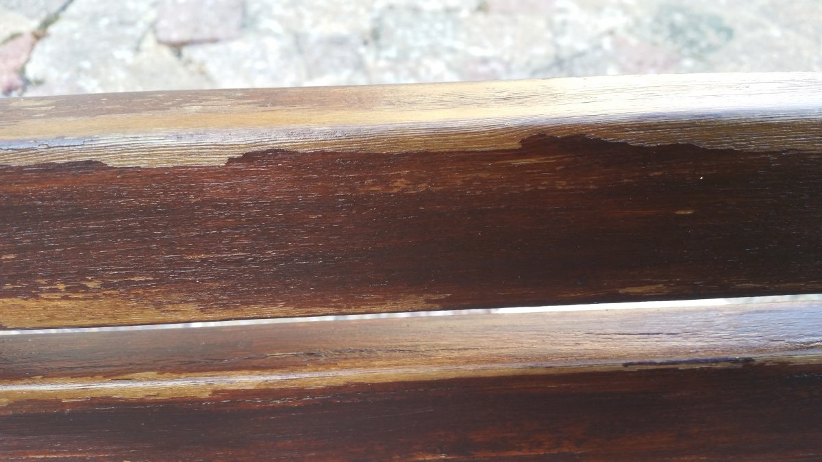

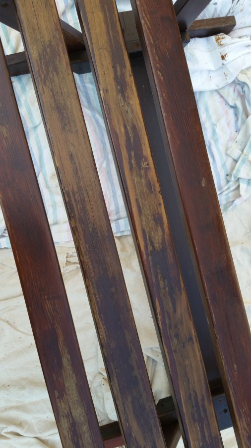

Greetings,
I am in the middle of painting a garden bench.

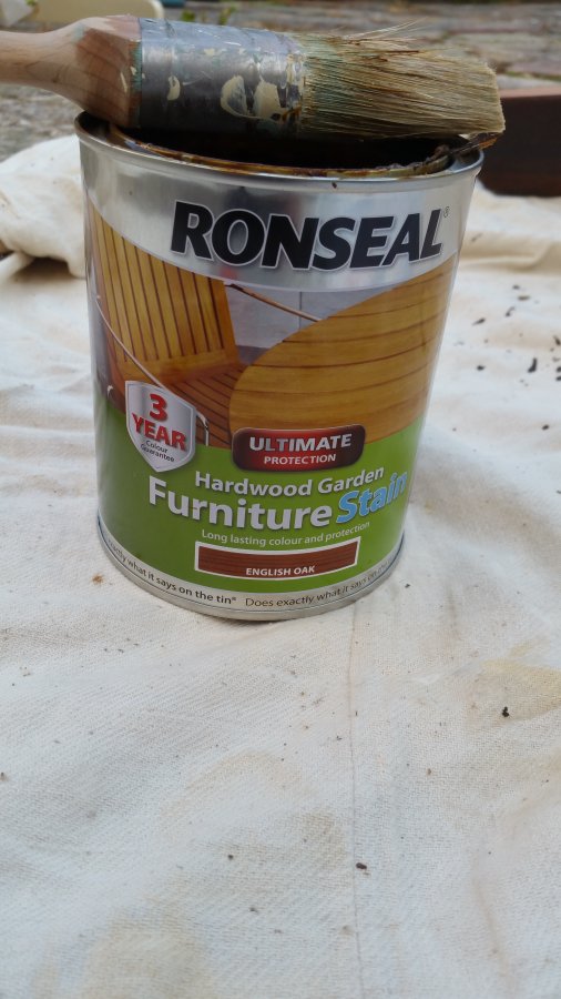

I have sand it to remove any bit of flaky paints - some bit went back to raw wood - I guess this is how you call it and now staining it / painting it with the following product:
Ronseal / Hardwood Garden, Furniture Stain - English oak
See picture attached
This was recommended by the B& Q shop - however once painted, the colour does not cover properly the raw wood and which I was expecting.
Already done two layers! and really want your thought before I start on an extra two layers!!!
Am I using the wrong taint? product?
Thanks,

Stain is not paint. It will stain bare wood (like it's supposed to) where you have sanded through, but where you have not sanded through it will just sit on top kinda like a varnish. You need to sand everything back to bare wood to get an even stained finish, or paint the bench instead.
(It looks like the bench may have been coated with a darker (mahogany?) stain originally. Your English oak colour is quite different).

Garden furniture stain is not just stain, it's combined with varnish. That's probably what it had before.

Unless you sand the whole thing evenly back to bare wood, yes.

Yes. Give it all a quick, light sanding to key the surface. You'll need some sort of exterior paint, but here my expertise ends! Someone else should be able to advise.
That's great! This is what I done so far! So finger cross that should be fine! :-)
