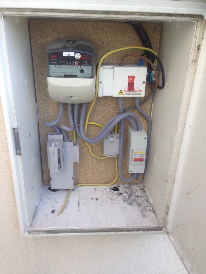

Well whoever wired that was a bit of a numpty - 2 isolators in series.
And they weren't very competent, using a BS 951 earth clamp on the armoured cable instead of a proper gland.
How far is it from there to where your CU is?
Anyway - when your electrician comes, have him tidy that up. Gland the SWA properly, and although the electricity companies technically don't like it, you've already got your own equipment in the box, so one more item won't make a difference - have him split the tails, replace the isolator with another switchfuse, or an MCB, and run a separate supply for outside use.
Interesting comment. The CU is about 6 meters away from the meter. The house was re-wired at the same time the meter was relocated. The meter guy fitted an isolated to the meter, the electrician (who re-wired the house) said because the CU was more than so many meters from the meter he had to fit an isolater as well, that is why there are two isolaters, I thought it was excessive but the electrian quoted regs at me so I went with it.

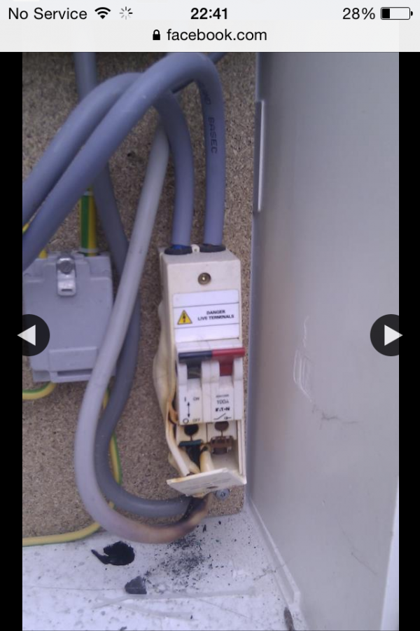

Slightly off topic but when I had all my electrical work done the lights started flickering and the electrics went! When looking in the meter box I found this!
Electrician came straight out and said the tails hadn't been tightens enough!!

  1. Why did he not replace the first one?
  2. Why did he not terminate the SWA properly?
Somebody should quote the one about competence and appropriate materials to him.
replacing the first one would require either live working or the seal fairy visiting. You'd never justify live working with a risk assessment in this situation. And the first one is only an isolator so there's no discrimination issue. So I'd not fault the electrician here.
Regarding the swa termination, not much good to say about that...
You obviously have a more lax attitude to 134.1.1 than I.
I want as close to perfection as can be achieved, not "good enough".
I am not aware of that rule, but I was just doing a risk assessment in my head. What does the rule say (and why, assuming you agree it's beneficial here?)
134.1.1: Good workmanship by skilled or instructed persons and proper materials shall be used in the erection of the electrical installation. The installation of electrical equipment shall take account of manufacturers’ instructions.
