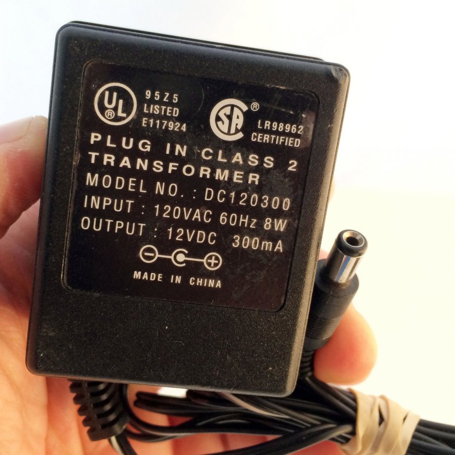

Hi, I am looking for advice regarding garden lighting to illuminate trees and bushes at the end of my garden some 25 meters from the house. I am not too certain of using mains voltages in the garden and would prefer not to go this route.
I have searched for suitable products with not much luck so am considering using 4, 12 volt LED work lamps that I already have (much like these http://www.curtisinst.co.uk/files/3114/1580/7515/50212_LEDLamp_RevB.pdf ) and need some advice for a suitable transformer to mount to the house and low voltage cable to the lamps. The lamps I have draw a current of 1 Amp ( 12 volt) per lamp.
I am unsure of the voltage drop and size of cable required and a supplier of transformer, any ideas please?
Thanks, Steve

Given the distance, I would suggest running a mains supply and having the transformer (suitably enclosed) close to the lights.
He needs a DC power supply not a transformer, but, yes close to the lights is a good idea.
One of these with appropriate ratings
