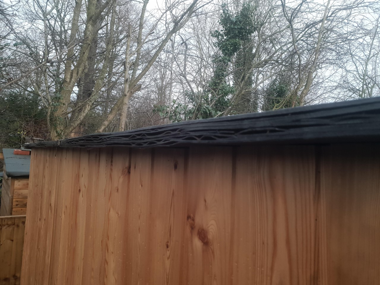

We’ve recently had a garden office built. Generally, we were very happy with the finish, but it was only finished in August of this year and we’ve already noticed some problems (that I’m pretty sure we shouldn’t be seeing this early, if at all). Firstly, on one side of the structure (the back, which I hadn’t checked for some time) the boards on the roof have taken in some water which has separated them. This was the only side that didn’t have a lip covering them and I wondered if they expected the angle to on the roof to reduce water intake here but I guess they weren’t sealed or some other issue has occurred. Not sure on the properties of the roof but I imagine it has a fibreglass top or something similar.

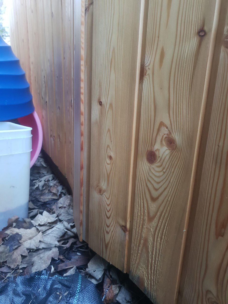

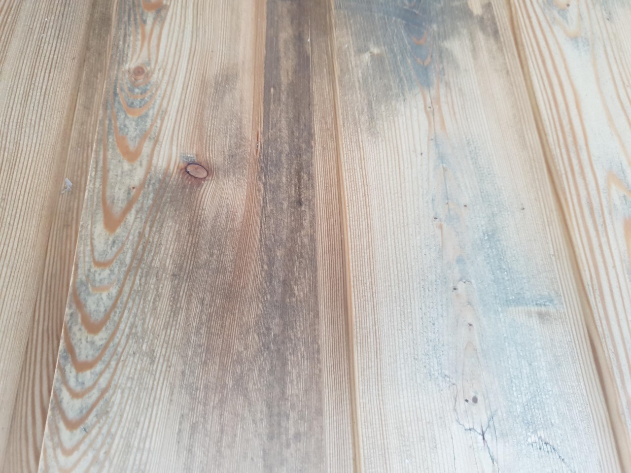

Secondly the cladding has popped away from the structure in a few places (I’m pretty sure the cladding is Siberian Larch). I don’t know whether this has occurred because water has got in behind, or because of changes in temperature (but if so this should have been accounted for when fixing surely?). Also on this back side the cladding already is discoloured which is fine in itself (I believe they go silver over time anyway) but I wonder if this has been accelerated because of these issues.

when are they going to finish it with felt/rubber or fibreglass as a waterproof roof rather than an unprotected roof ??
it looks like it was not delivered as a shed kit for self-assembly, but constructed by somebody who considered himself to be a carpenter or handyman, is that right?
I see it is clad with vertical T&G, and has no visible gutter, and the cladding boards were fixed when dry, with no allowance for expansion due to weather, and I see no preservative or water repellent stain. Or is the cladding shiplap, which has incorrectly been fixed vertical? Am I right?

I can't see what the roof is made of. Cardboard? Delaminating ply?

The roof deck boards are cream crackered and need replacing.
The roof edging detail has not been completed properly.
Hard to tell on the vertical cladding but I would say insufficient expansion gap.
Be aware that the correct detailing for vertical cladding is: vertical battens then counterbattened with horizontal battens.
Its impossible to tell if the claddibg is siberian larch or pine -the grain pattern is very similar. Its easy to tell on an offcut -siberian larch is as heavy as oak.
Thanks for the replies everyone. If I replace the edge boards can you cut away the affected areas and replace or would the entire roof need replacing? It's a 30 square metre space so replacing the entire roof would be a nightmare.
If it's just the edge boards that need replacing after they've been finished can I just do the edging properly so that this won't occur again and if so what's required?
I've just checked and the original contract had the roof down as a GRP roof. The boards that have separated look like some sort of plywood perhaps but not sure as I'm not very knowledgeable in that area.
There's definitely no gutter, and they have been fixed vertically as you say, with what seems like no space (or little space) for expansion. So would these all need replacing now (or can they be reused even?)? They definitely had a preservative applied although I haven't taken note of which one.

Take a photo of the top surface. At the moment it just looks like plywood that has been left outside without protection. I've had an old bit of plywood outside for a few years protecting the compost and it's gone like that on the edges.
Timber always expands much more across the grain than along it. If it's forced its way off, either it was too dry when fitted (should be getting on for 20% moisture content if it's for outdoor use I would have thought) or it was fitted too tight to each other.

Yeah, it looks like there was a GRP resin applied to the top layer but the edge has just gone on one side where it wasn't sealed/ protected properly. I just need to figure out what to do next, will i be able to remedy just the edge part of the roof or will it all need replacing? Just wondered if I could cut out the affected part and put a new bit of board in and seal it
It looks like you've already got several problems that are caused by very poor design and build. are you saying that the whole roof is just ply painted with resin? Can't see what lasting very long. Why should you be fixing their mistakes? I'd be very surprised if you don't discover more shortly. Post some pictures of the whole thing.
