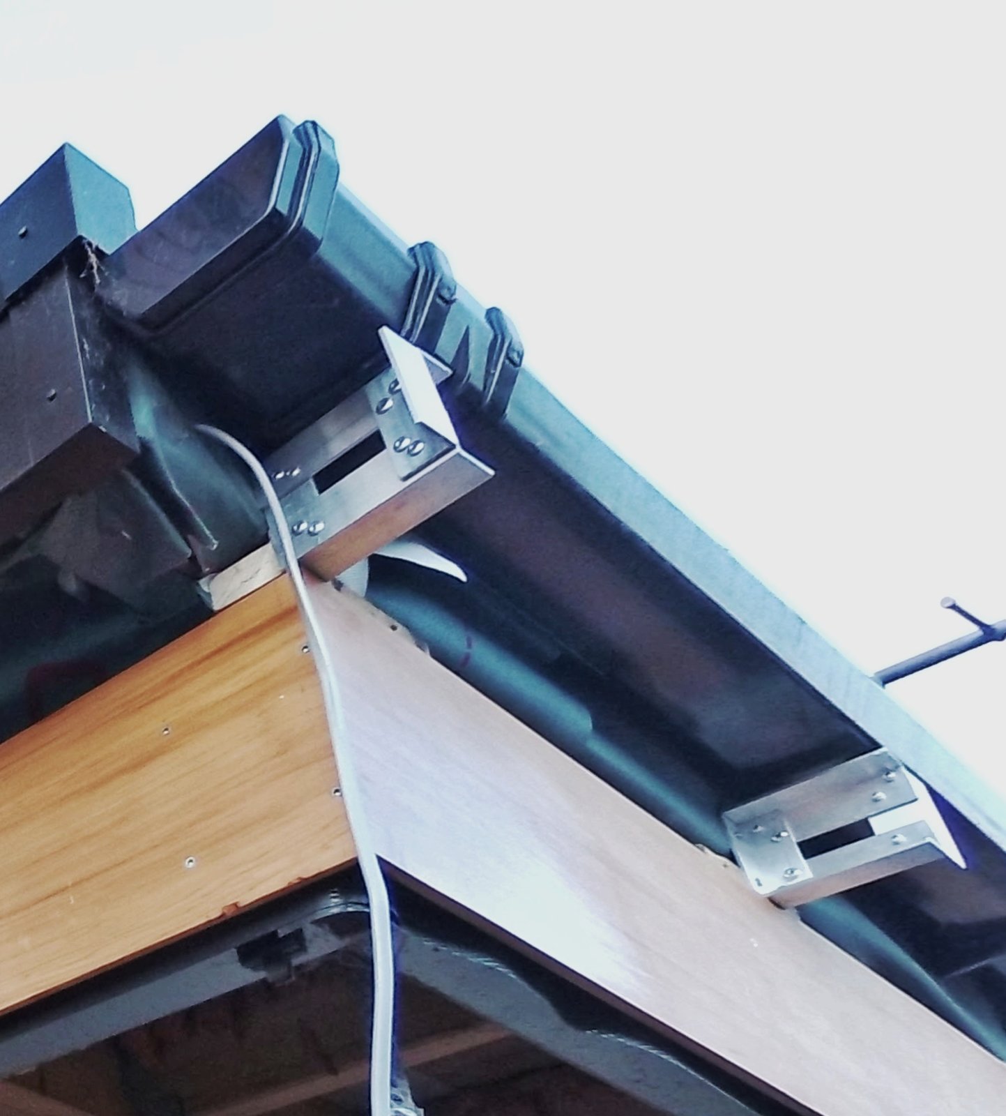

Ok, ignore the gutter lovers and parapet haters, here we go.
In this case, I fitted the brackets below the gutter. There was a timber backing board fixed before the plastic fascia which went up past the gutter.
Nor do they have a catastrophic negative aesthetic effect either. If you are busy gawping at the lack of beauty and architectural splendour of your gutter, then you need get a hobby.
o_O this is all becoming weird.
that's definitely a gutter hater's detail :!:
