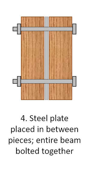

Thanks for your reply. What about it if I made a couple of the joists 'flitch beams' like below

Flitch beams don't really help as the joists between will still have to span the full 5m
