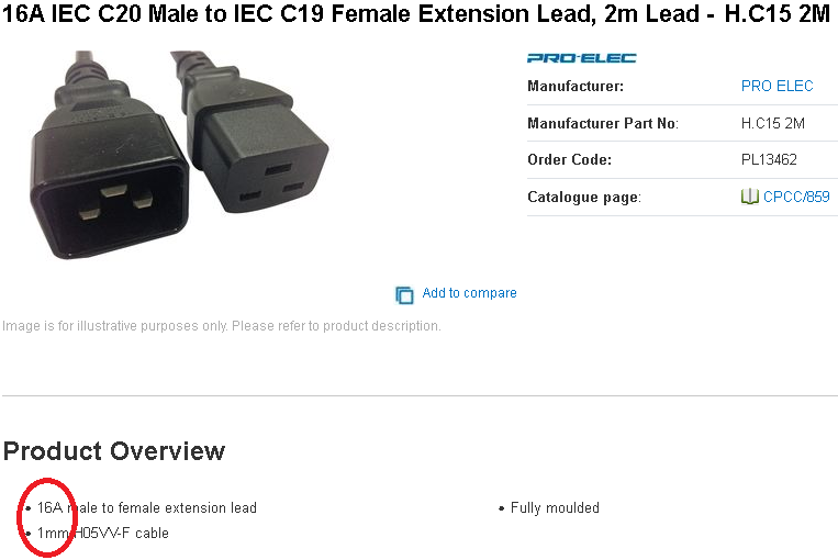

A little while back I purchased some C19/C20 leads rated for 16A for some architectural lighting and was very surprised to find they were only 1.0mm². Discussions with CPC revealed the 'standard' for such leads up to a certain length was 1.0mm² so I installed them and shortly after had to return all of them as the overheating had mishaped the cable.
Due to my complaints they altered the listing:
