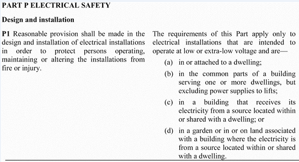

I know you meant "notification" in your original question, but all work must comply with Building Regulation Part P.

EFLI has given you a link to the 'Chapter and Verse' - as you'll see, as I said, very little at all is now notifiable.
