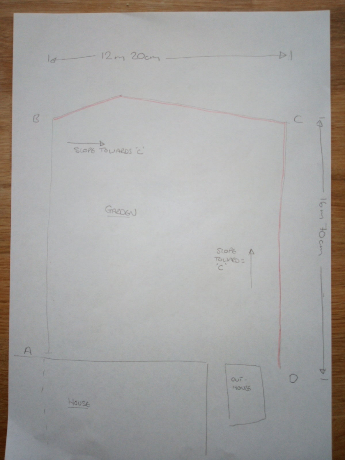

Foundations seem deep enough. 600 would be better than 500 wide, but that may be near enough.
Depending on the length, you may need expansion joints above ground level.

A free-standing boundary wall 200-215 thick is too slender in the absence of substantial piers.

I think maybe I was miss understood when I said I would put extra piers in.
By this comment I meant that I was already going to be using piers to strengthen the wall. However, I was considering putting extra piers to add extra stability and strength.
At no point was the wall going to be constructed with no piers.
I was also of the impression blocks laid flat would overall be weaker.

I've done a very basis sketch which hopefully it's clear to view the red line from points B to C to D are where the wall will be build there is a gentle slope in the garden towards point C and it is this area which will be retaining up to approx 45cm although I will be leveling from point A and hopefully the soil level at point C should be lower than stated.
I've not put any indication of pier or expansion gap location as I will take further advice from everyone and see what will produce the best layout from that advice.
With regard to wall construction and without going into over kill what are you guys thinking if a double skinned block wall with piers is to "slender"?
