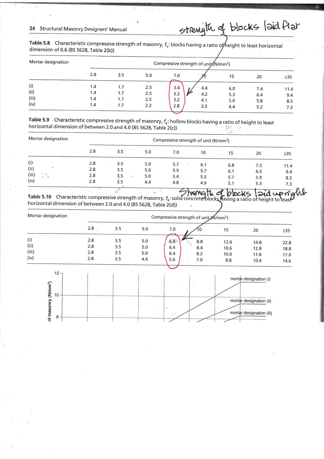

You overlook one point. Technically, a 7N block laid flat has only about 50% of the compressive strength than it would if it was laid upright.
For a heavily-loaded structure, I agree it is structurally best if the blocks are laid upright (fewer mortar joints make for better load-bearing capacity).
But for a retaining wall or free-standing wall, the main force is horizontal (earth in one instance and wind in the other). For these, compresssive strength is not so significant and the blocks are best laid flat. Two 7N blocks laid upright side-by-side are not as good at resisting a horizontal force as 2 or 3 blocks laid flat.

For an equivalent wall thickness, blocks laid upright form a wall approx twice as strong in compression as a wall with blocks laid flat (other things being equal and provided the wall isn't too slender, when different factors come into play).

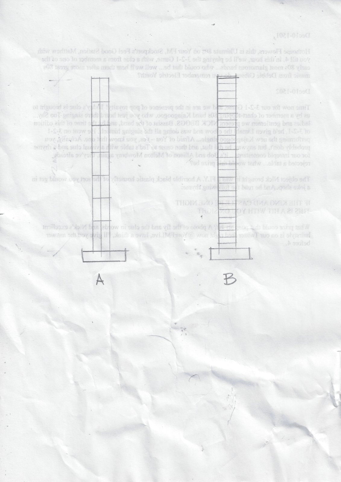

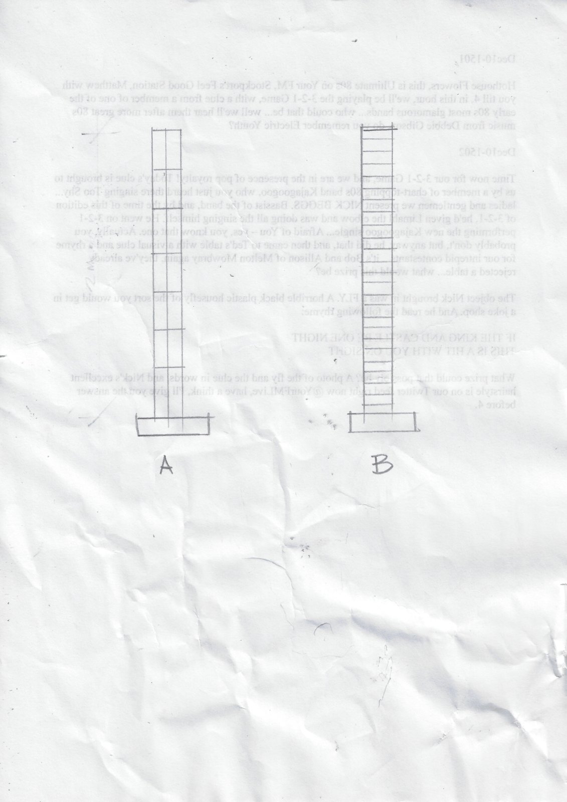

OK, lets look at a few numbers:
Suppose we have two free-standing walls, wall 'A' built the Woody way with blocks laid vertically, and wall 'B' built the proper way with blocks laid flat (both walls are the same thickness, 200mm).
The horizontal wind force applies a bending moment 'M' to the wall. The wall therefore needs to have a moment of resistance ('MR') such that
MR > M.
The MR is proportional to Z, which you will know is the section modulus of the wall.
For any given section, Z = bd²/6.
With the Woody wall, the metal ties will be insufficient to effectively make the two skins as one, so each skin makes a separate contribution to MR.
Therefore for 1m length of Woody wall, the MR = 2 x [1 x 0.1²/6] = 0.003 units,
while for the correct wall, MR = 1 x 0.2²/6 = 0.006 units.
So in terms of resisting wind load, the blocks laid flat are twice as efficient as blocks laid upright QED.
