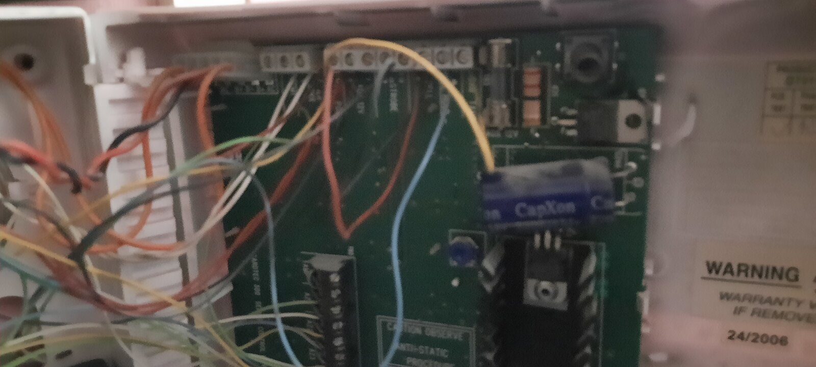

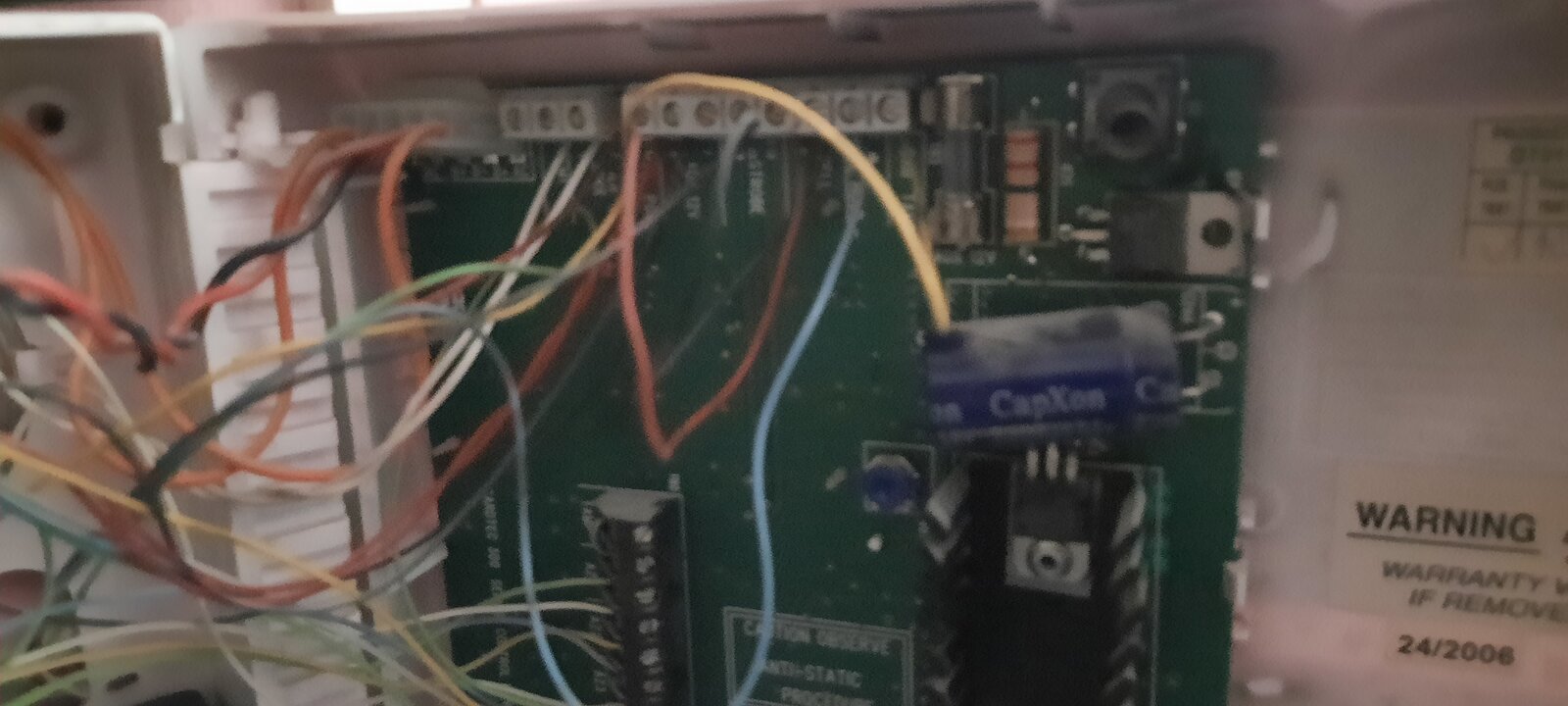

Hi, I recently had my home decorated and the decorator cut threw the inside alarm wire. Someone has managed to.connect the wires inside again abd the outdide bell rings but the light doesn't flash on it but the board won't reset and there is no bleeping coming from the key pad, nor is door bleeper working or the sensors inside.
I have tried to gollow some of the reset answers on here but nithung seems to be working so would be most grateful if anyone can help me!!

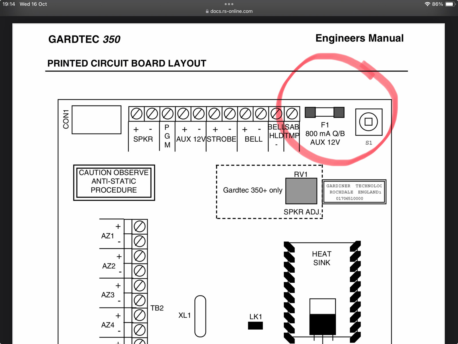

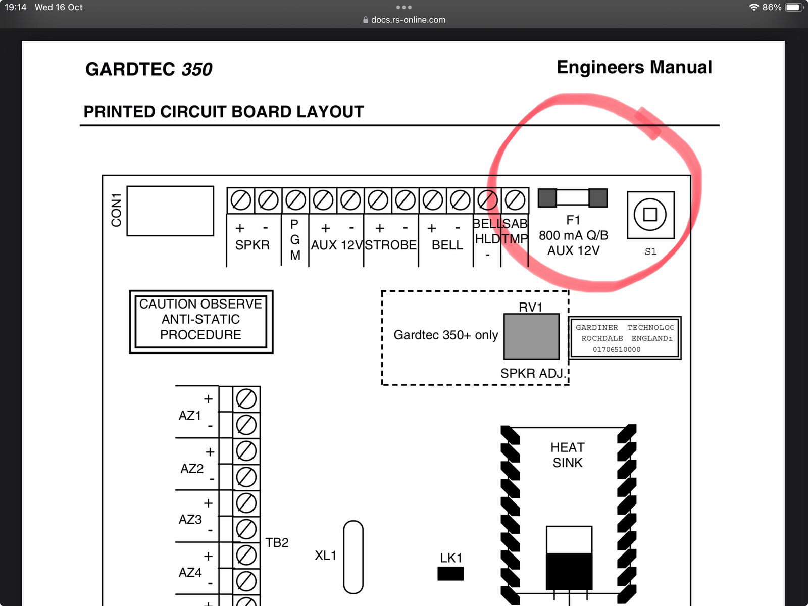

Fuse blown on the alarm pcb …1 amp quick blow would be fine ….

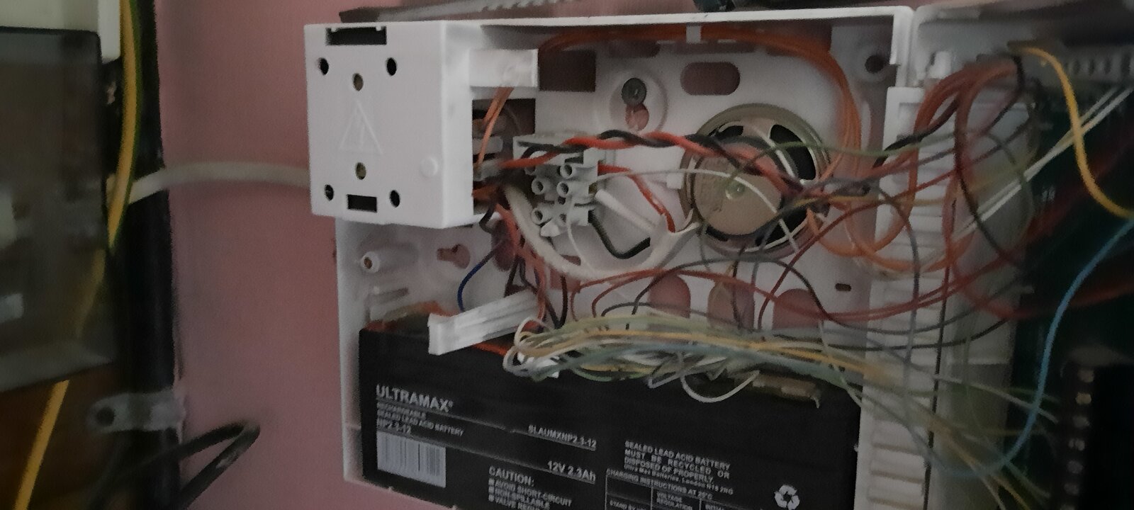

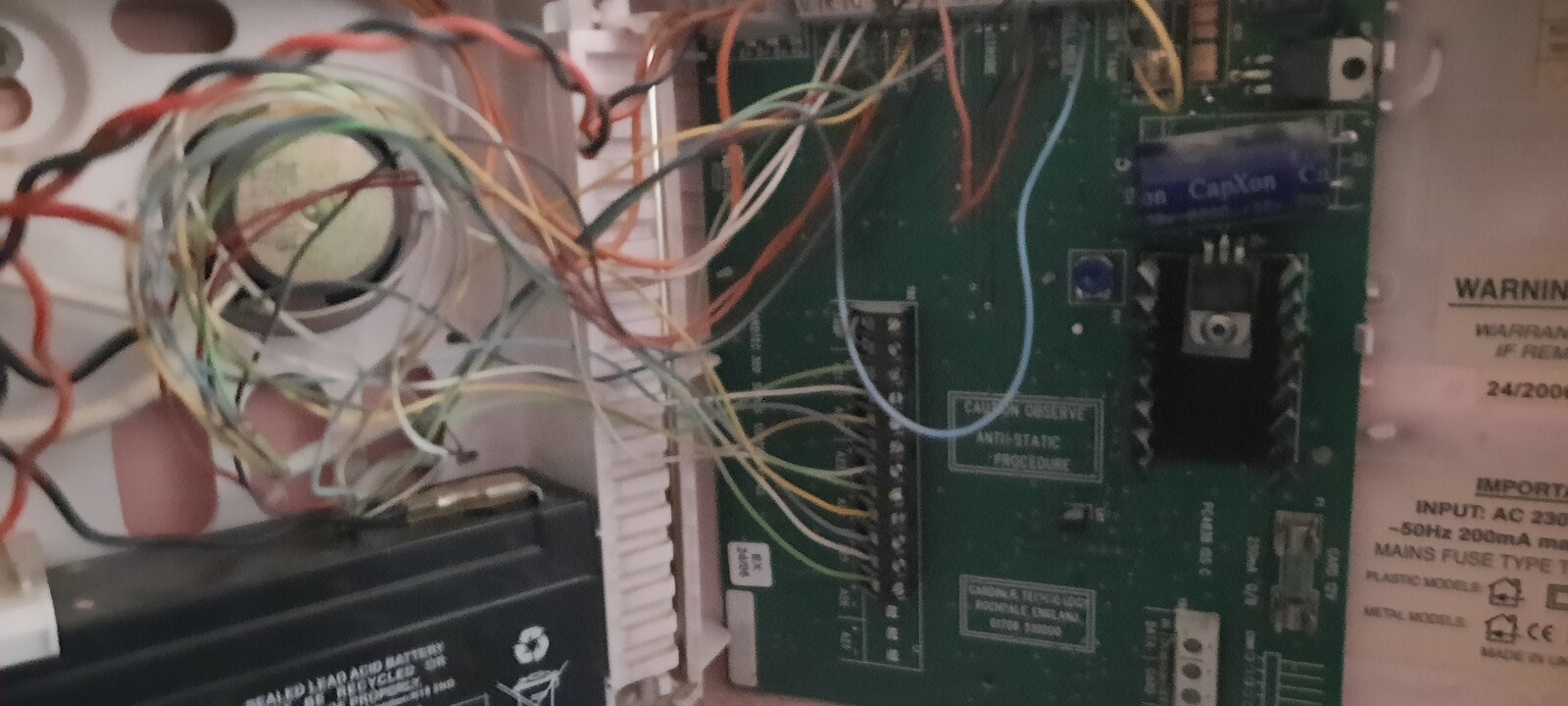

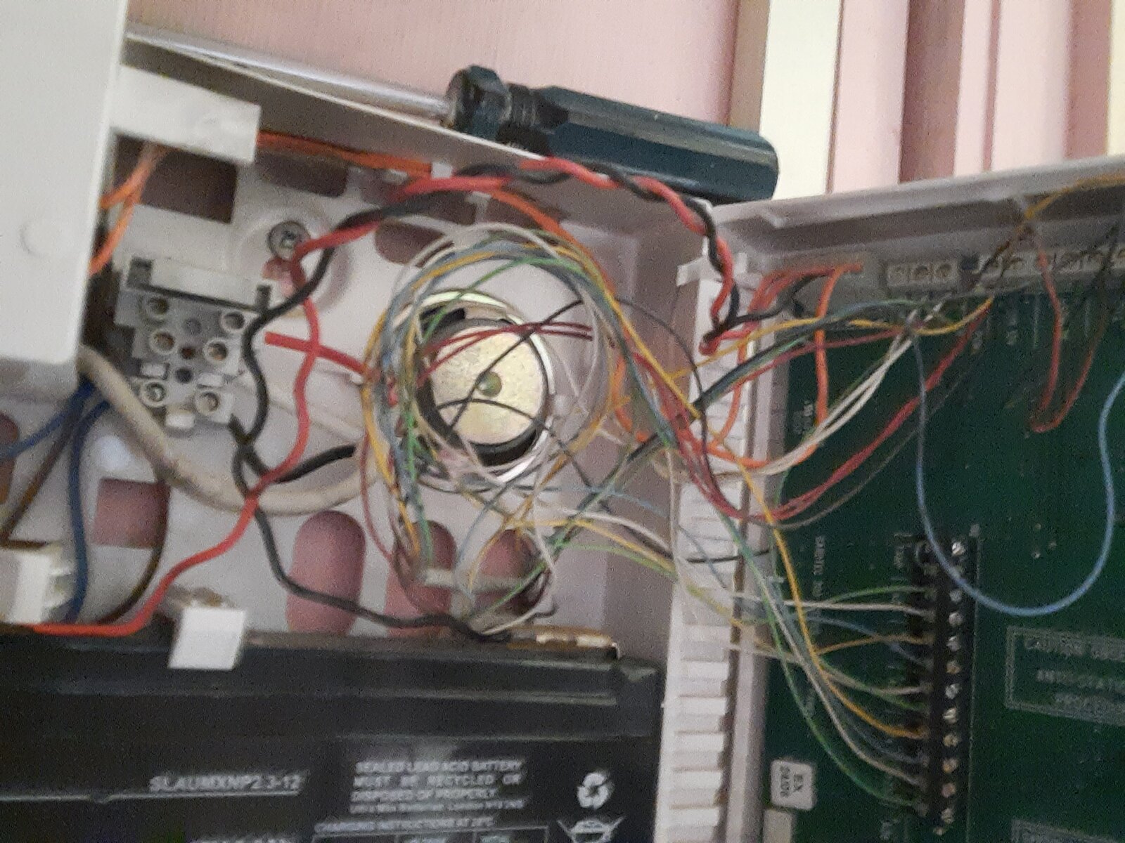

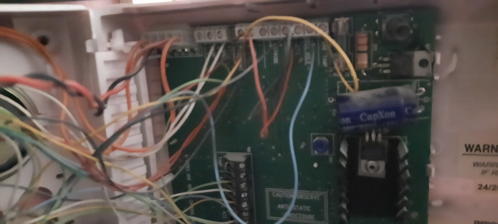

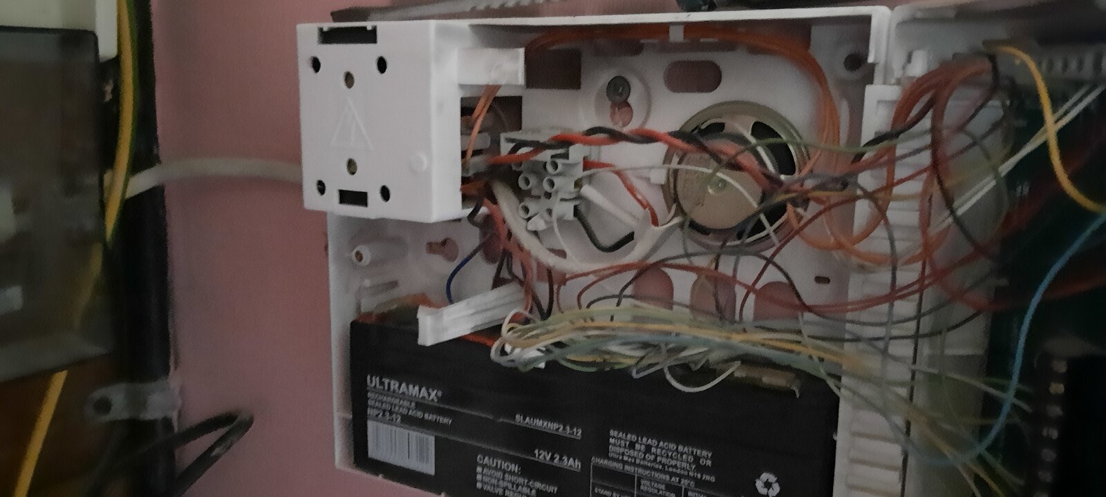

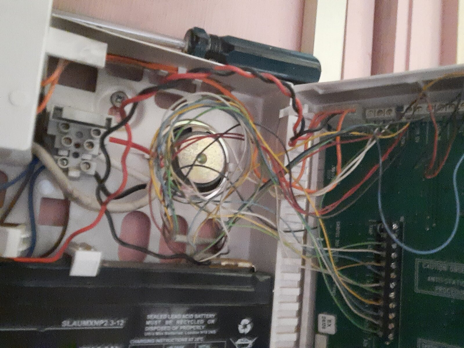

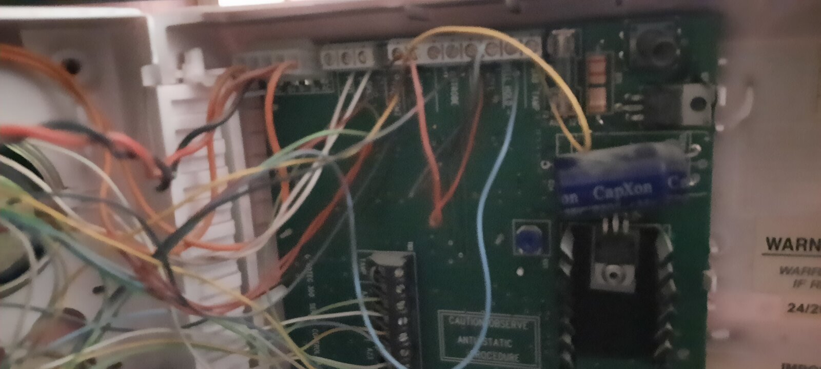

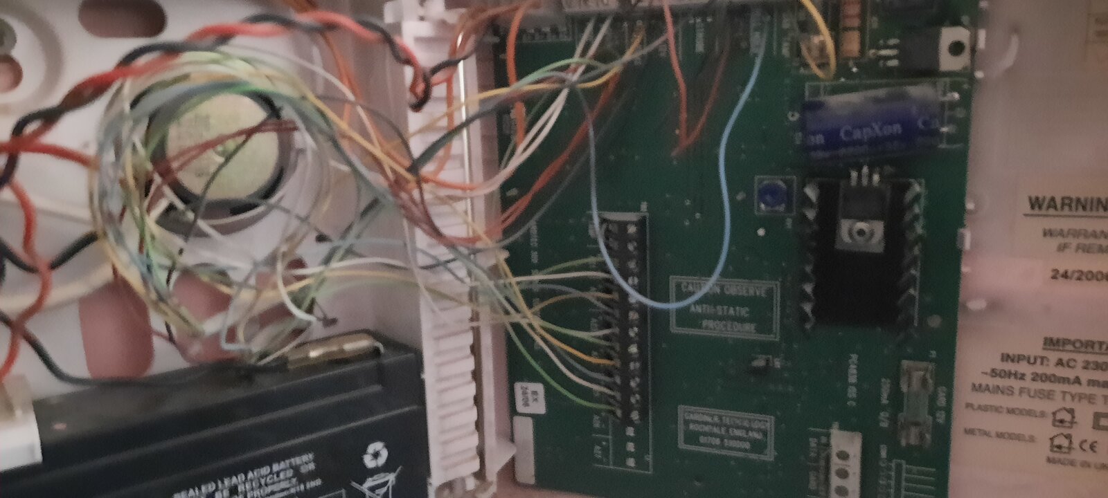

Post pictures of the alarm pcb …..if the sensors don’t light up there’s no 12v power ….so either the cable has not been repaired correctly or the fuse is blown ….this can only be confirmed if you have a multimeter to check the dc voltage …
Please see photos, sorry alarm in a awkward place.

What did you take those pictures with ? A Nokia ? Can’t tell as poor quality but looks like the fuse holder is sprung out at the top

No it was with a samsung and as I ÿsaid it is a awkward place to get a good picture.
