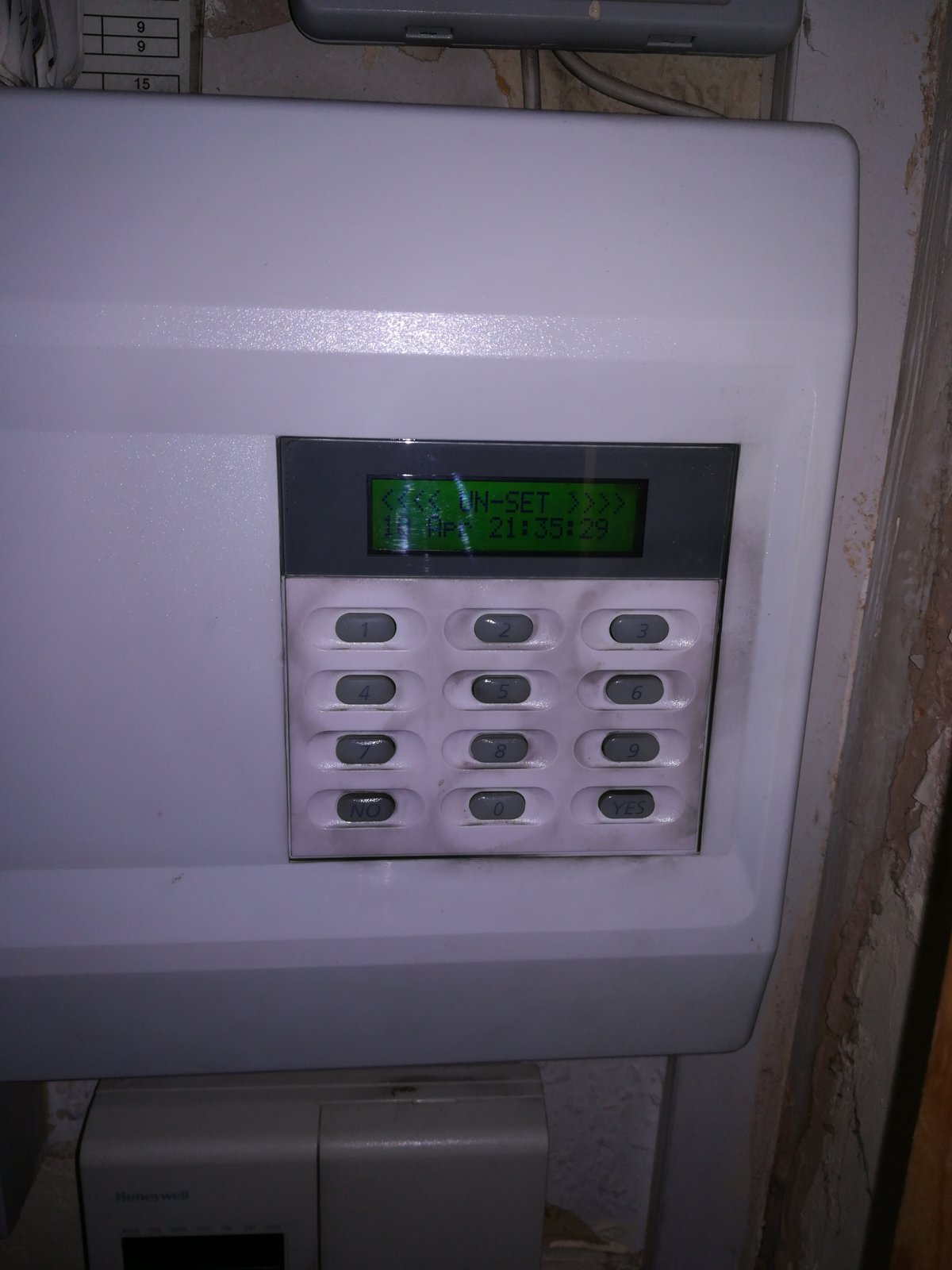

Just to give some more details, I have the master code which allows me to set and unset etc.
the battery was changed about 6 years by a different engineer and now is due for another change.
So I can assume the tamper isn't programmed as per oasistechnical 's message. According to Risco replacement keypads aren't available hence questioning if the green lcd can be made brighter.
Would appreciate if anyone knows if spare stock is available from sources in order to acquire a new pad if that is the only remedy for brightness. Characters and buttons on pad and display are fine.
Giz
Just had a thought could it be the battery which affects the brightness even though the mains are still powering?
How do I post a picture can I do it from a phone
Pictures as requested
Yes agree but not very bright, the flash on the camera flatters the picture
