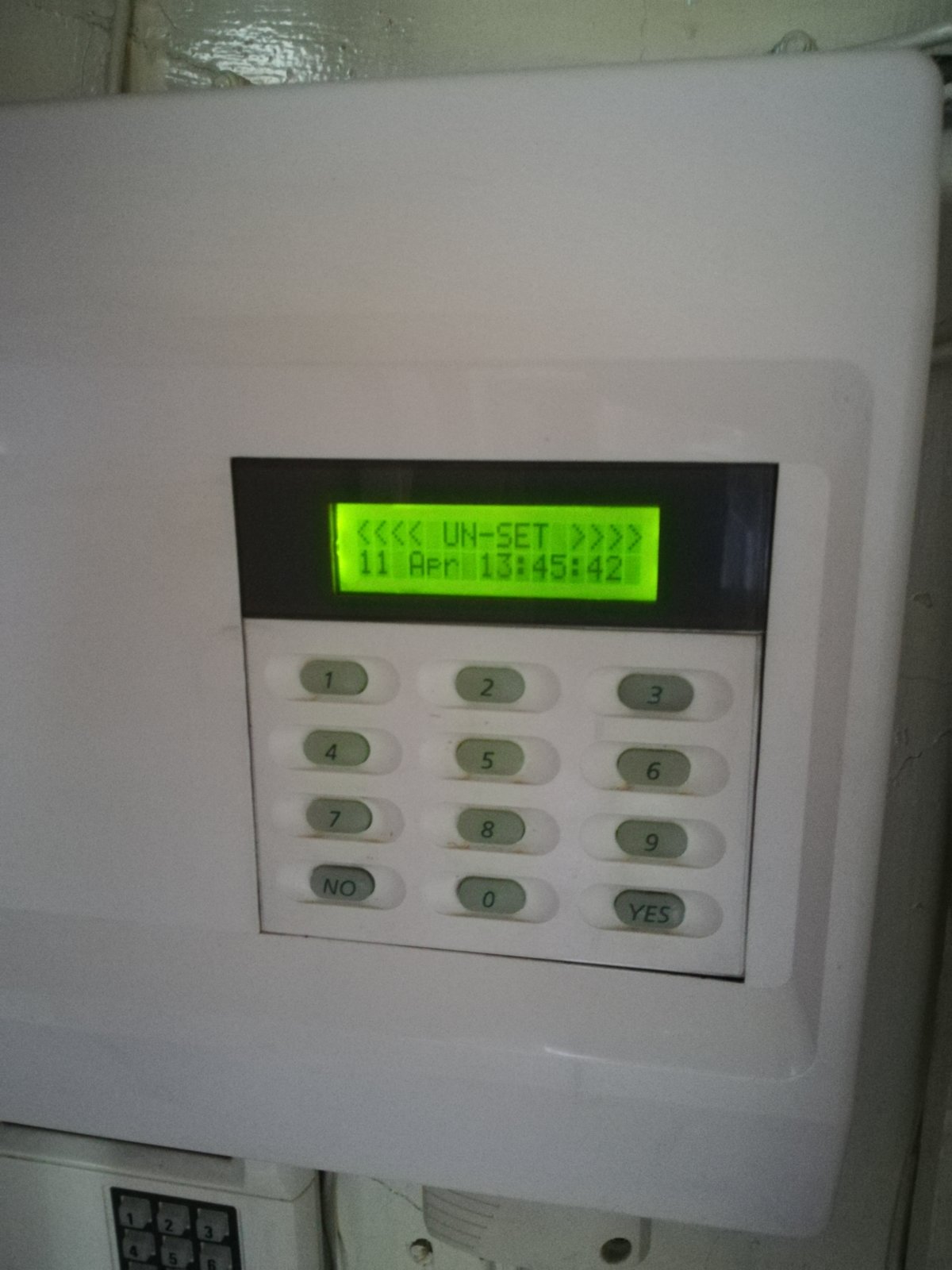

When buttons are pressed the brightness awakens only slightly but is noticeable from its sleeping state.
My bother has the exact same panel albeit not as old and is bright bright
True ill try and post the two differences tomorrow
Same panel brighter brighter lcd

Hi just opened panel to change battery ad its rexacom 12v 3.2Ah battery inside. Is this the correct size?
Depends on the amount of detectors/current draw from the panel when mains is not present. I normally install a 7 amp hour if there is more than 5 PIR's connected in the panel.
Hi I have 7 pirs. Does it matter about the contacts and shocks and sounders?
Just to mention the follwing:
1.The alarm was in the off mode
2. Pulled fuse out to isolate the Ac - No Noise from the panel but a blank screen on display
3. Took panel off no tamper noise either.
4. No siren outside either.
When I isolated the mains Ac the display went blank therefore the battery back up is completely dead - correct?
I'm I correct in thinking that if there was any life in the back up battery the tamper
Would have sounded when I switched the Ac off?
Thsnks
Giz

As Sparky says you need a new panel/bell battery. It should be a 7ah but as its diy a 3.2ah will do if you can't get the bigger battery in.
To test the bell take out the hold off wire from the panel and bell should ring but you have had full power of and no sound so the bell battery is low.
What about replacing the bell for a new unit? For around £30 you could have a new fancy backlight bell on your house.
