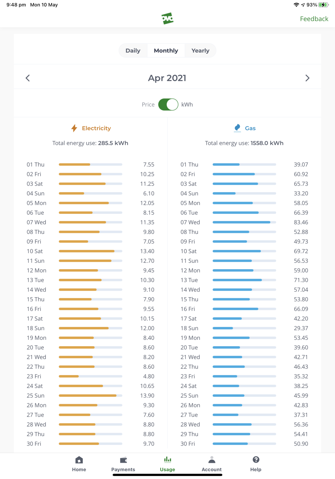

This was ours for April. 3 bed house, just two of us living here, electric oven, gas hob, gas water and heating.
