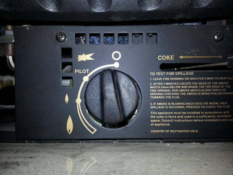

This is probably a bit of an odd query and googling hasn't helped so hopefully you guys can!
We moved in to this house 6 years ago and there was already in situ a inset gas fire with fake coals.
We had a service arrangement with British Gas and then Npower for boiler and fire.
Each year they would come and service the fire and boiler etc. Before Christmas after several poor shows on their part in relation to our boiler we got an independent engineer in he fixed the problem straight away and economically too so we cancelled the service contract.
Now our fire service is due we rang the independent guy and asked him to do it, he has stated that unless we have the manual he wont service it because of the arrangement of the coals. At first this sounded mad to me but a bit of googling shows he is on the ball. The problem is we have no manual and there is no visible makers mark or serial number etc with which to ID the fire and thus I can not obtain a manual.
I have added an image of the fire in case someone can visually id it.

Could be Portway/Verine.The clue being the holes. also they had paper badges which peel off!!
Take another pic,this time of the controls after removing the fret.

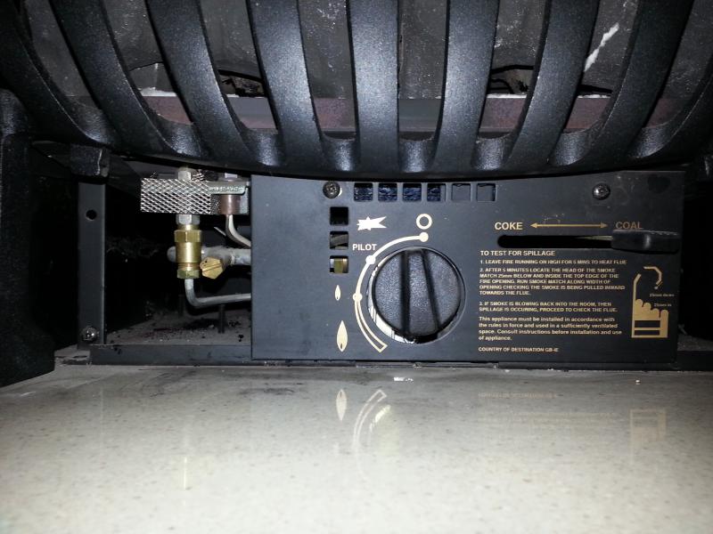

Can you post a pic of the full area behind the fret? It isn't Portway/Verine. Some one may recognise it more easily with a full view. What does all the writing say? I assume there is spillage testing instructions, but there may be a clue in there.
