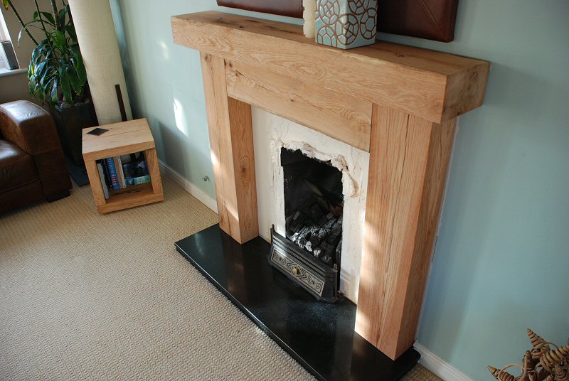

New build house. Simple open gas fire with a chimney in the lounge.
We've just ripped out the default wood-and-cast-iron fire surround and replaced it with a lovely handmade-to-measure solid oak one. A picture speaks a thousand words:
The new surround is loosely mounted to the wall at the moment and I've painted the wall cream simply to cover the exposed rendering and concrete behind the old surround while we decide what to do next. My plan is to use brick slips. So far so good.

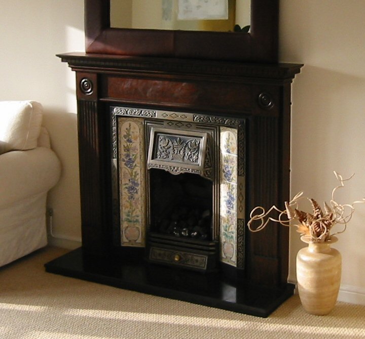

The cast iron fire surround had a hood above the fire that presumably helped to direct combustion gases up the chimney:
Is such a hood important to the fire's safety and operation or would brick slips set flat against the wall be OK? As you can see in the first photo, the fire sticks out an inch or so into the room, although the flames themselves are all behind the level of the face of the wall. I could create a hood of sorts using vertically-mounted slips angled out into the room but is this necessary?

I think you need to get an RGI in who is qualified to work on gas fires and take his advice. The fire was probably made for the old fire surround and, as such, may not be suitable for your new arrangement.
BTW has the chrome restrictor elbow to the left of the fire been plugged when you disconnected the fire?
The hood and the fire are all part of the same unit.
Its how it is supplied, Modifying it is not allowed.
The surround,although a really nice piece of wood kind of over shadows the miniscule hearth.
All fires should come with manufacturers instructions stating the minimum and maximum dimensions for the fireplace opening.Before your fire is installed your Corgi/gas safe engineer should have carried out a smoke test on the chimney and after installation a spillage test.
It looks to me as if your fireplace opening is too high.
I hope you get an RGI to advise you and install this,as fires are without doubt the most potentially dangerous gas appliance.
Most people get advise before they modify a gas appliance :rolleyes: What you have done is illegal and dangerous fella. If you attempt to light the fire or even re-instate the gas supply it would be deemed to be illegal and very dangerous to you and your family. You can't disassemble gas fires for decorative reasons. If you want to kill yourself and your family keep doing what you are doing :eek:
