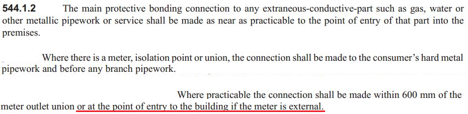

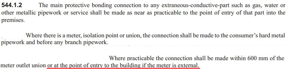

Then he shouldn't. Gas regs say they should advise the customer to seek the advice of a competent person.Mr GSR will state that the bonding HAS TO BE at the meter
It would be if there is none visible, it can't be a pass. Nevertheless, the advice should still be the same.I've seen "fail" reports from GSR's for the annual gas safe reports.
No, you are misreading it.What the regs say in the 18th Ed AMD 2
So I was correct
As I said you are misreading it.
