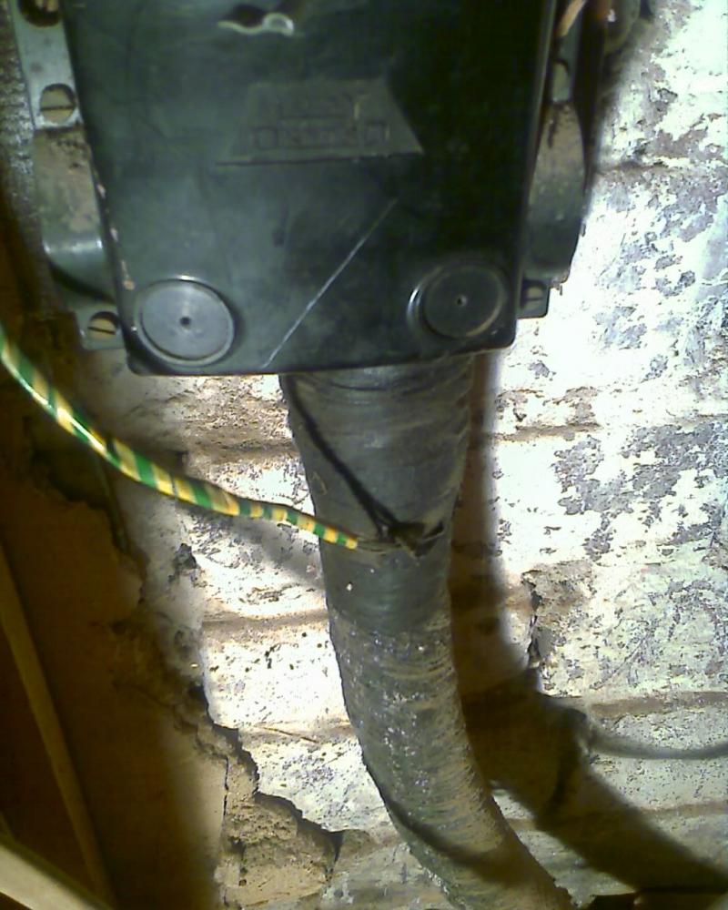

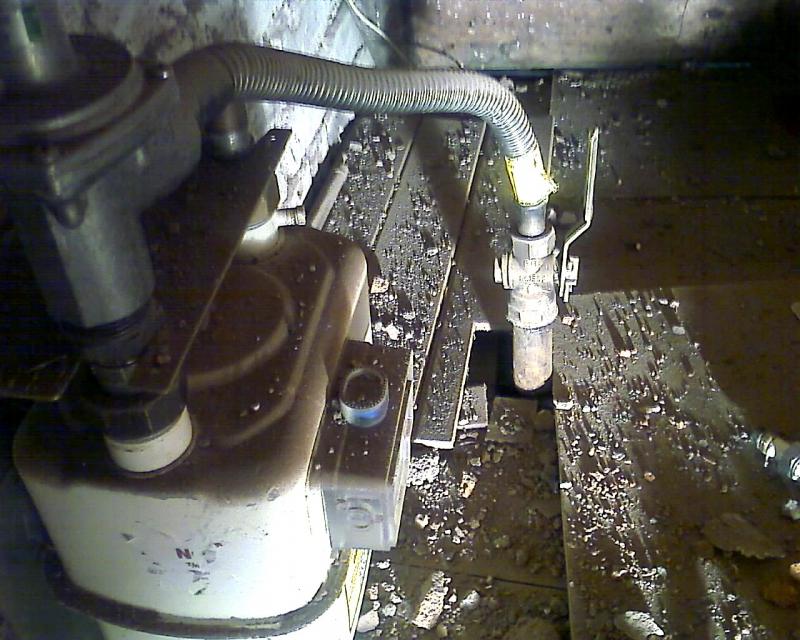

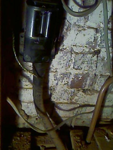

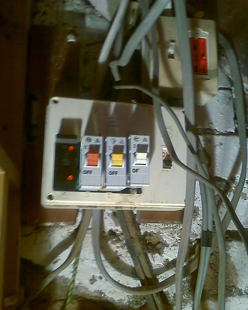

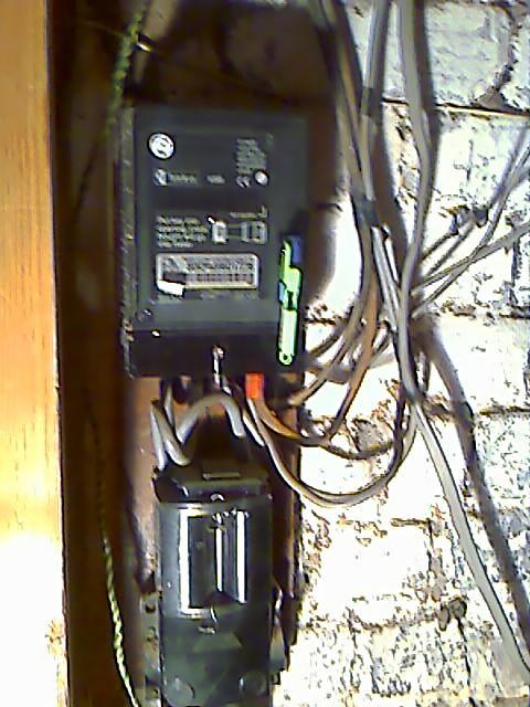

OK, thanks for looking. Here are the images
First photo shows main steel gas feed - its fairly loose and looks to run under the floor boards (not buried, at least not until front door). Meter is against wall, main feed about 2ft out. No bond at all on my side.
About 3ft left & down the wall, the other photos show elec cut-out with REC seals intack and {detail} ropey main bond lead - looks to be two lengths of 6-core steel wire braided together with G/Y pvc tape. Guess at 6mm2 in total. This goes into the CU. Main REC cable just runs under the floorboards!!!!!!!, but must go underground before front door. Meter & CU are directly above cut-out as normal. There is another 30Amp fuse unit just over CU, still got tails back to meter, presumably an old water heater connection.

Unfortunatly, I can see nothing wrong with the DNO supply, and if they were to inspect it they would no doubt say the same. You might get a new cutout and earth if you are lucky.
All the problems appear to be on the consumers side of the installation.
The cable is a paper insulated lead cable, and the DNO will not move it.
The would cut it underground outside the property, and connect a new piece of cable to it to supply the new cutout position.

I have no idea about gas.

Also, it looks like you currently have no RCD protection so I would use a plug in RCD when using power tools during your renovation. Better safe than sorry ;)
Have got most flooring up and new studded walls installed minus last few sheets of plasterboard to allow for rewire routing. Should be an ideal job for a sparks & his mate. The CUs got some RCDs, but I use plug-in RCDs in anycase.
