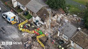

We see reports of metal theft being blamed for explosions like this
where someone has stolen the copper used to earth the PEN, but if the current did not go through the gas pipe to start with, it would still not have happened.
