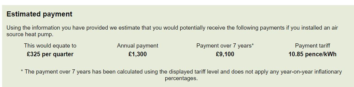

he link I inserted was for Domestic Renewable Heat Incentive and the part that would apply to air source heating is for heat pumps because that is the type of heating we are talking about and it is that link that is applicable if you wish to install Air Source Heating and wish to claim a grant which is payable quarterly for 7 years. I'm not sure what "wmfor" relates to or why "Green deal blah blah" is relevant to this thread?

I just did. I'm not on a low income, I had Air Source Heating installed, followed all the steps on the link I sent you and I now get a little under £800 per year paid direct into my bank account by the Government.
I made some assumptions about your property so I went through the calculator and assumed 3 bedrooms, medium loft insulation and solid walls.....
