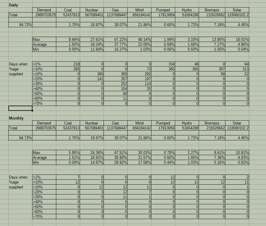

Well, RL intervened and so I have only just done that! I did figures for all the sources for 2020 as that was hardly any more work.
I have omitted the interconnectors (five external & two internal) and the small Other category. Notes on definitions can be found at https://gridwatch.org.uk/download.php by hovering over the white buttons.
Adding up coal, gas & biomass, 47% was from CO2 emitting sources, all of which I would lump together as fossil fuels. Biomass is regarded as renewable but I don't think that is really true. If it is wood waste from quick growing trees that are planted for timber. toilet paper, etc then it is pretty close to being renewable. However (certainly AFAIUI) the wood chip at Drax is from mature (100 year old?) trees and they will not be replaced much if at all before the end of this century.
NB, I suggested that biomass supplies >6% and the actual figure is >7%.

Wind delivers c. 30% of the nameplate figure, so a maximum wind figure of 48% means there is enough wind installed to theoretically supply well over 100% of our needs. If it was supplying it would be used as wind is given priority, but it only supplied more than 40% on 20 days whereas gas did that on 154 days. Gas supplied more than 50%/60% on 68/11 days, whereas the figures for wind are 0 & 0.

Looking through the figures, there are plenty of instances of wind supplying less than 10% for 3, 4, 5, 6 or more days on the trot. Compared to an average of 22%, you are talking about having available (from storage) a minimum of 100% of a days consumption (15% shortfall times 7 = 105%) which (if I have calculated this correctly) is c. 850 GWh. And that is available, no storage is close to 100% efficient so quite a bit more than 850GWh needs to be put in.
