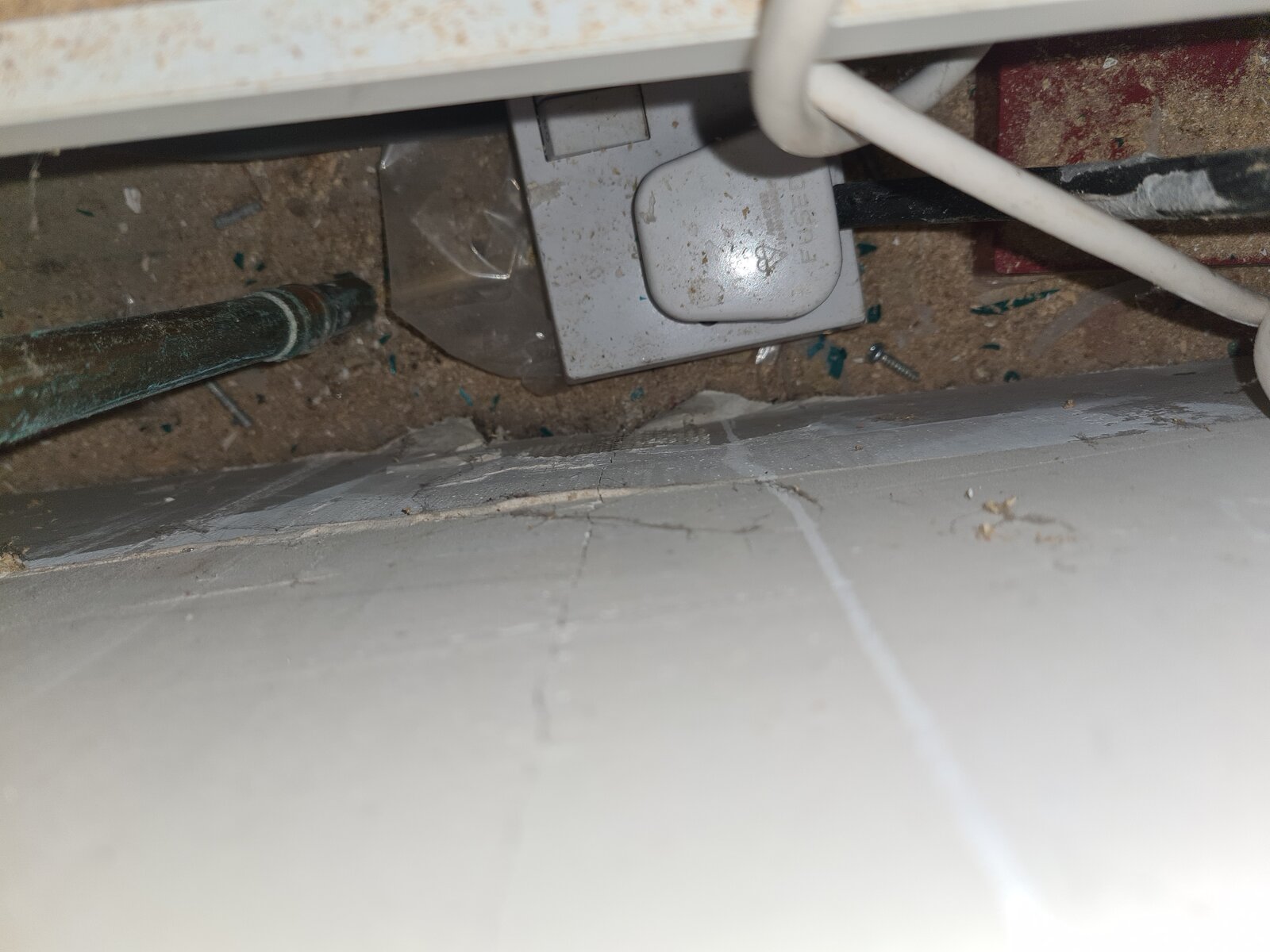

Gas pipe obstructing new oven

I can't get a full picture but it looks like this, with the oven and hob plugged into it.

I have 565 mm from the electrical point to the front of unit, including the lip at the front. I assume there needs to be a minimum space between that and the oven therefore the whole lot is going to have to move.

You'll learn the ropes Donna if you pop in again. General discussion doesn't take any prisoners, it's a post more aligned to be put in plumbing and central heating.
Bosch. depth 548mm
Hotpoint. depth 551mm
Hoover. depth 567mm
Haaden. depth 550mm
Zanussi. depth 568mm
Lamona. 567mm
Depth of standard kitchen unit. (not including door) 575mm (howdens)
Depth of 15mm pipe mounted on bracket = 25-30 mm
Depth of oven is to the front surface of the oven, and will align flush with the doors or end panels either side so deduct 20mm from the oven dimensions to find the clearance.
There is a cutout at the top rear of the oven to allow for a gas feed to a hob, this may vary between manufacturers.
All the above manufacturers will fit comfortably if the pipe clip is below the oven and above the cutout at the top of the oven.
If you're looking for an oven that will fit pipework likely done 20 years ago, in units that may or may have not have some shaved off the back to allow for wall curvage, you are, in a word, f****d.
There is always the possibility of moving the vertical pipe to the right and bringing it up behind the adjacent cupboard and then drilling a hole through the cupboard for the hob connection. This will give you full depth for your oven, (which will be fed from a flexible gas pipe), to allow insertion and removal for servicing. The flexible pipe could be connected to the incoming gas pipe below the base shelf of the oven opening.
Speak to a Gas Safe engineer before deciding to change to an electric hob. If it's gas you really want then it's often better to bite the bullet and maybe pay a little extra to get it. Compromising can be a very expensive mistake.
flexible gas pipe really !!!!! do you know why there is rules why flexible pipes are not used when there is an oven below them
There's some confusion here perhaps. Electric oven, gas hob, right? So no rubber hoses unless the hob manufacturer allows it.
If your worktop's 600mm, perhaps you have the cupboards set back eating your clearance at the back?
If needs must then you could get the valve moved down the pipe and turned to the right below the level of the oven base, and then carry on with the gas pipe up the corner. I had a couple done in something like 10mm, ie a skinnier pipe, from the valve, which made it quicker to do as well.
Shouldn't take more than an hour anyway.
