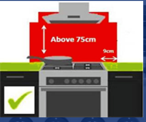

So he has took a call from the fitters arranged at POS and they have said no wallpaper behind the cooker (it has a lid). I plan to go round there and put a stainless steel splash back behind the cooker in the heat zone, but does the heat zone extend to below the worktop, ie behind the oven cavity. They phoned today to change the install date and he asked the question and they said yes (but not sure if the understood the question)
is this correct? Have checked the MI and it is not that clear. If it is represented by the dotted line then looks like some work required.
this looks much clearer but is more a general guidance which I understand the MI overrides?
