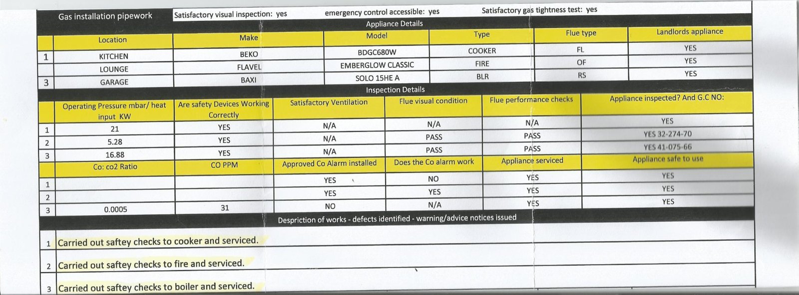

Can you scan in a copy of the cert?
The 16.88 and 5.28 is exactly the same as the previous safety record. The 21 is n/a on the previous.The 0.0005 was 0.0004 on previous and the 31 is 37 on previous.
If what you are saying is accurate, the cert is a fabrication.
I would be especially concerned that the fire has not been checked. The fire needs to be removed, the chimney checked, a smoke pellet lit in the builders opening, and the smoke observed issuing from the chimney pot/terminal. He should also check the flue through it entire route, especially if it is a precast flue.
Some guys doing Landlord inspections insist that they do not need to remove the fire, but I disagree.
