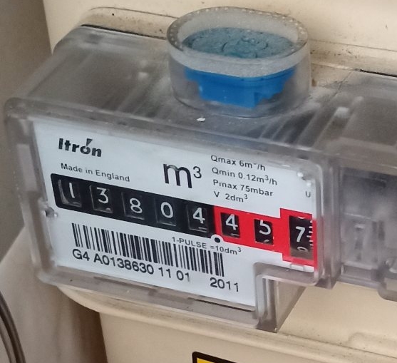

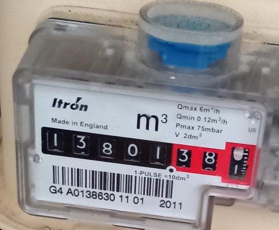

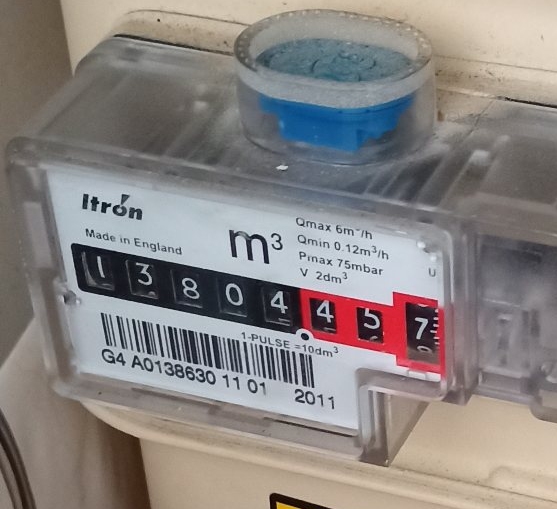

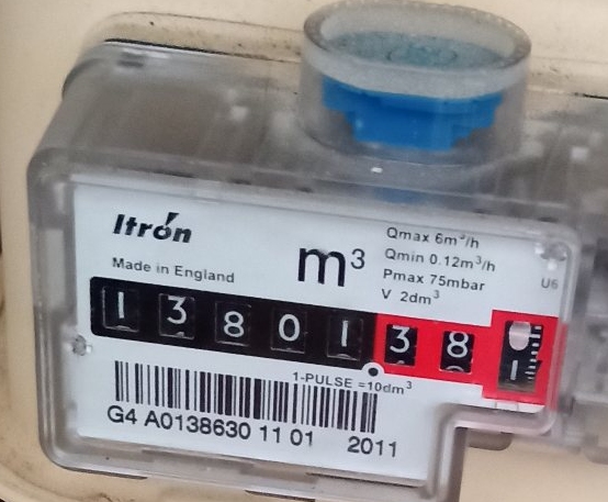

HI O,
Here's the 2x photos.
28-08-24 and 04-09-24

My son took those photos, so today I'm starting to check again.
With only the pilot light, I've read the meter, and I'll check again later, then I'll stop the pilot light and leave it for a day.
C
Not really, a pilot light can use anywhere up to 3 m3 a week, size dependent
Hi,
Interesting!

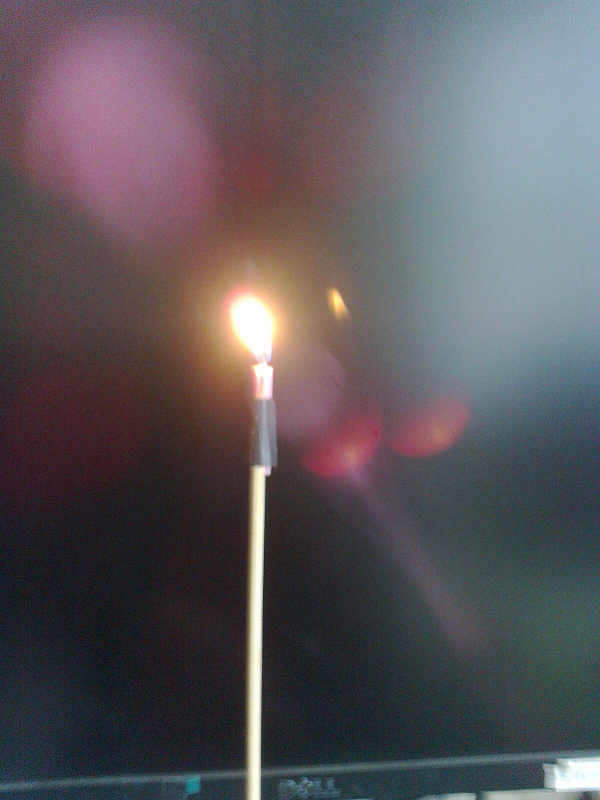

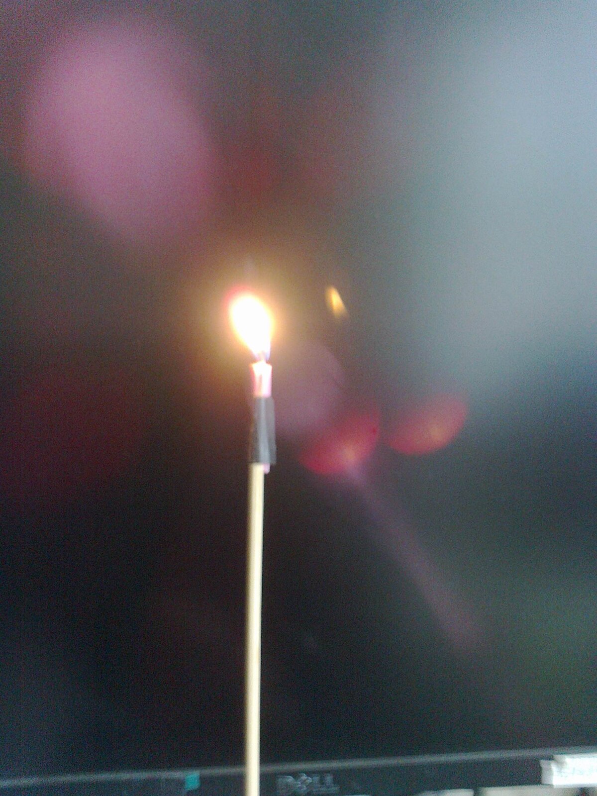

I measured with the pilot light for an hour 0.018/mtr3 XHrs/week 168 =3.024mtr3
I switched off the pilot light for a day and no consumption.
As mentioned pilot lights are a B*****r to light sometimes so I used this:
