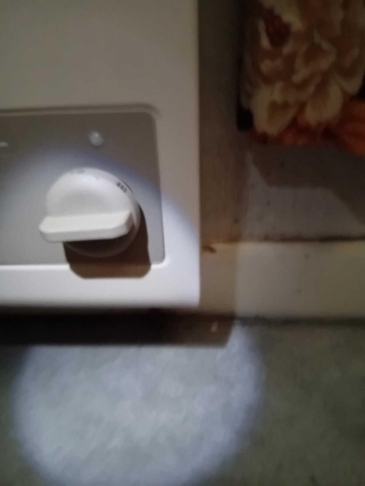

I have a balanced-flue gas wall heater. To light it one has to press the knob in, turn it anticlockwise and hold it as far as possible anticlockwise. After a few seconds it is supposed to stay lit when one lets go. But mine does not stay lit, except when the gas engineer lights it. Then he has to hold the knob for less than a second. It works for him but not for me. I would rather not call the engineer every time I want to light the heater. Is there an explanation for this behaviour, apart from supernatural?
Are you sure you have to turn it fully anti clockwise and hold its usually just PUSH knob in quarter turn click and hold IN for 10/20 seconds
"At the OFF position push in the control knob as far as possible and still pushing in *slowly* turn anti-clockwise to the ignition position to light the burner. Turning the control knob slowly allows gas to enter the burner ready for ignition. Keep the knob pushed in for 20 seconds and the burner should remain alight." Actually, the gas explodes blowing the flame out. Turning the knob more quickly, the result depends on who is doing it.
The heater is in a dark corner so the pic is of poor quality.

Resuming - I blew at the pilot light through a straw and this cured the problem once, but not again. Probably I need to get the cover off the heater somehow in order to clean the pilot light, or anything else. There are cross-head screws holding it on but they face the wall with less than 1 cm between them and the wall. Is there a tool for turning screws positioned like this? Obviously an ordinary screwdriver is out of the question.
