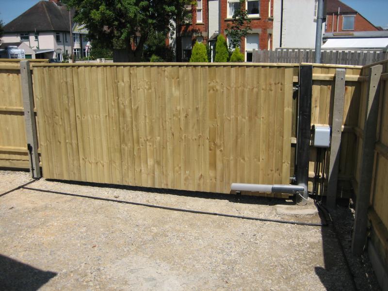

Hi guys,
Had some close board fencing fitted, along with a very big gate. It's about 4 meters long, with a metal frame, and metal post, now over boarded both sides with close board fencing.
The guy who made the gate, fitted the post, it's about 2 foot under ground, with two barrow loads of concrete.

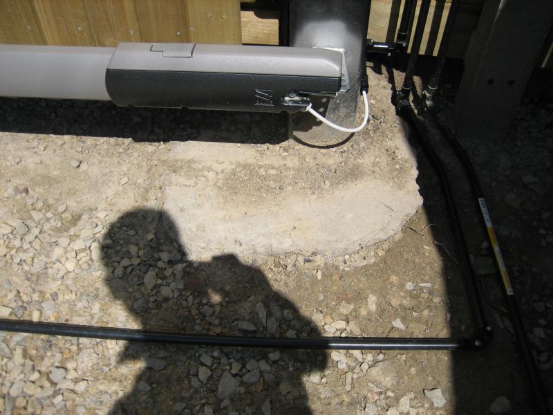

The problem is, due to the weight, the post is now leaning, and the gate scrapes on the ground.
The guy has been back to have a look, and is trying to think of a plan, he's talking about hammering a metal post to the right, taking the gate off, straitening the post up, pouring in some very running cement, and trying to stick it back to where it should be, any other ideas or comments greatly appreciated, thanks, Paul

2 foot underground is not a great deal, and it does look like the hole dug for the post was not very wide - so the post does not have a lot to restrain it in the ground. Difficult to remedy now
What about strapping the top of the post back to that adjacent concrete fence post?
The only other options are to lighten the gate or support the end with a wheel

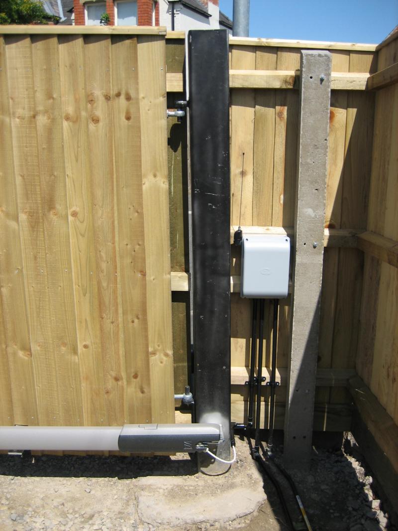

The bloke who made it came up with two ideas
1. as I described above, but also try and brace to the next fence post, but worried it might brake that too.
2. Dig out the concrete with a braker, make the base bigger, lots more concrete,

The best option is get digging. A large enough hole for about a 1/2 cubic meter of 35 newton concrete with all the old concrete removed.
2' into the ground is fine imo.
And also spike it or u bar it with re bar for the finished concrete drive to grab hold off. You'll have no problems after that.

With that close boarded gate I would want to see that post deeper.
Also that gate motor will not like the wind generated on the gate. This is also one of your problems.
TBH a hydraulic opener should have been used with secondary locking.
Fence post will break if you try to link to it. Dig deeper and more concrete round to post, consider a steel post.
