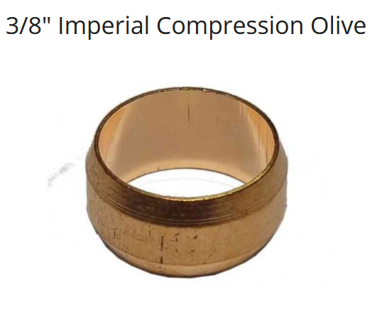

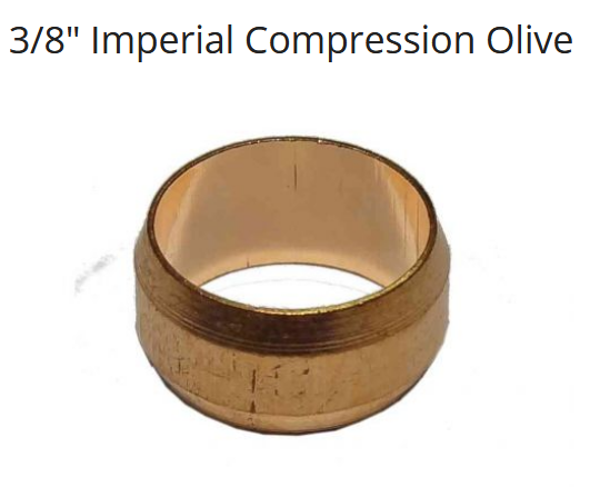

    That olive would suit a pipe with actual OD 3/8", and would (obvs) need the appropriate valve. But if it's 3/8" as valve per #7 I'd have thought it would be 3/8" nominal size. If it's in Italy as the OP's flag it's likely to be an old one. I thought 3/8" actual OD pipe was only in USA.
    OP - can you tell us the pipe OD?

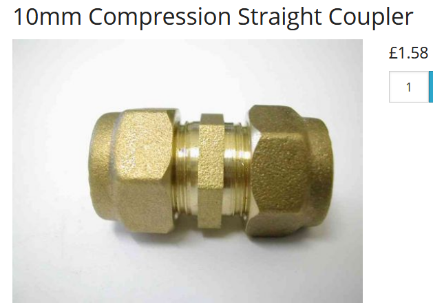

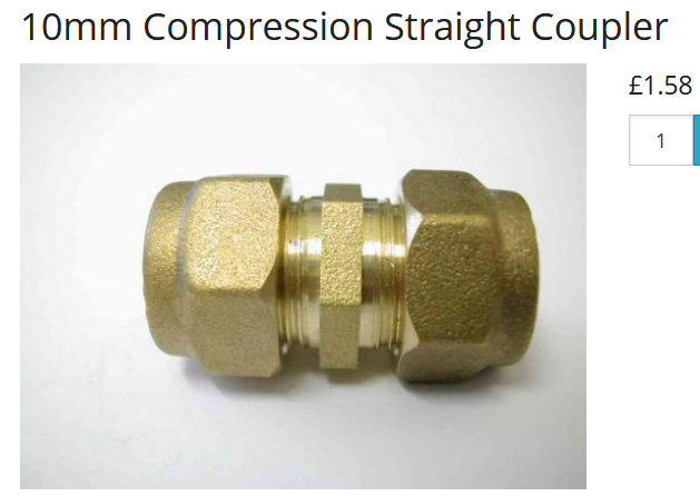

    He has an old 3/8"OD 'compression' gate valve, quite common on old oil lines,
    the 3/8" pipe with that olive will work in the 10mm union
