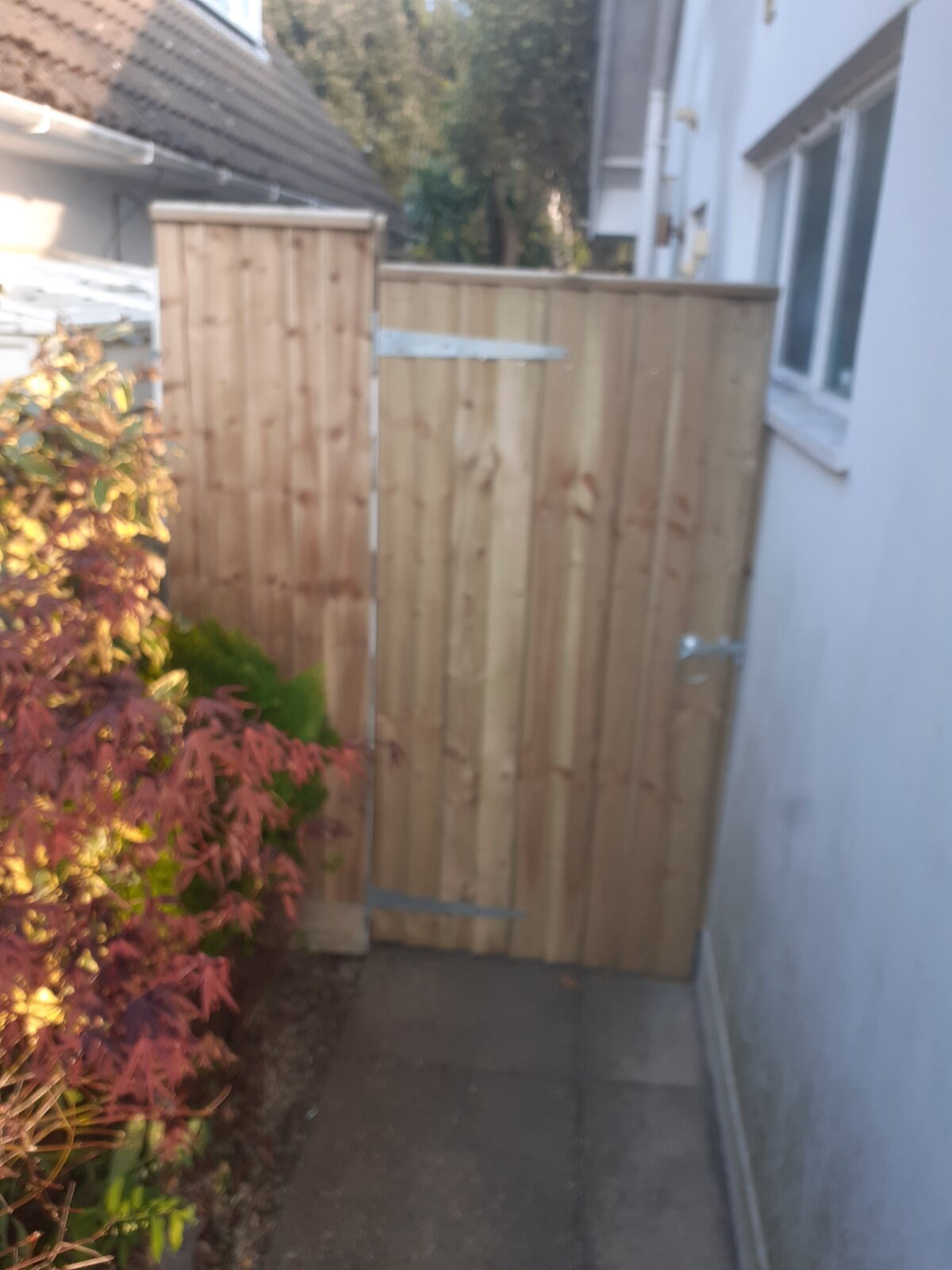

Helped a mate do a gate. Trying to hide the white painted side fence with feathers.

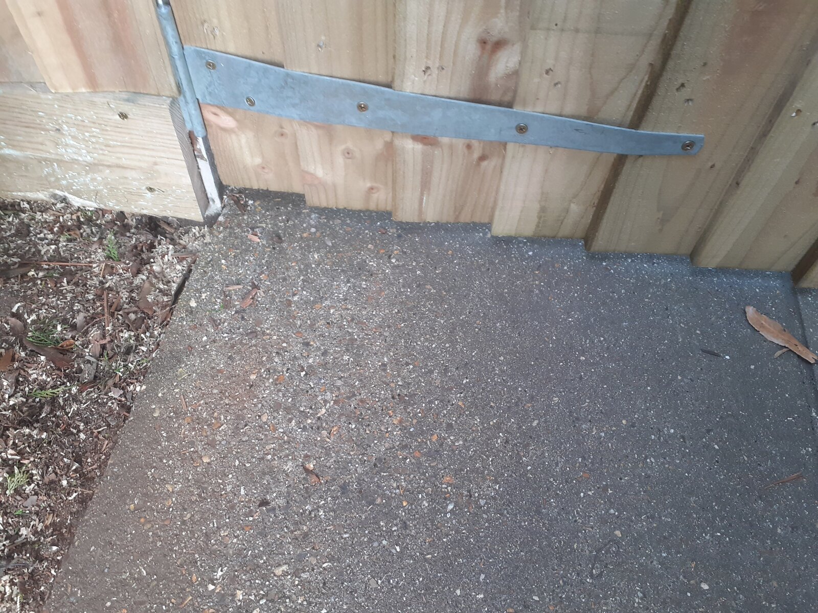

He covered the hinges with feathers on post side,I said better to use a jigsaw and cut around them?

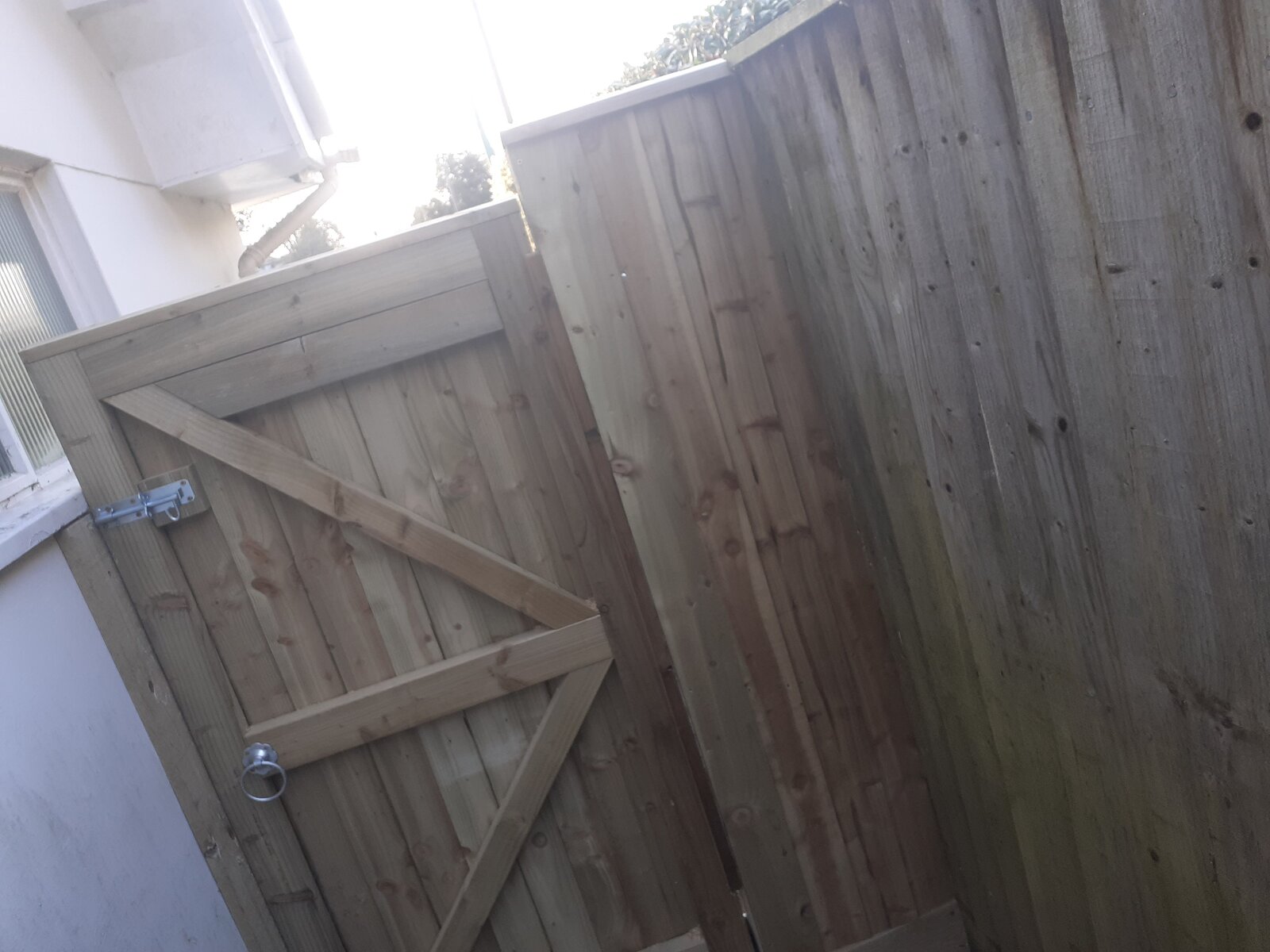

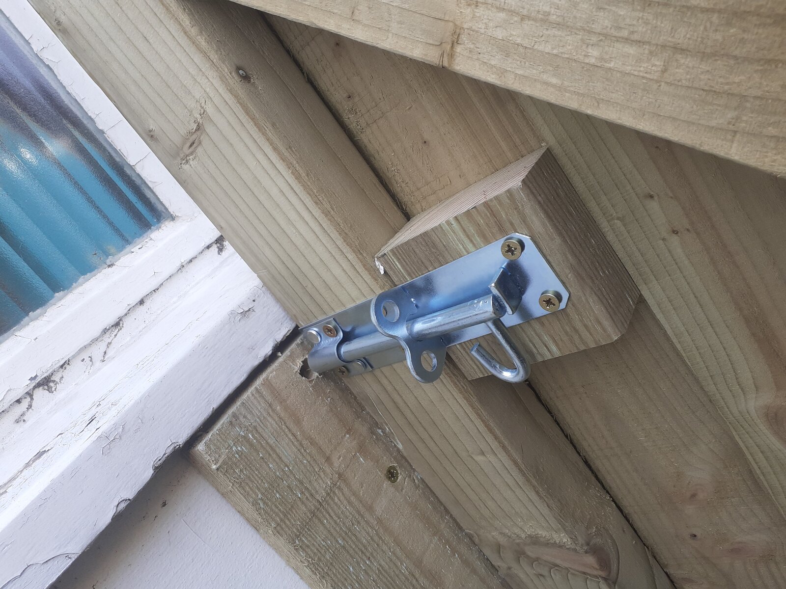

No door stop on latch side (inside).

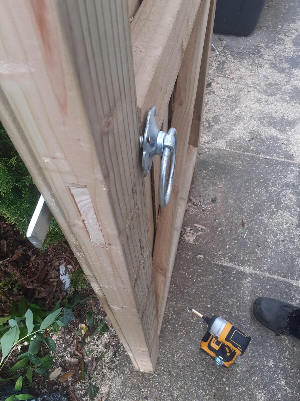

The latch (rose) doesn't move easily so I said drill a wider hole. The spindle was a few mill too long so he used washers to pack it out.
Ok to put the hinges over feathers?
