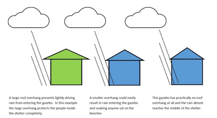

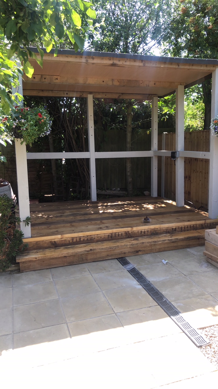

I built a decked area with a gazebo above it. I laid 18mm ply on the top with felt which lips over the edges by about 6". Unfortunately I didn't calculate the overhang right. As a result of this, driving rain gets into the gazebo from all sides. Currently it's soaking wet. I'm a bit gutted about it and I'm worried the timber will start rotting too.
I cannot figure out the best way to create an overhang on the existing set up (see pic). I want to be able to add to the existing structure rather than rip up the entire roof and re-lay.
My only feasible idea would be to have a 12" deep run of ply all around the edge of the roof at an angle (with felt) -- water would run off the existing roof onto this and then away from the structure. It would also stop rain driving into it.
Can anybody help restore some sanity with a few ideas? This is too mentally taxing for a Sunday sat indoors... I've been sat in the kitchen for nearly an hour thinking of ideas :confused:
Looks well built and solid - nice work.
I hope I've understood your issue correctly, but from your photo the gazebo looks to be pretty well protected by trees on three sides, and maximum exposure to rainfall is from the front. Even if you increased your overhang by a foot or two (which can start to look daft) it still wont remain bone dry underneath when wind gets involved. I'd suggest you ensure the timber is looked after with weatherproof treatment every couple of years and accept that a gazebo is only really intended to protect from the sun and light rain showers
Thanks for the comment. It's constructed of 9" x 2" joists with the same joists used as floorboards too. The posts are made from 5" x 4" timber -- all of it being reclaimed from builder's yards. The joists were coated in boiled linseed oil by me and they are 1' off the ground so we don't get rats/mice nesting. The floorboards are coated in oil/stain.
I don't know if the overhang needs to be as much as 2', I just know I need it increasing from current but I don't know the best method! I was down there today and watched the rain coming in from all sides defeating the purpose of having a roof. There are only trees to the rear and (less so) to the right. There are no trees at the front and left and if I'm honest the trees that are there only offer light protection as most are not evergreen.
The ground can flood underneath because everything rests on concrete blocks -- I just want to make sure the rain doesn't get in as it is now.

On my drive in this morning I was wondering about overlaying corrugated sheets. Looks expensive but will allow an overhang and will last longer than felt anyway.
Or if not, would a fascia board around the perimeter of the top stop rain getting in?
Anything you can add to the sides to deflect the driven rain, will help, but the only way to keep it completely dry, is to completely surround it roof to floor.
Decided I'm just going to put the equivalent of a porch canopy on the front. At least this stops rain getting in the most exposed opening.

I managed to get my hands on some reclaimed 5mm clear acrylic. I'll put a canopy around the sides and back and then a ply/felt one at the front all supported by timber supports. Slightly at an angle to divert rain away.
There is guttering at the back (I made the roof slope 4" over the span and the run off does go into this), but the driving rain still gets in. If I cut the acrylic to a depth of 16" it means there will be a substantial overhang which I hope will stop most of the rain.
