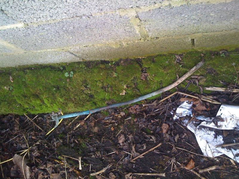

Well I know it's been a while, but I was back at the farm today.
I have checked out the generator a bit more closely. It seems there is a N-E link fitted at the generator, and the frame is bonded.
There is also a 16.0mm² from the generator to an earth stake.
Now there is the problem.
This is the earth stake
