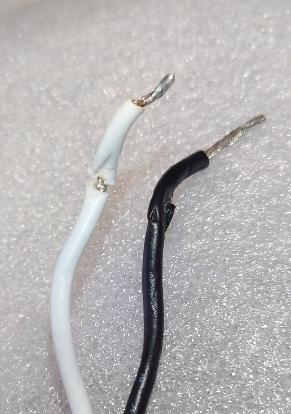

I brought a custom made lamp from Germany and I asked if it could be fitted with a UK plug. The lamp arrived today with said plug and just out of interest I decided to take a look inside. There are only 2 wires (Black and White). The Black was connected to neutral and White to Live. The wiring wasnt very neat, so I decided to take it apart. I went back to the seller to ask which cable is which. He's come back and said Black is Live and White is neutral (opposite to the way it was done). He also said he tested it and it worked fine.
Is there a way to check which is the true Live and neutral? I'm just wondering if the whole lamp maybe wired backwards. Would the lamp work when tested if wired backwards? (and just be unsafe). My concern is the seller may have just fitted a UK plug without really understanding them. It came with a 13A fuse too. I want to keep the lamp but I need it to be safe.

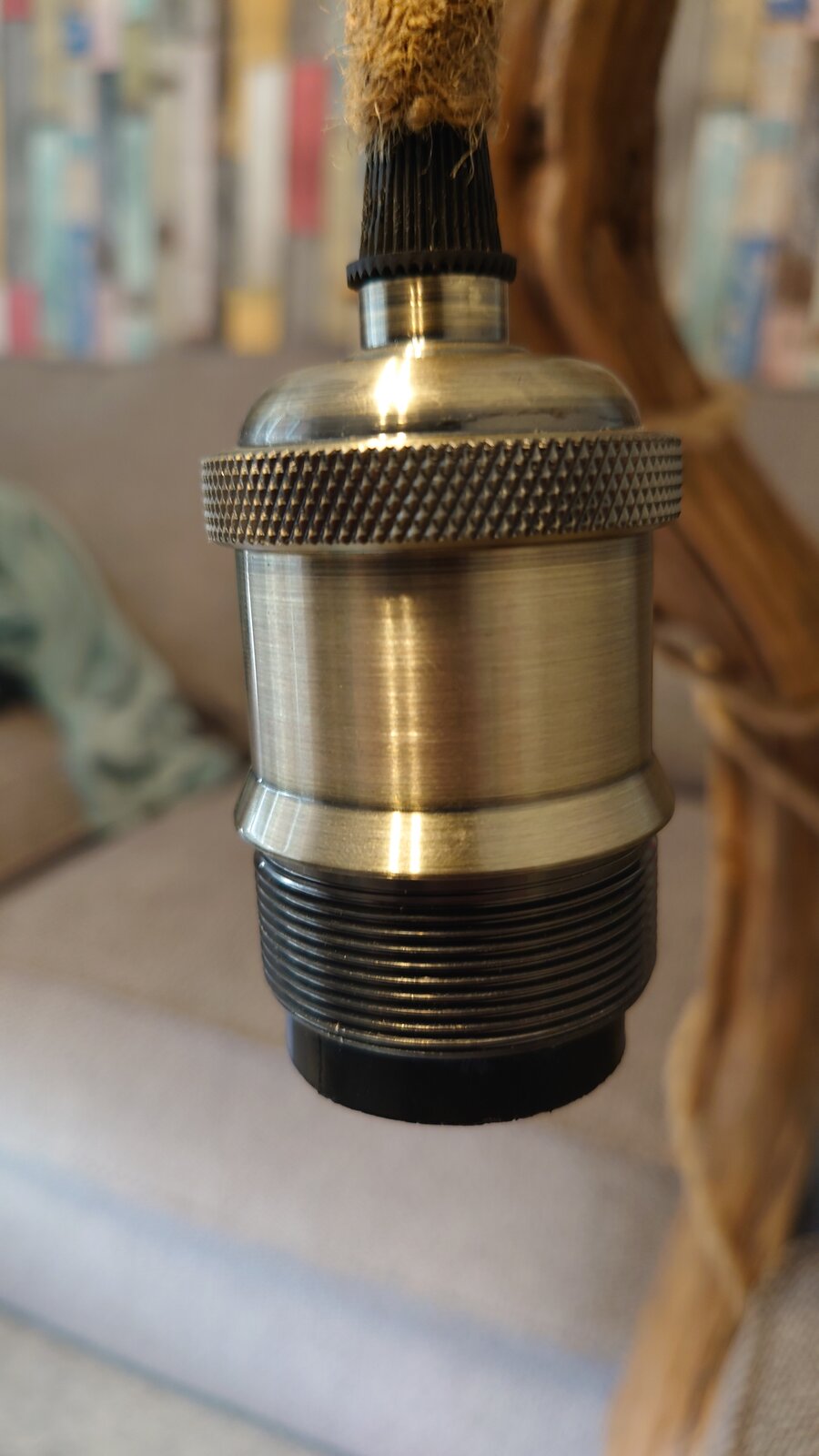

What type of lampholders does the light have?
Are there any markings on the lampholders, switches or other parts to indicate the voltage it's designed for?

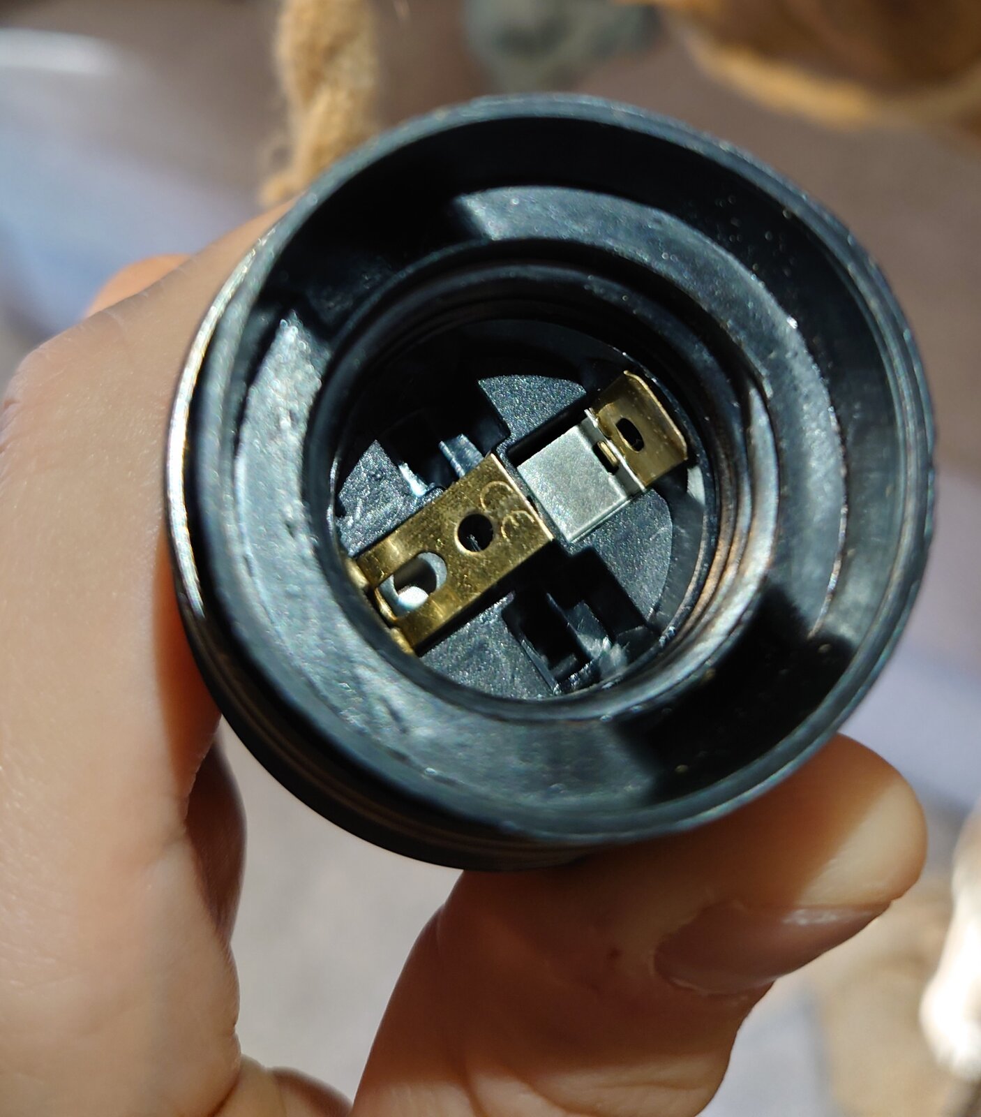

Is the lamp CE marked?
The is no marks on the outside. There is a CE mark on the inside.
That CE mark is just for the lampholder, not the product as a whole.
Possible that they are Class II lampholders and don't require an earth connection, but the product as a whole might require an earth connection, all depends on what it's made of and how it's been constructed.

Neither of you photographs inspires confidence in the manufacturer. a) How is strain relief effected where the cord enters the lamp holder - clearly the fancy 'cloth' braiding will have been removed and b) what did the damage at the ends of the cores
For the vendor to say he tested it and it worked fine simply means the bulb lit when powered up. It certainly doesn't mean it was correctly assembled or safe.
